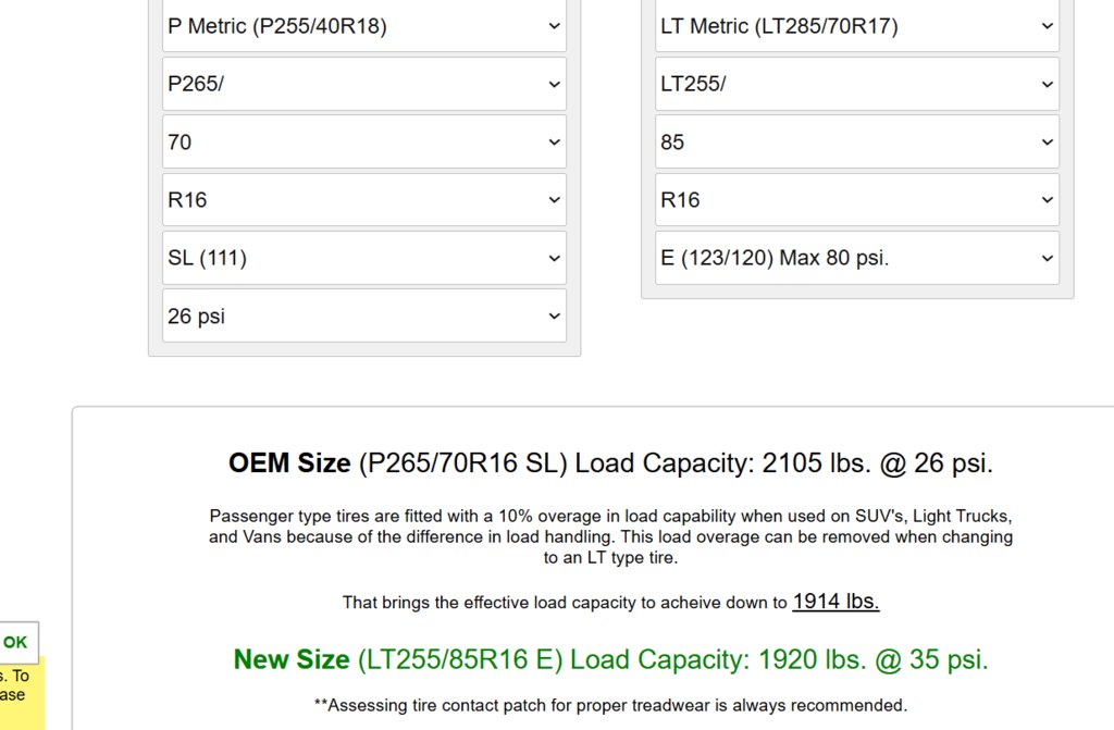

    Use this calculator to help you determine your new pressure. Just plug in your stock tire size and recommend pressure from the door jam and enter your new tire/wheel size:
    Schlappesepple and Area51Runner like this.

    Interesting site. For typical around town I'm at 33 psi.
