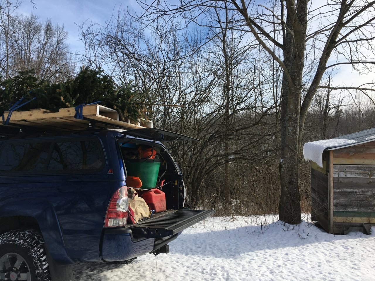

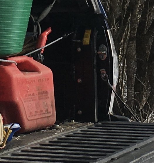

  20. Mar 19, 2021 at 5:59 AM
    #20
    Rexfordian13
    Rexfordian13 Well-Known Member
    Dec 6, 2014
    #143761
    1,561
    J
    Albany/NY Capital District
    2015 TRD Sport DCSB MT
    Another vote for TCs, they are functional and well designed. It’s really just a heavy angle bracket...they’re hard to see here. Three bolts up the side and two across the bottom, you loose a bed d-ring but gain a few extra tie-down points. FA1405DF-851E-4720-9F55-C6D764563006.jpgADC69979-8E05-4FD4-BA05-4198907F0390.jpg
