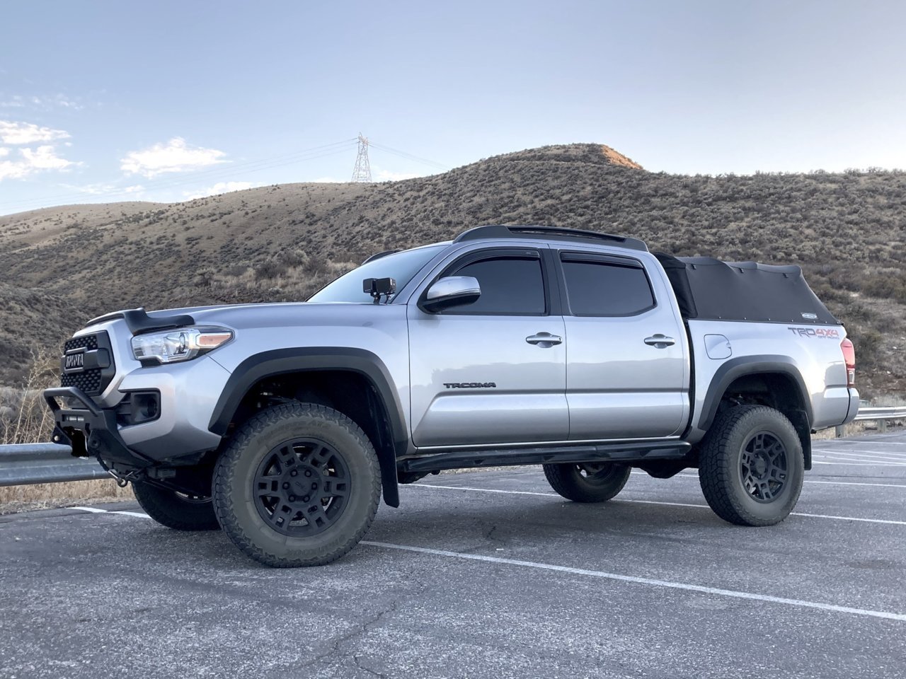

    like this?: A2662764-0B6D-4C9F-82D3-33349BF22E5F.jpg
    4.88’s, I never get below 16.5 even when running fast (over 70mph)

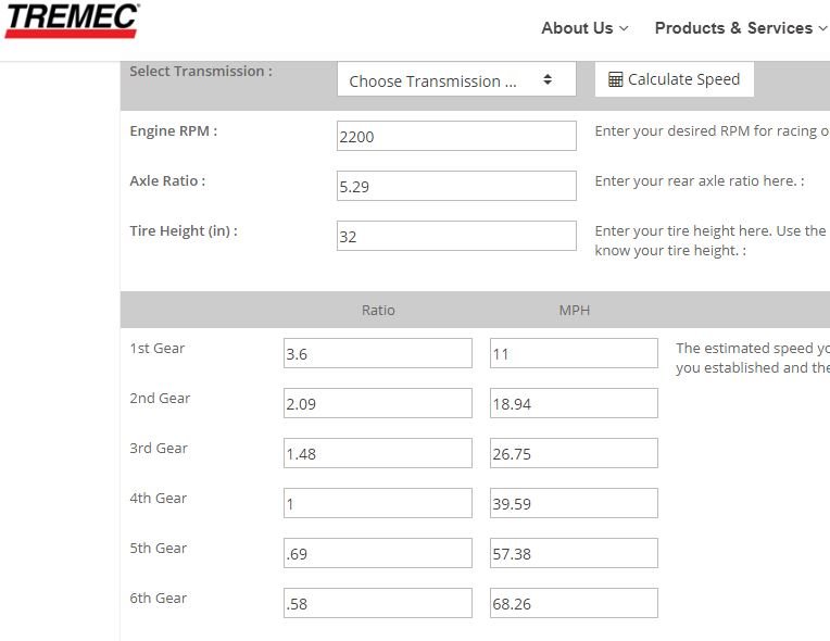

    Someone mentioned that at 75 mph, their truck was doing 2250 rpm with 33's and 4:88's.
    Does anyone have that data for 5:29's and 33's?

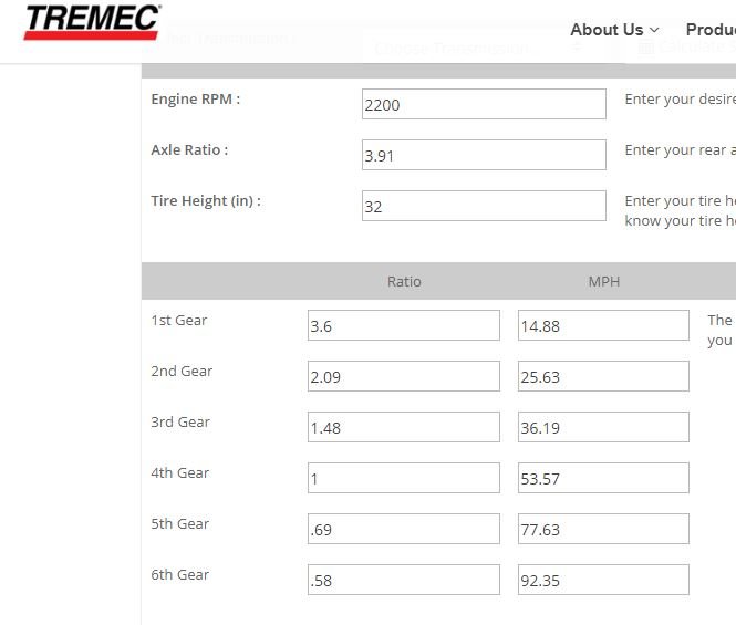

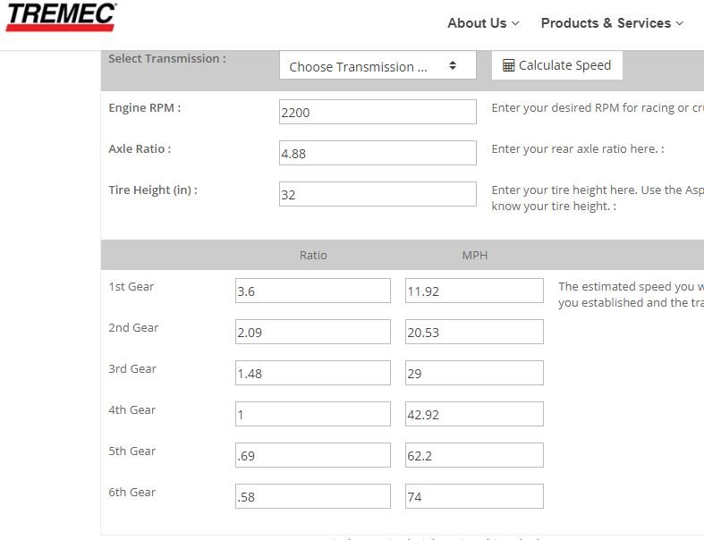

    Ok, I just answered my own question. After years of owning a Rubicon that I upgraded to 35 inch tires and was planning on going to 37's with it, I knew regearing it was a necessity. I did not realize how tall the gearing was in these 3rd gen Tacos. Upgrading tires size in a Rubi is fairly easy. With a 4 inch lift and flat fenders, I had the ability to hit 37's. I had 35's, but 37's were no problem. When I went from the factory 32's to 35's in my rubi, my mileage went from 16.6 to 12.6 with the same gears. Terrible. I had no power climbing up the colorado 10k to 11k foot passes. So I know that in this Taco, I will have to regear. What I just did was make a comparison at highway rpm of 2200 rpm in all gears and here is what I got. Did this for myself, hope this helps you:
