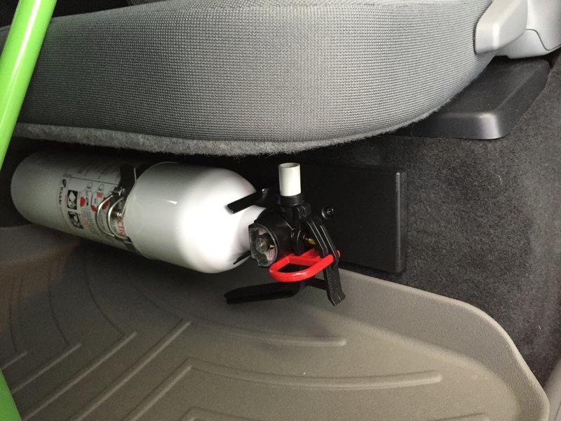

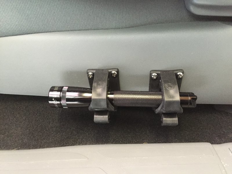

    here is a few I did. IMG_0420.jpg IMG_0421.jpg IMG_0422.jpg IMG_0423.jpg IMG_0425.jpg

    Where did you get the mount for the extinguisher under the seat?

    Its is a piece of 1/2" poly plastic, you could use 1/2" plywood. Its screwed into the body, then the bracket is screwed to that, just paint the wood.

    Huh. And the bracket is the one that came with it obviously? Where'd you get the poly plastic and did you screw it or bolt it? I'd worry about it being secure with the screws

    I build boats for a living, access to free scrap. It is screwed into the body with stainless screws. There is a gap between the body and the storage boxs under the seats. Yes I bought a better bracket ,the one that came with it was cheap. Home Depot has the fire extinguisher, and the better bracket. I hope this helps.

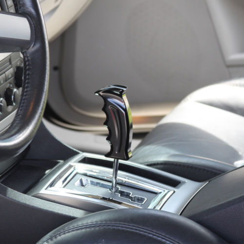

    Where'd you get that shift handle? I would really like a grip style like that.

    Yes I'd does. I just had one rolling in back but this is much better. May add an additional one. If you come across scrap like that I'll give you some money to ship it if you're willing.

    In my 02 I did the same thing, both for a flashlight, and a fire extinguisher. I used the plywood and painted. If you have access to a table saw, Home Depot , or Menards has 1/2 sheets of 9ply birch, just rip some 3" strips, clean them up with sandpaper, rattle can. My 02 I painted them grey to match the carpet.
