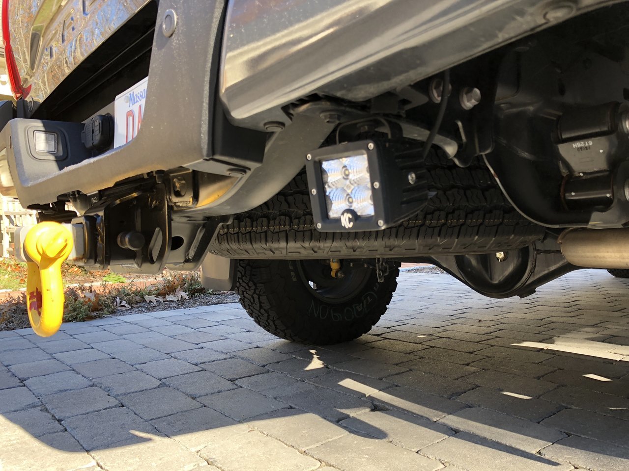

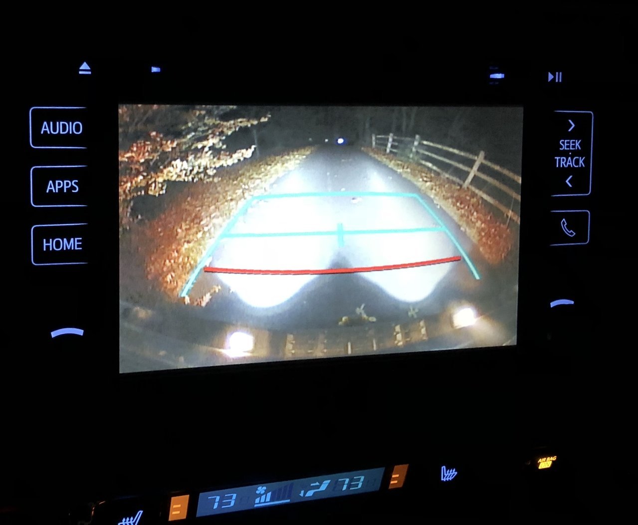

    Dual front back dash cam and KCs C3s backup lights:

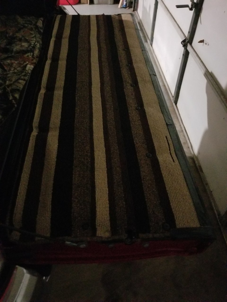

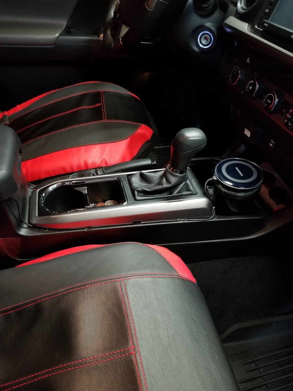

    20171130_090409.jpg 20171011_100853[1].jpg Wireless charger Velcro to a cup, Walmart rug screwed to back tailgate, Goodyear Duratracs for winter. Cheap seat covers. Cheap wire mesh inside front grill to stop stones. Just alot of crappy mods that don't cost much, but serve a purpose.

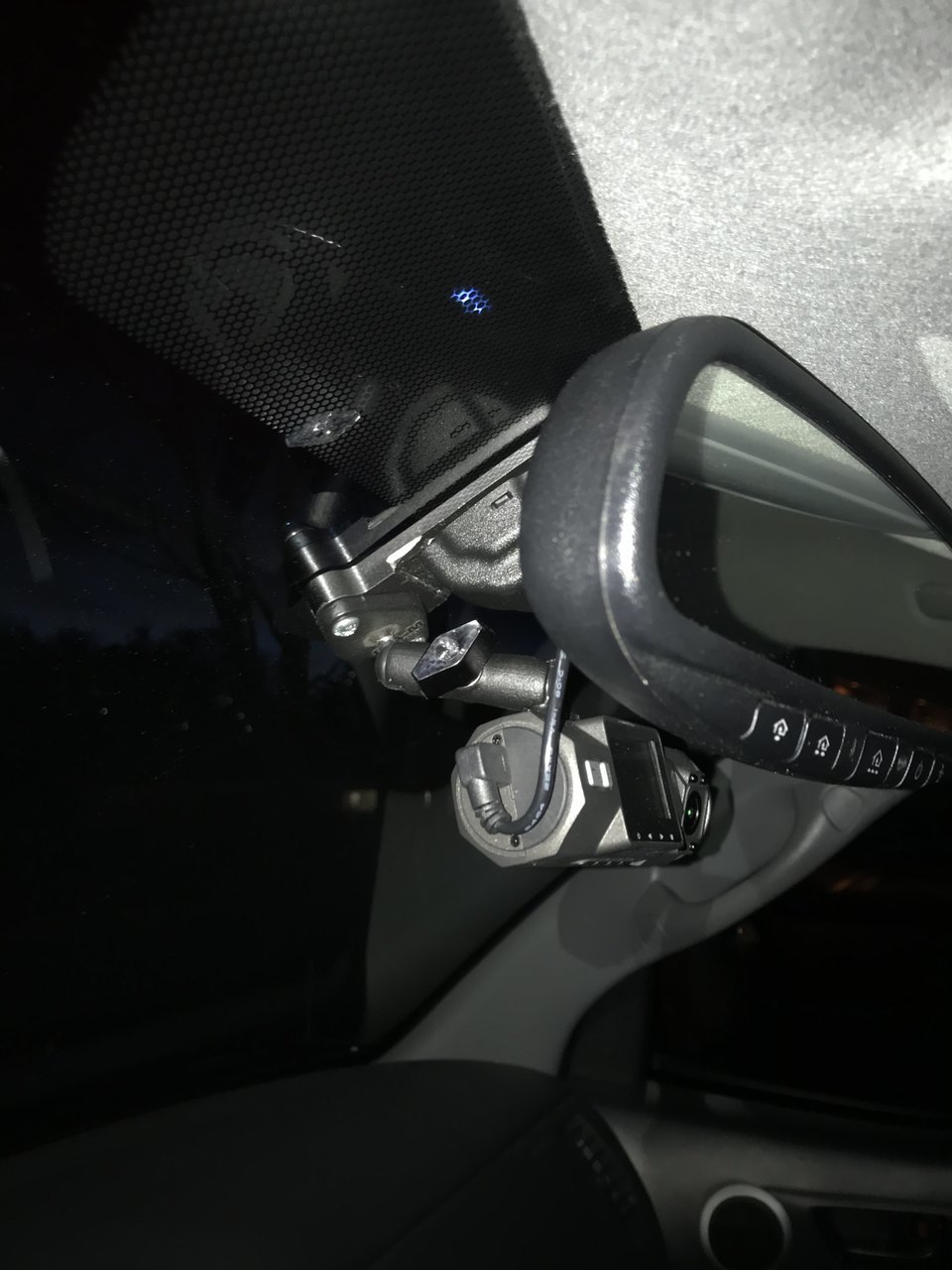

    I have a 2015 DCSB Sport. Great truck. Below is a pic of my mirror and dash cam. I bought a rear view mirror mount from bird dawg. Their mount has a position to add a Ram mount. Added a homelink mirror, which is larger than the stock one. My truck was prewired for the homelink. The dash cam is a vantrue n2 pro. Amazon has them. I ran the wires through the headliner and down the A pillow to the fuse box and used a add-a-fuse on a ignition fuse, so it comes on and goes off with the truck. Super easy. It took 15 mins to install. Well worth the money.

    Got a pic of that mesh? Also, what seat covers? I want some cheapies because I can't drop 5 hundo on damn clazzios haha

    The bracket came with the C3s, the frame mount hole either existed or I used the stock bolt, I don't recall, but I did not have to drill or fab anything.
    I popped out of the reverse light bulbs (as if changing the bulb), put a meter on the socked to find the (+) lead and then tapped it for the relay. I run most wires on driver side as there are more pot holes/water spray generally passenger/road edge side. After testing it all out I taped and tucked all the wires with tie-wraps/splice tape. These things take a beating behind the rear wheels so I went with high quality everything and mounted them closer to center. Lastly I run a double insulated (heat and PVC shield) wire conduit from the engine compartment down to the frame (driver side) so I can fish various wires but shield it from heat, impacts and grime. Rear facing low angle "headlights" make backwards driving child's play in any conditions and I wipe them off every time I wipe off the backup camera.
    Update pic:
