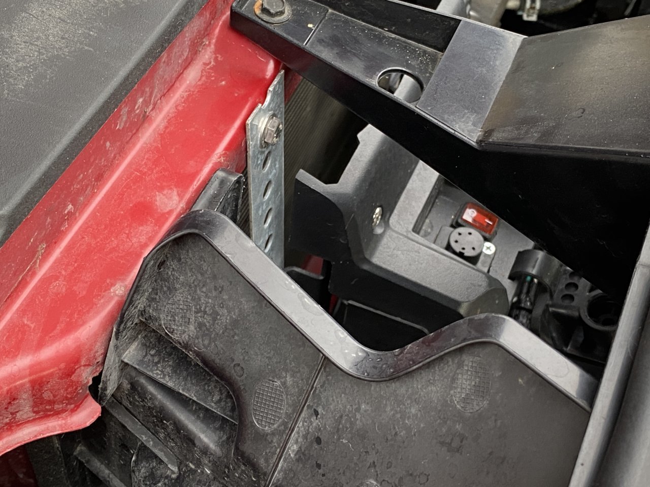

    kinda interested how you can operate the free spool and get to the remote connection if its hidden so much?
    guessing opening the hood is necessary

    494
    2020 TRD Off Road
    Yup - gotta pop the hood. The clutch lever is well within reach. For the connections, I relocated the control box, so the connecter is right at the top if needed. The winch comes with a wireless remote.

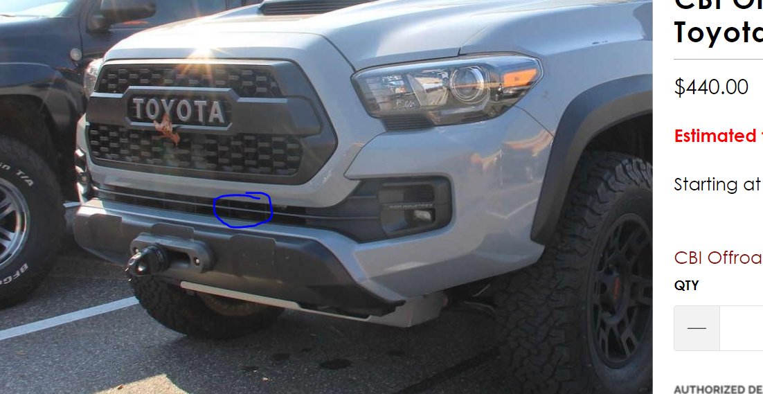

    im guessing cutting a piece of the bumper in this location would work?

    I'll get you some better pics this evening if the rain holds out. The clutch might be a bit higher than that.

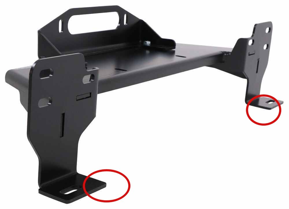

    The recovery hook replacement is a work in progress... and yeah - I think it's a must for any proper recovery. Other opinions may vary. The winch mount covers up one or both of the two mounting holes for the factory hook. The bottom mounts extend past the mounting holes and uses one of them. See below (not my pictures). I owe you a few snapshots - the rain has been pretty constant around here - especially with TS Fred looming around the corner.From what I understand, the demon bracket only use 1 mounting bolt, and can get away with that due to the wrap-around design. Still not sure which hole it actually uses though.

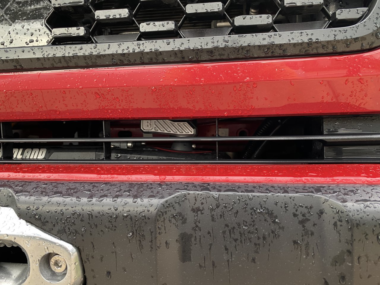

    @auskip07 - caught a break in the rain... Ok, so looks like I was wrong - the clutch lever is almost exactly where you pointed out. So, cutting a small portion of the plastic where you pointed out will get you access:
    Here's where the control box is mounted, just a few inches below the grill supports - easy access. Obviously that rubber cover is on there when not in use. We've had non-stop rain for a few days, and it was nice & dry under the cover. Score 1 point for HF:

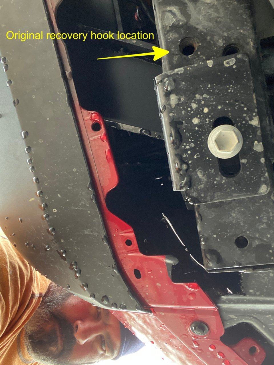

    Recovery points is an issue. As you can see in the pics below, the mounting holes for the factory recovery hook are partially covered by the winch mount. The outermost hole (for some reason I hear Beavis & Butthead giggling in my head) is used by the mount - so that's a no-go for either driver or pax location. For now, I'll have to stay away from the sketchier stuff that would require anything more than a single line pull. There's a bumper with integrated recovery points in the near future:

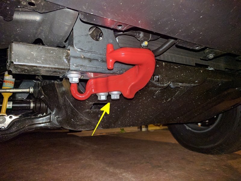

    Yes (SDHQ hidden winch mount)
    So as an alternative option to yours, SDHQ's has two recovery points on the bottom section... for anyone interested. I actually had to remove my OR tow hook to mount the SDHQ unit (which I would have rather kept it, honestly). If you look at the far right edge of the black grille, then look straight down, you can see the driver's side recovery point kind of poking down.
    Edit 2-13-22 here's a better pic showing recovery points:
    Also we mounted our control boxes almost the same way... I used pieces of the factory sub-bumper that you remove to install the hidden winch mount but otherwise same idea. The Warn is wireless so you don't have to plug a remote in, but if you need to it's accessible similar to yours. Nice job, LOL!

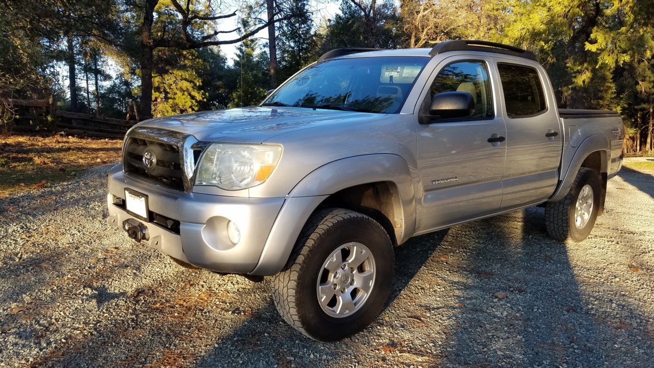

    I used a US Offroad mount https://www.usoffroad.us/store/winchmounts/tacoma-05-11-winch-mount-bumper/ and a Badlands Apex 12000 winch with synthetic rope on my 2nd gen. Had to do a little trimming to make the Apex fit, but it worked out. Setup weighs about 130 lbs, and saw a squat of 1/4" on the stock suspension.
    BTW the photo was taken after installing Bilsten 6112 struts

    I bet you'll get more drop than that over time.
  20. Feb 22, 2022 at 9:36 AM
    #20
    kenl
    kenl Member
    Oct 19, 2015
    #167060
    7
    Gold Country, California
    06 TRD Offroad Double Cab
    not much
    Probably, but will never know since the struts were upgraded to 6112s with 600lbs springs.
