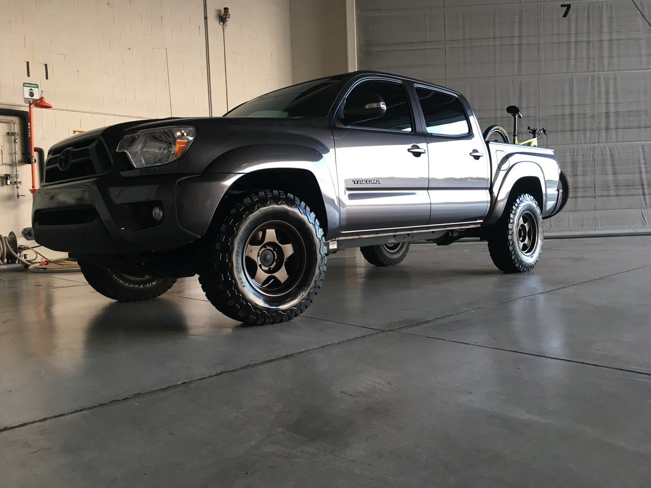

    265/75/16 or 265/70/17. Depending on tire you may or may not have to remove mud flaps.
    Here’s a stock sport with 265/75/16 ko2’s just mudflaps removed

    Nice looking taco! Would I be able to fit 31's without a lift kit?

    Yes and no Depending on tire type and rim offset and size
