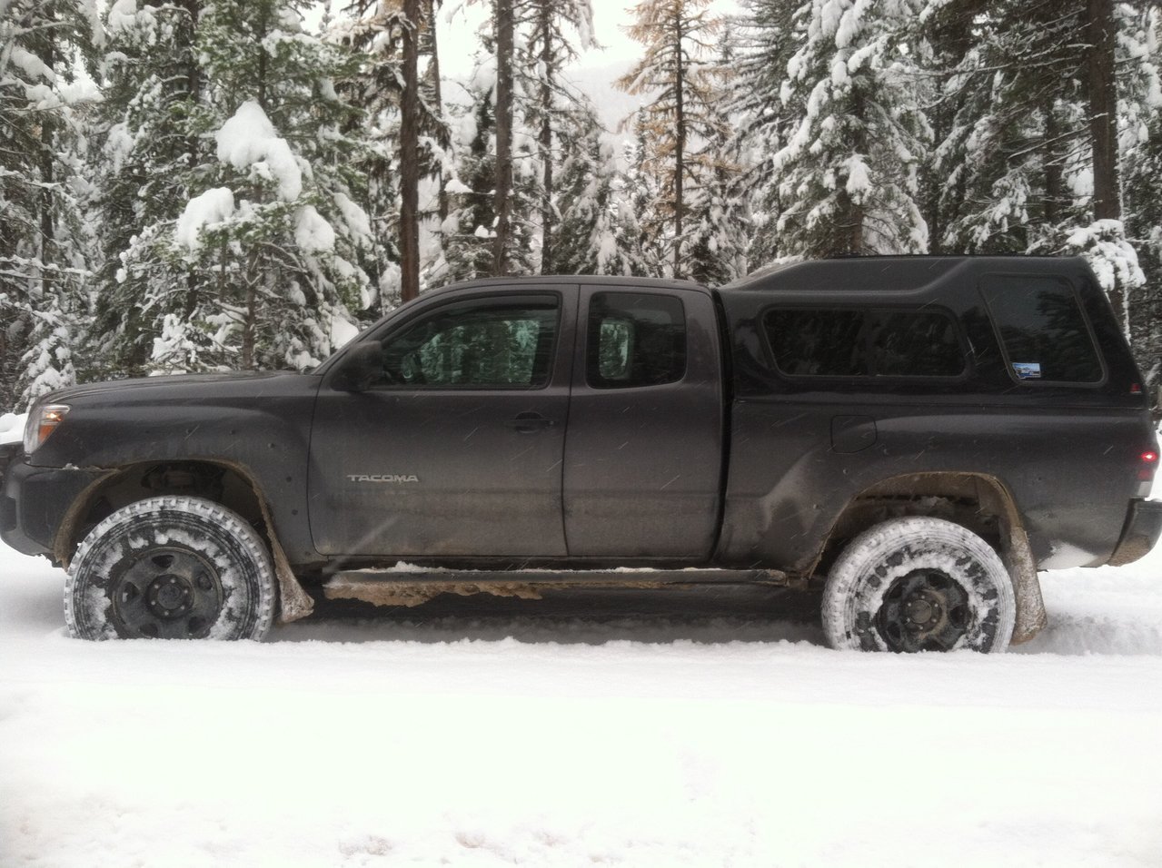

    265/75/16 tires, 5100s set at the 1.75" setting

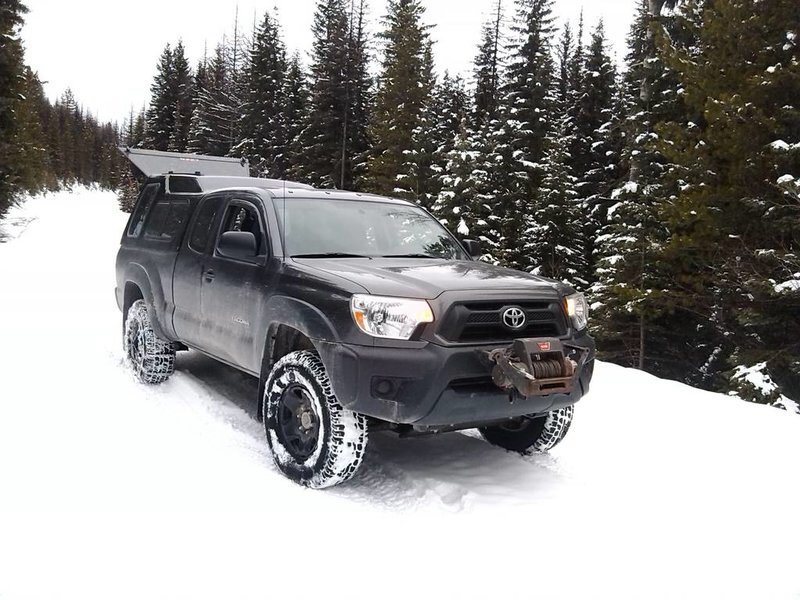

    I now have 5100s with OME 885 coils and 1/2" spacers up front. 255/85/16 tires

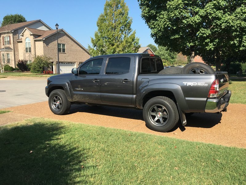

    These are my 265/65/17's Michelin LTX AT2s with some Discount Tire Wheels. There was a slight offset to the wheels which caused some rubbing on the front inner fender and some issues with the mud flaps. A little trimming resolved that issue.
    I wasn't really interested in lifting the truck at all, but now that I have owned it a couple years and have put a camper top on the back I think I might put on some an AAL in the back, coils in the front, and newer shocks. It won't be more than 1-2" over stock size and I think the tires will look ok.
