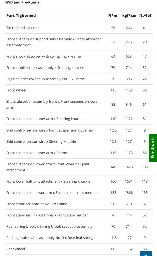

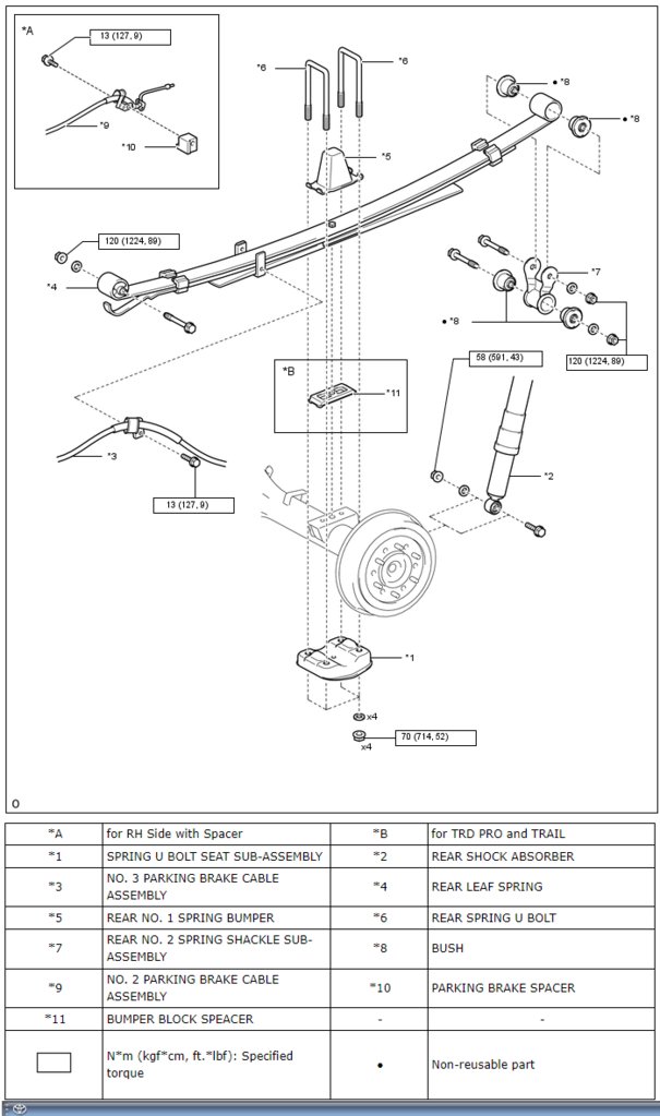

    This is from the actual FSM.
    52 ft-lbs
