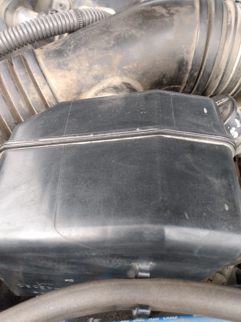

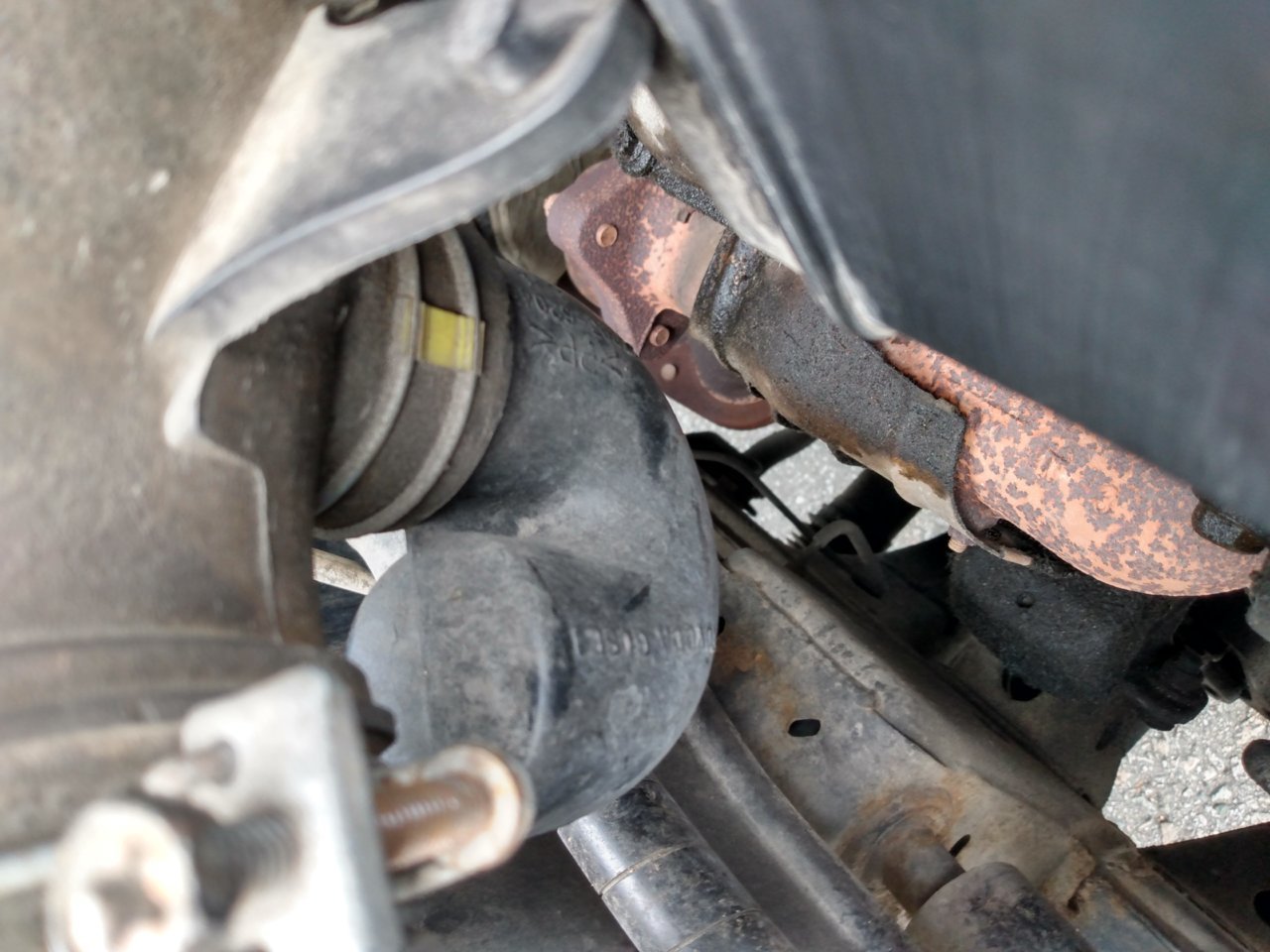

What are these 2 on the air intake?

    Intake silencers/resonators.

    they are sound chambers... they reduce/stop the nosie from the intake plenum.

    Get a kit from Napa... that chamber retains heat which is heating up the air into the throttle body.
    Here is a pic of what I did for under $30.00.
    crackedmirror[OP] likes this.

    How much do you have to slip the smog shop to pass the inspection?

    Nothing slipped to the smog guy. Believe it or not, it's actually legal here in shitty CA.

    you got rid of both chambers?

    Yes I did. I used a piece of PVC from the TB which goes over the valve cover.
    I’ll get a pic for you shortly.
