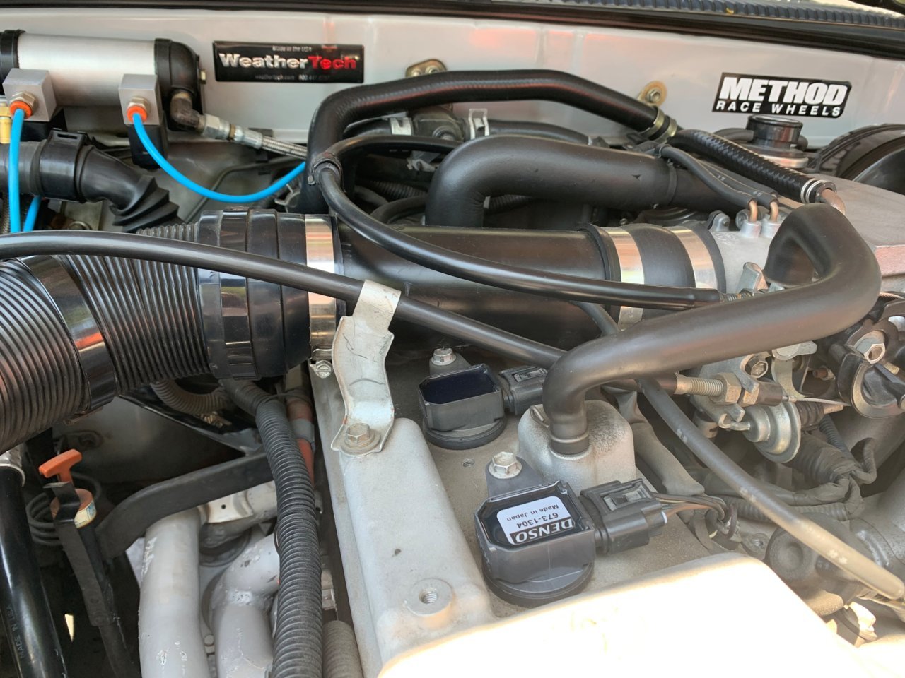

    OP,
    Here is the TB side of my air intake.

    what are the blue hoses at the back for? what are they attached to?

    ‘ helmholtz resonator chambers '

    Intake silencers/resonators.

    The pumping nature of the pistons create pulses in speed of airflow across the maf sensor. Those chambers act like baffles that smooth out the flow of air through maf so it can read air mass/density better
    The evap purge line also has a little baffle chamber for the same reason. During a purge, they don't want those pulses traveling up the purge line and confusing the fuel tank pressure sensor
