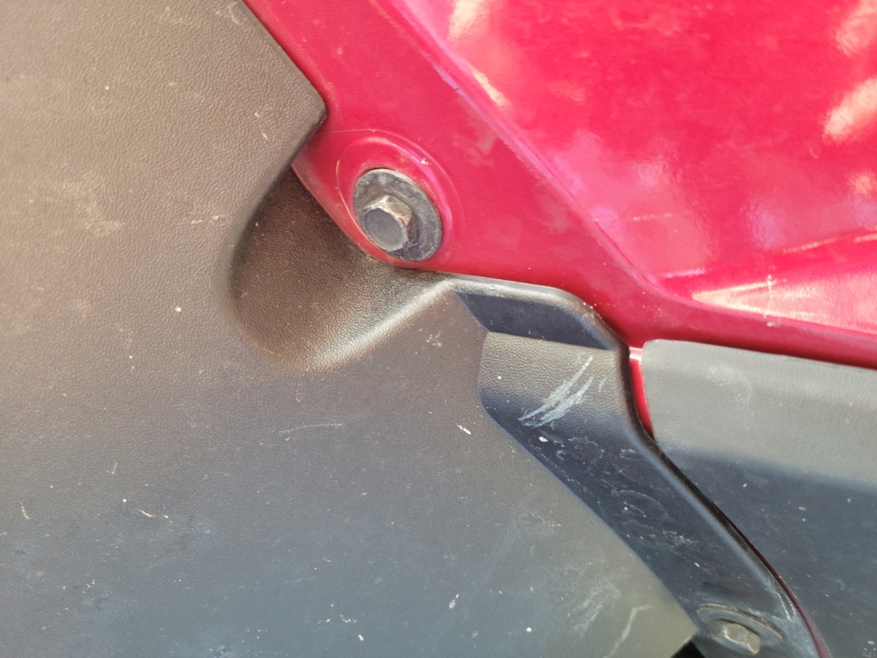

    Was removing my Air Dam today, some how my stupid self ended up removing one of these chin bolts that I had thought was some how was connected to the airdam. (It wasnt) Definitely wasnt paying attention when I was laying down in hot Tex' summer heat wrenching those bolts down. When I quickly realized, I reapplied them, but was totally worried & paranoid that i had loosen something.
    > So the main question is..
    What's the purpose of these bolts? And what is it connected to? Tried looking down to see where it could be, but still could'nt figure it out, haha...

    If I remember right, that attaches the two pieces of the bumper skin together. I did away with mine a while back when I installed a winch bumper.

    Front cover. How did you not see that the bolts went into red not black?

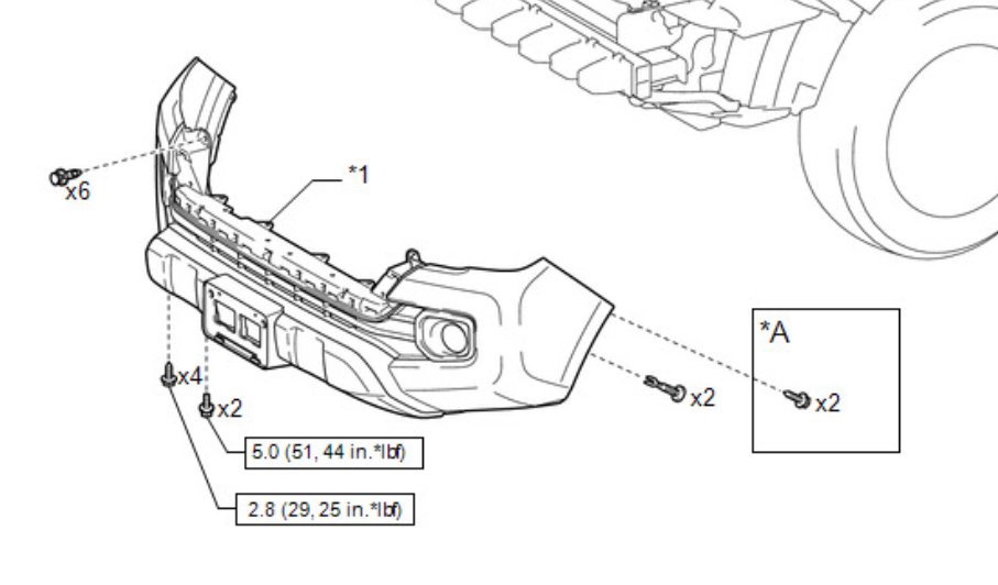

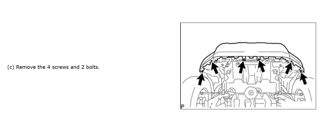

    It helps hold on the bumper cover. Note the torque on these is really low--44 in. lbs. Here's a few diagrams from the FSM:
    Franc[OP] likes this.
