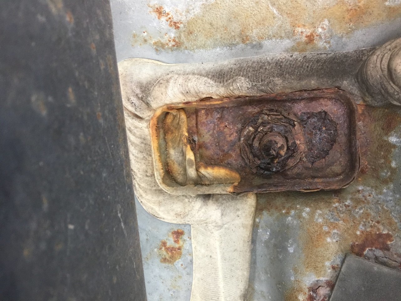

    First gen taco owners, every rust belt taco I'm finding has these brackets completely rusted out. If they're easily replaceable and not a big deal let me know. Als what are they?

    I cant tell the location very well but I would assume those are for the seat bolts and seat belts maybe, they are the only things bolted to the floor

    Most likely seat base reinforcements

    I could be wrong (dont have a 1st gen to look at), but those look like backing plates for the seats.

    That makes sense.

    Has anyone replaced those brackets? They're rusted and flaking apart on every taco I've found

    If it is for seat mounting, I'd be worried about what would happen in an accident... Seat rips out and you fly around inside the cab?

    Suspect they are welded to the floor, not just a big washer.
    They could be ground flat and another piece located over them, obviously using new bolts and proper rust inhibitor as well. But it would be a good bit of work if it was a driveway job.
    Keep in mind, if you are finding rust there, it's likely hiding in other places as well!
