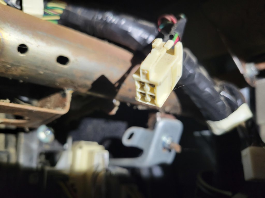

    Hi guys, I was installing the door lock receiver, which is by the passenger airbag. When I was installing the receiver I noticed that there are two connectors that are not being used, one is a 4 pin and the other is a 10 pin. Can you tell me what those connectors are for? Thanks :)

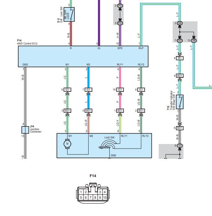

    The 10 pin is connector F14 for the 4wd ECU for the TRD OffRoad Pre-Runner Rear Diff Lock.
    Not sure about the 4 pin, do you have a better picture and wire colors?

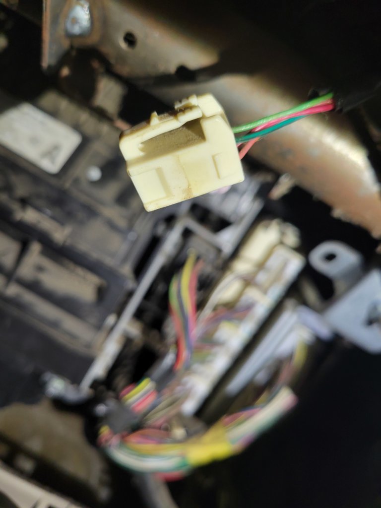

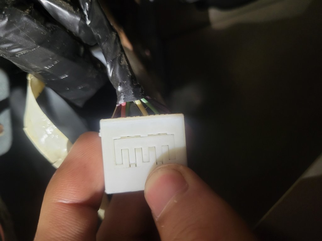

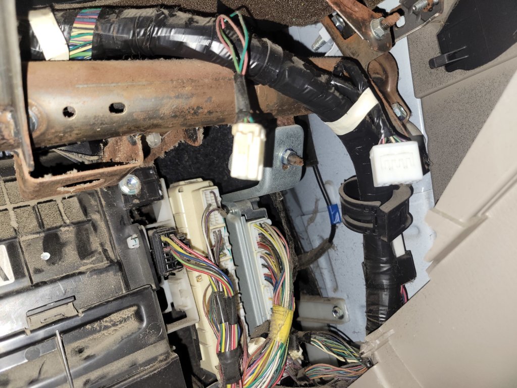

    Sí, aquí hay más fotos. Tengo una pregunta: mi Tacoma es un modelo básico 4x2. ¿La ECU 4WD también está precableada?20250124_204048.jpg 20250124_204119.jpg 20250124_204307.jpg 20250124_204319.jpg

    Looks like it's at least partially pre-wired for the 2wd rear locker but not it's not gona be pre-wired for 4wd.

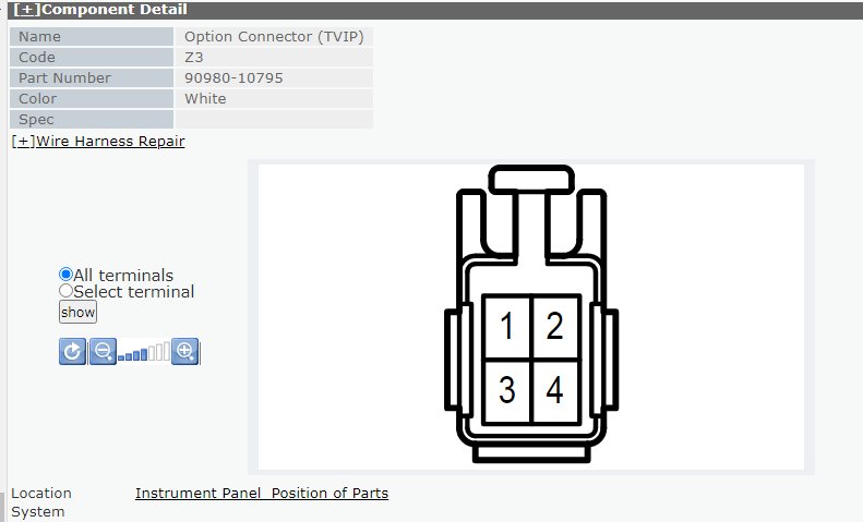

    Took some digging but I found the other connector, looks like it's Option Connector Z3 for the TVIP V5 (RS3200 Plus) accessory alarm system that was often port or dealer installed.
