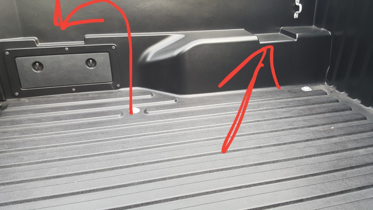

    What are these indentations in the bed for? They're on both passenger and drivers side. Looks like it might hold a toolbox or something20180513_202653.jpg

    They are for 2x4 board so you can lay a peice of plywood in the bed flat.

    Yep. Both sides of the bed in 2nd gens.

    Theyre spots to lay 2x4 across the bed. Allows you to lay a full piece of plywood in the bed without the wheel wells interrupting. Ooorrr to make your self a bed in the bed

    And in 3rd gens. I think it has to do with the longbox vs shortbox.

    Yes it is and those indentations are for a 2x6 board to make the bed split level.

    I have hauled several sheets, drywall and all kinds of crap. I have boards cut for those indentations lol.

    I put a 2x6 at the front and let’s me carry 4x8 sheets, it allows you to clear the wheel wells.
    I don’t use the second one I lay them over the gate closed.

    Used them for hauling plywood and sheet metal. Also works well for building a second "floor" for use while having a 45 gallon Airstream water tank under it.
