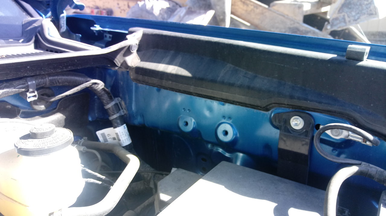

    It's specific to the models that have the electric brake booster.
    Look at everyone's picture who's says they don't have it and look at their brake booster, conventional vacuum brake booster. The ones who do have it have the electric brake booster with the big electrical plug on it.
    2wd off roads don't have the electric booster since they have no need for ATRAC.

    So where’s your clutch reservoir mounted at?

    Looks like his is integrated with the brake fluid reservoir. The hose leading out of the firewall goes directly to the brake reservoir, the metal line next to it on the firewall goes down to the trans.
