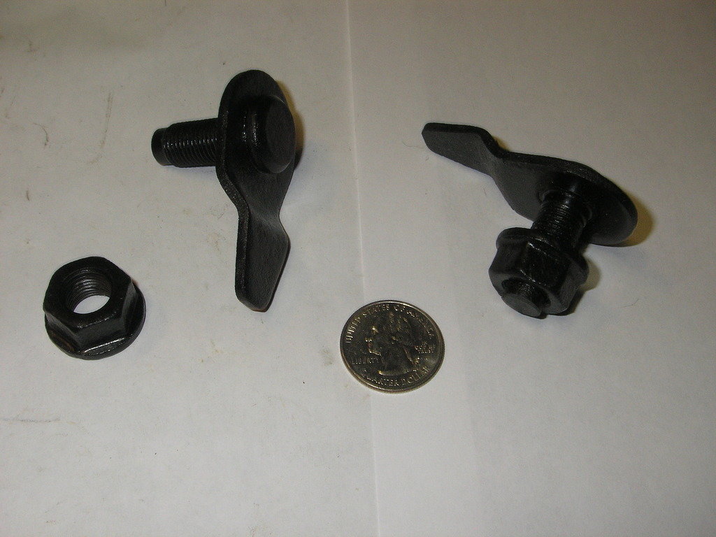

    I pulled the bed off my 04' a couple months ago to sandblast some frame rust, replace fuel pump, paint and rust proof, rebuild the rear-end, etc. I'm finally starting to put back it back together but can't recall what these things are. Any ideas?

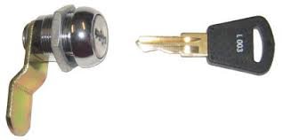

    Maybe latches for barrel locks. Use on tool boxes cabinets etc. Some put locks on their bed cubbys?

    Can I have the quarter ??

    Haha, honestly, I HAVE seen them or something real close but can't remember where on truck frame, they're tabs for something, sorry thats the best i got...:anonymous:

    Those are bed bolts, there's a raised channel where they drop in. The long end acts a stop so the bolt doesn't turn as you tighten the nut

    Rear most bolts.

    OK, thanks! I'm guessing just the two? The rest are regular bolts? I am asking cause I need to buy some new bolts.

    That I can't rememer...... Two in the front and two towards the rear and takin the middle I believe? Set the bed on the frame and look up, see where they're missing.
