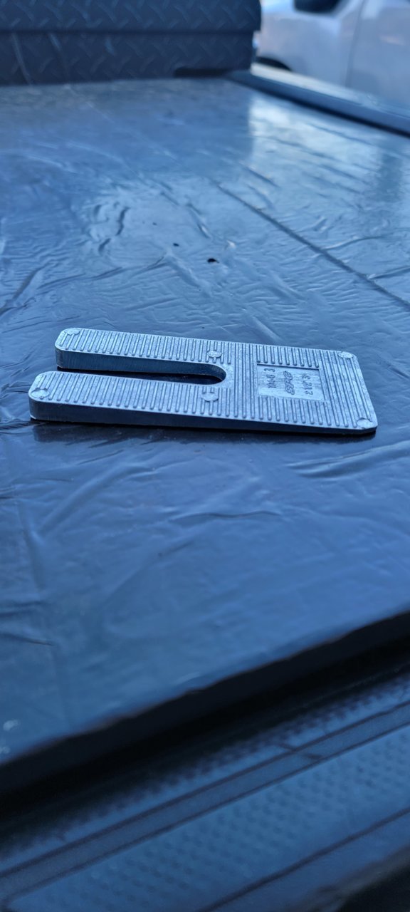

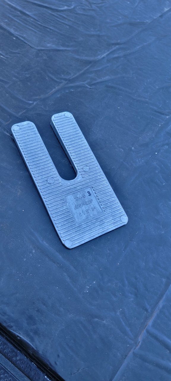

    Here's a picture of these dealios... Any writeup on how to utilize them?

    gudujarlson
    gudujarlson Well-Known Member
    Jul 2, 2019
    #298083
    7,350
    Minnesota
    2020 TRD Off-Road DCSB 6MT
    Kings, Dakars, SPCs, 33's, Mobtown Sliders, TRD Skid
    CherylJane likes this.

    Personally I prefer the shims that the leaf pack center go thru and the shim is bolted to the pack.
