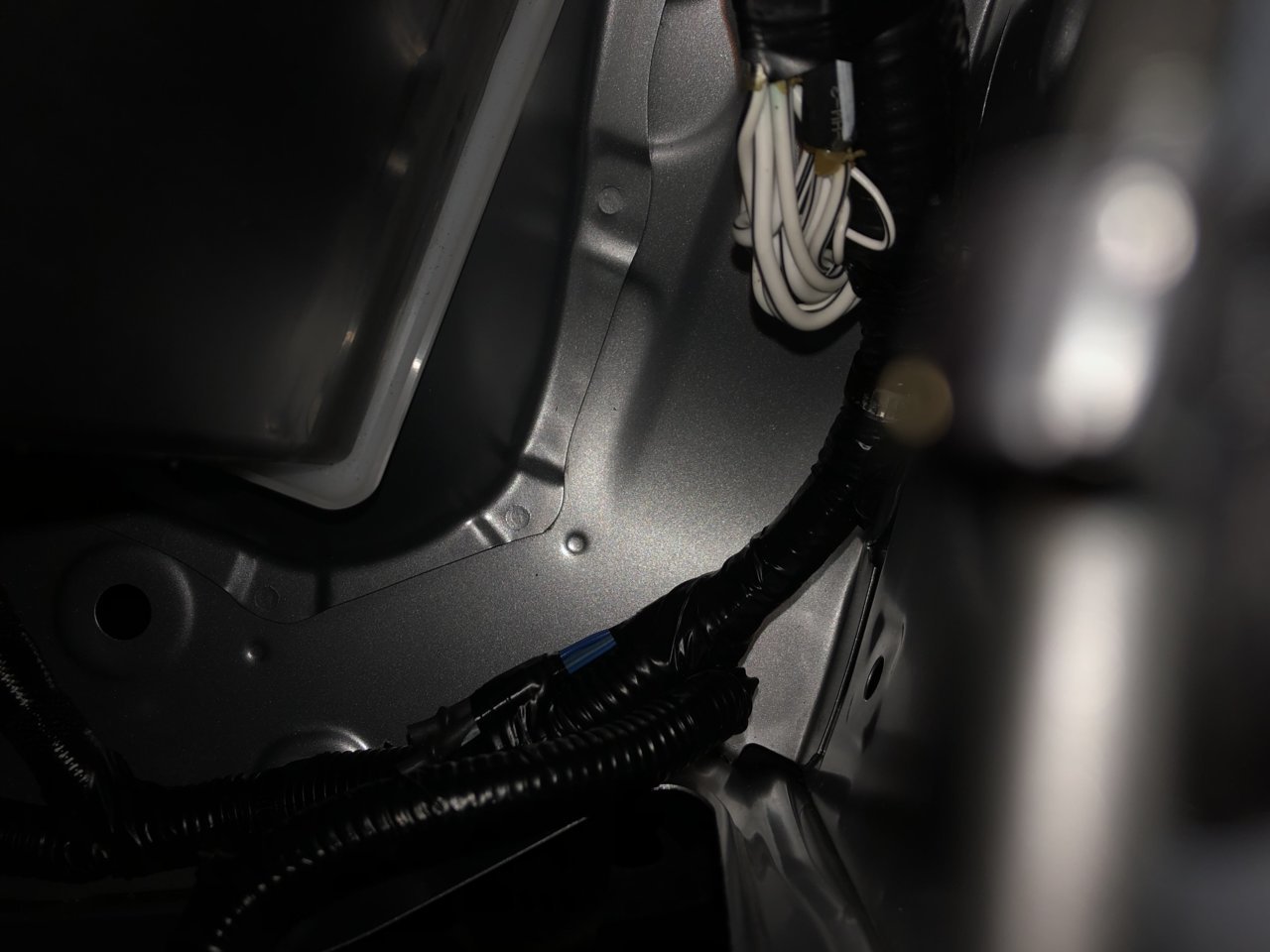

    What are these wires for? 2021 SR, are these fog light wires? I don’t have fog lights. Located between battery and fender wall. 2 blue wires capped and plugged, 2 white wires with lots of slack, capped and plugged. I think they gave me the relay too.

    doubt its an OEM wireharness. Some type of security system?

    Came with the truck it’s brand new.

    Did the dealer install anything prior to your purchase?

    its definatly OEM, The white/Black wires are grounds and the blue wires are typicaly used as a potential optional installation. They are just splices

    Just found a SR fog light DIY that some are pre-wired for fog lights. Blue and white wires run to the steering wheel.

    For sure OEM. I forget what they're for tho.

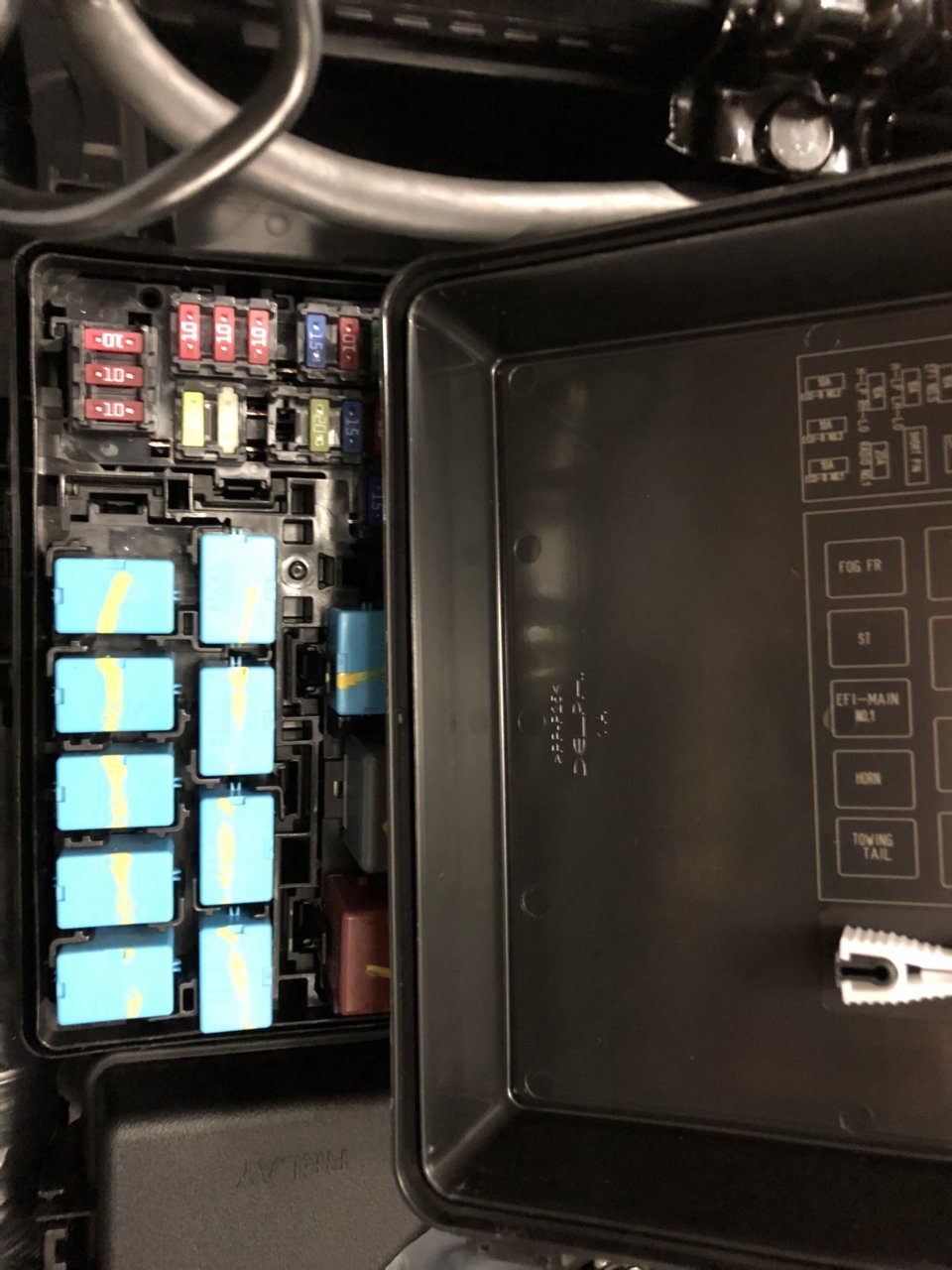

    They did include the fog light relay! Bottom left turquoise relay. I know what I’m going to be doing soon.

    That’s where I found out about the pre-wire. Looking forward to installing some fog lights.
