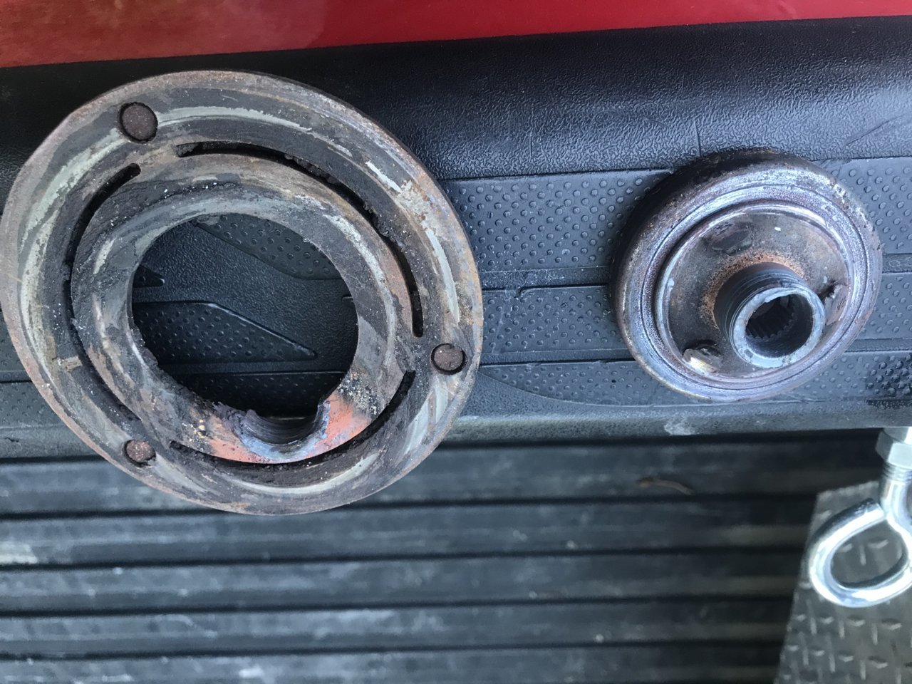

    These parts fell out the front of my truck yesterday... anyone know what they are?

    Kind looks like a top hat that has been key holed. o_O
    Did you check your truck over? Specifically the front suspension.

    Not real sure but the one part looks like something to do with your drive shaft or 4 wheel drive seeing those splines. Never saw anything like that fall out of any car. Good luck. Some one on this website will know.

    Looks like a piece off the ac compressor

    Its AC clutch

    Seems like ac compressor parts

    Yup, A/C compressor clutch...or what's left of it.

    Good time for an AC clutch rebuild.

    thanks guys! Truck is still running fine, guess now I know why the AC hasn’t been working. I thought I heard something explode after hitting the button...

    I wouldn't turn on the AC might cause more damage, right now u just need an inexpensive clutch

    My AC clutch just went also. Parts on the way

    If the bolt didnt snap off in the shaft it's an easy fix.
