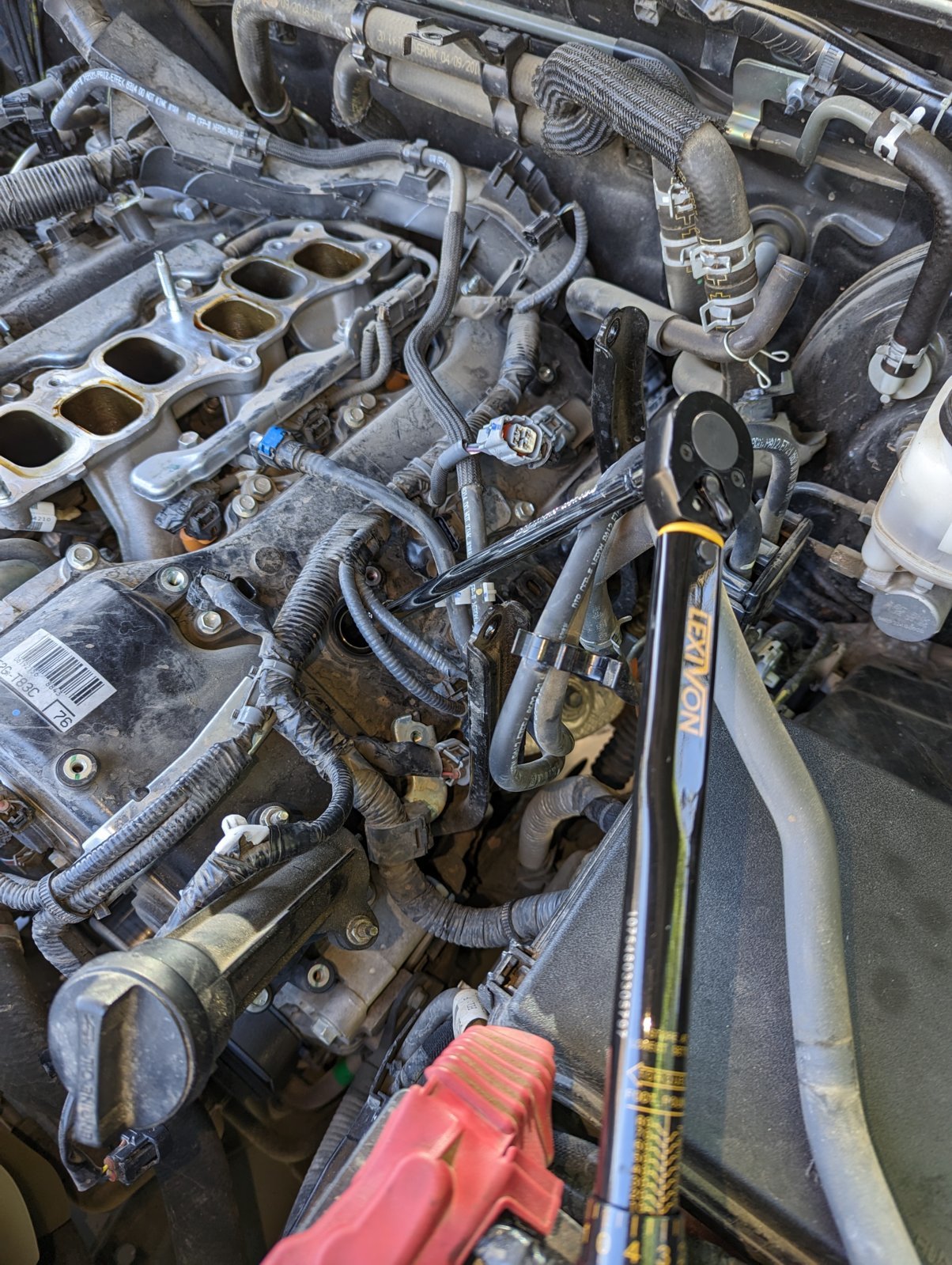

    Nah. If you go the full remove-plenum route (I did) it's not bad. You just have to be confident at removing a couple hoses, a couple of electrical connections, and then be able to reach some awkward bolts. ... And also don't drop anything down the middle part, or at least tape it up. Taping for me want necessary, I just planned on working in a way so that no tools or parts crossed that airspace.

    What the unholy Fuck is that?! Do you really have to take the engine that far apart just to change the plugs?

    The plugs should be about $100. The last time I changed mine, it took me about an hour. If you have tools just do it yourself. If not, go buy them and do it yourself, ha. You'll save a ton of money. Passenger side is super easy. The driver side can be a pain the first time, just take your time. I also found that going in through the fender liner helps a ton too.

    No, you don't, ha. I'm guessing they were doing other things during that project.

    Oh, good. The sorry thing is I wound't have been surprised if you did have to pull the plenum just to change the plugs.

    Nope…..it’s not necessary, but it DOES make the job a lot easier
