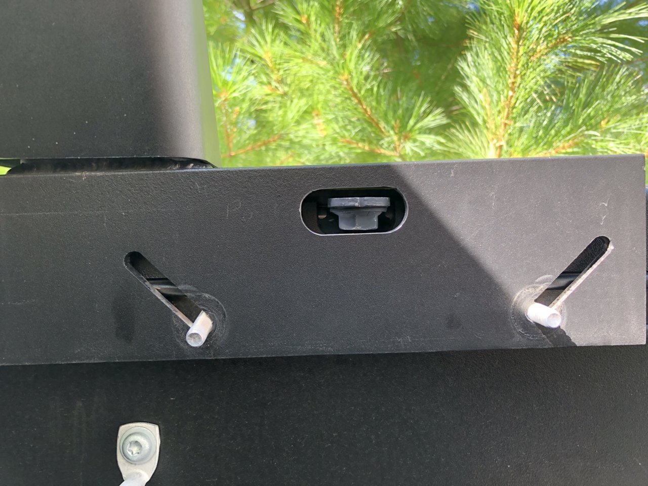

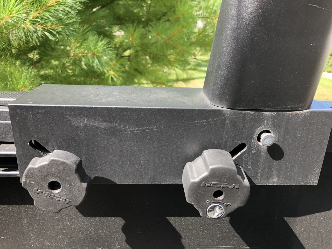

    To extend the mounting slots in the rack I just used a couple of hand files. It took a bit but the aluminum is soft so it wasn’t bad. I carefully measured for where the tonneau mounting pins needed to pass through and drilled those.
    As for the slot needed to pass through the mounting bolt bracket I drill 2 holes and filed a slot between them.
    full disclosure that slot looked like hell when I was done so yes, I did take it to work and cleaned it up on the proper milling machine.

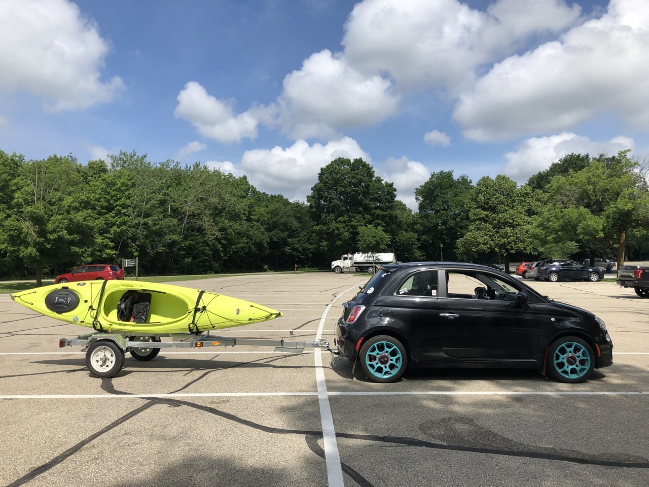

    That is the advantage of a dedicated kayak trailer. It’s not overly sprung like most utility trailers.
    Plus super easy loading since it’s not up high. Downside is you need to be going somewhere you can park with a trailer.
    I bought a Right On Ruffsport a few years back that was perfect for towing behind my Fiat.

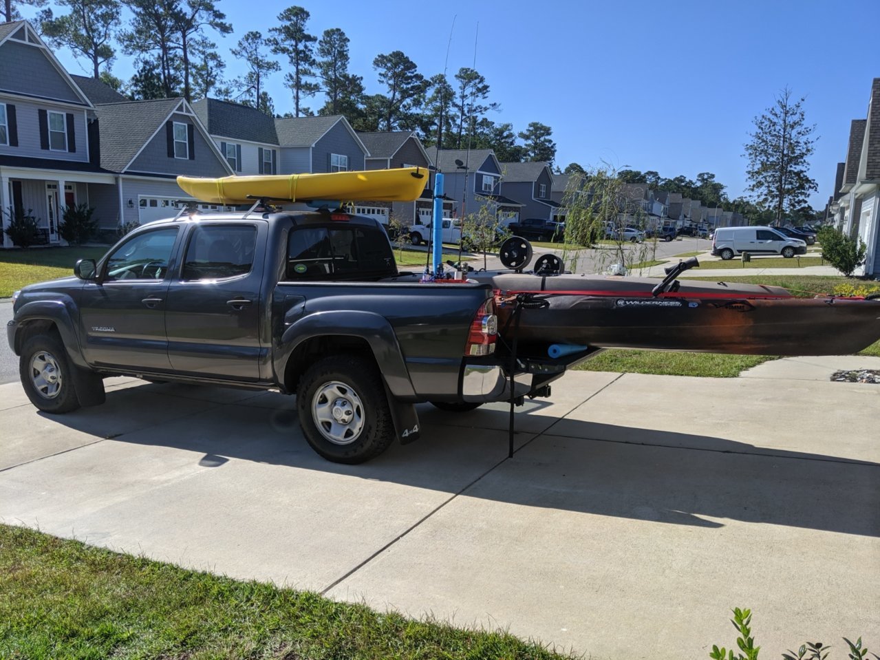

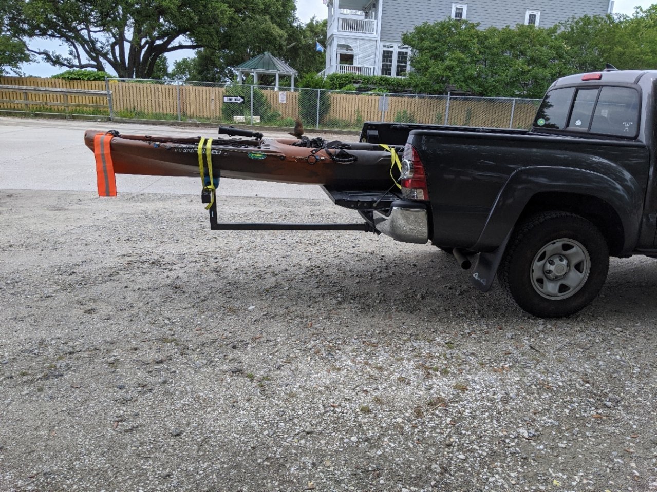

    My setup, Malone Versa rack on the roof, and one or two boats in the bed. I have since gotten the Harbor Freight bed extender for the back $50 after applying the ubiquitous 20% off coupon.
