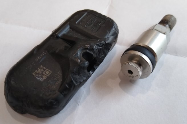

    2012 DCSB TRDOR
  13. Dec 1, 2020 at 12:45 PM
