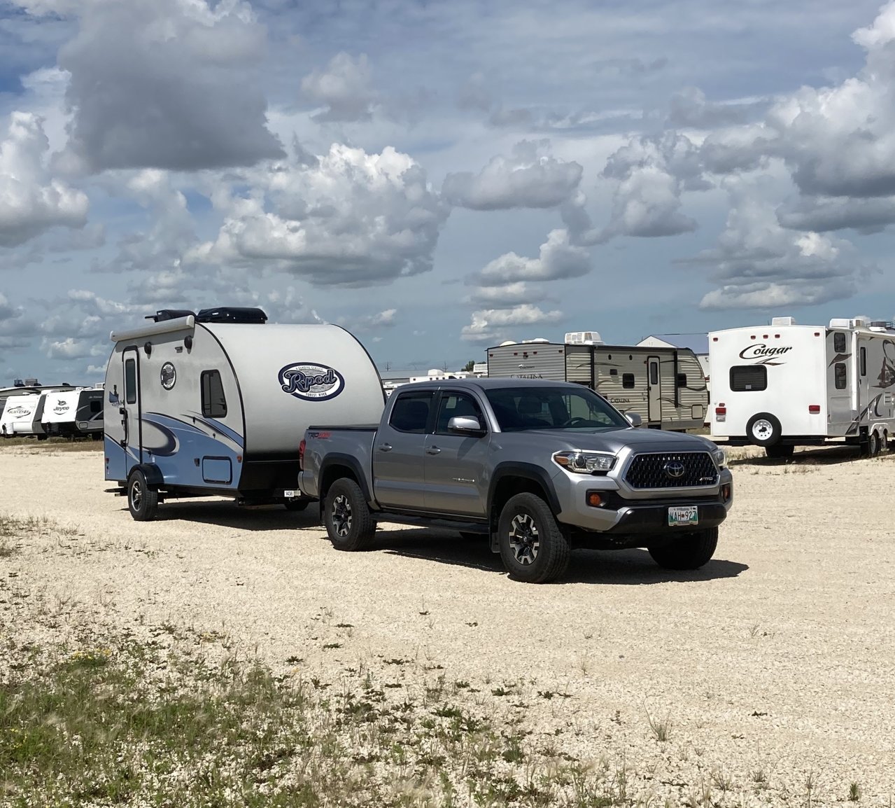

    20’, 2800/296 dry, 3250/400 fully loaded. Perfect weight for my 2018 OR with helper springs.

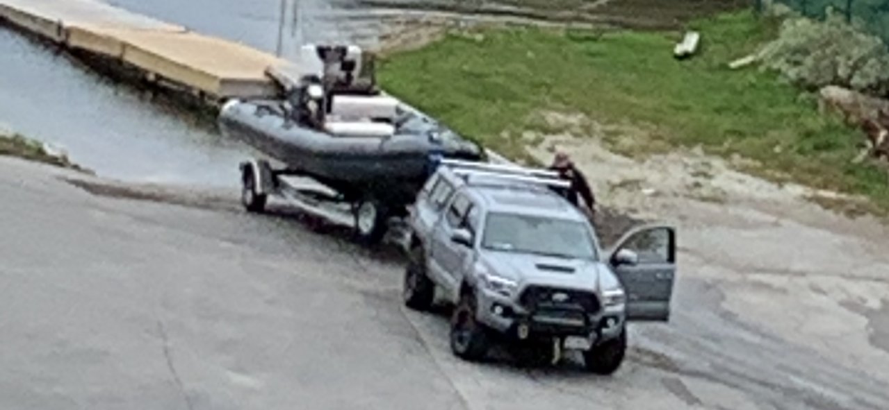

    2018 Tacoma TRD Sport double cab short box manual transmission cement grey
    ARE canopy with sliding screened windoors and rhino roof track, Warn semi-hidden winch mount with VR 10 winch, nightrider 28" single row LED lightbar, Hood scoop light bar, Anytime front and rear cameras. anytime Navigation switch, plug-in oil pan heater, plug-in block heater, plug-in battery blanket. WINTER: Snow Sport plow with back-drag modification, Bridgestone Blizzak DM V2 on steelies 265-70-17.
    12” cargo trailer or 22” boat - both <4000lbs
    Junkhead likes this.

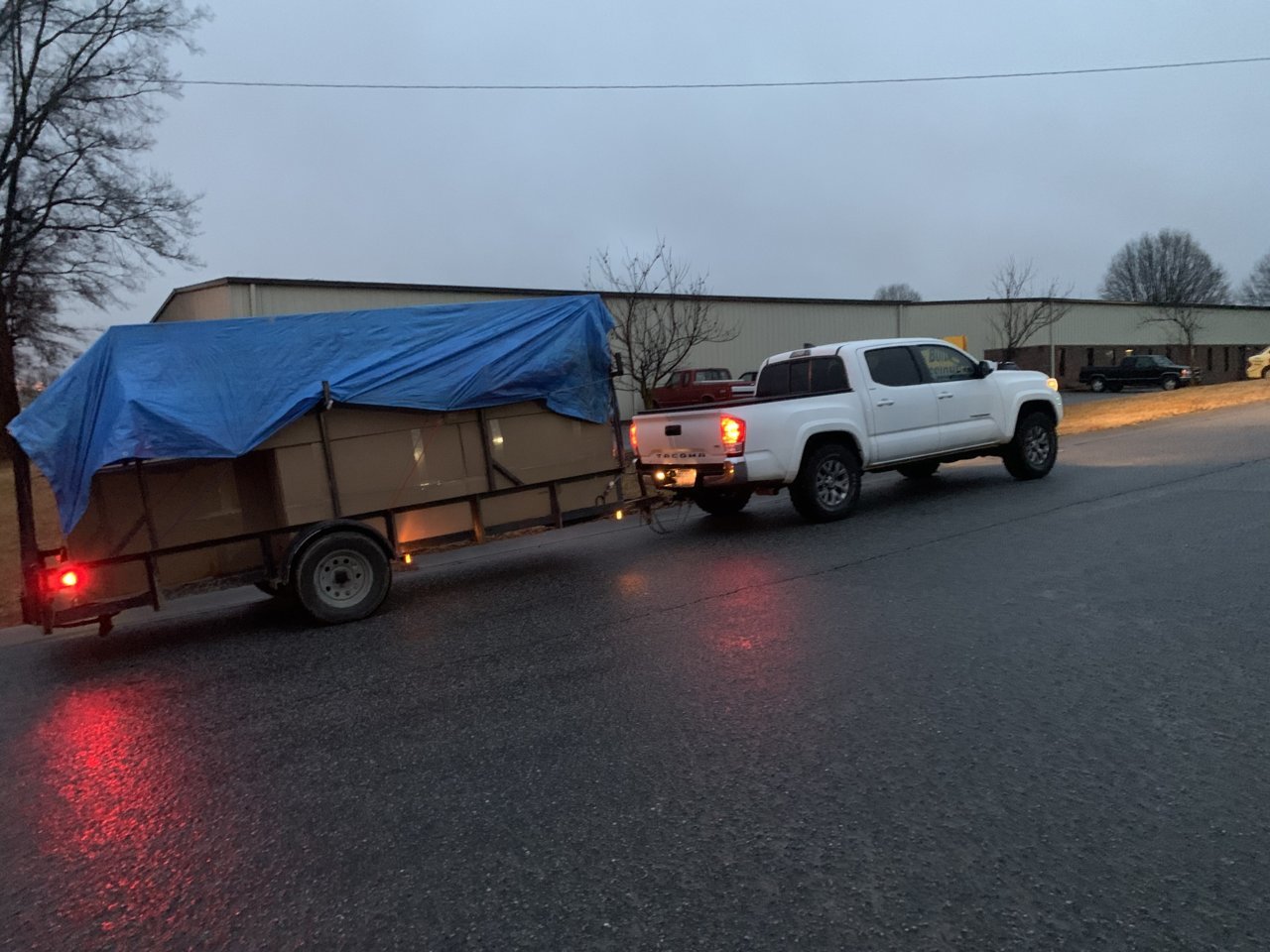

    I agree with the other guys. The rv is a different animal but I towed a load of commercial mailboxes a couple hours to a job site today in the rain at 70mph and it did well.
