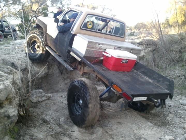

    I have been running 37-40s for years on stock Toyota rear axles. I do keep spares in the truck just incase though. 85 truck, 37 m/t-r Goodyear old tread patern. Gettin' it!image.jpg
