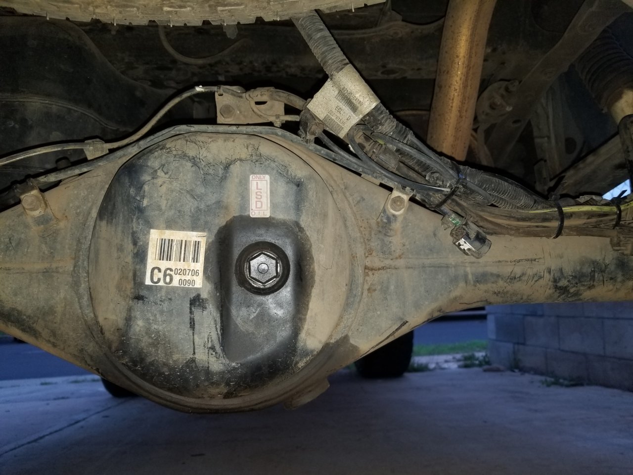

    Hey guys trying to identify what axle this is so i can order the proper complete third member. Its on a 2012 4x4 but it was swapped in at some point because im supposed to have locking reardiff and this certainly does not. Is this sticker identifying the part number?? Tried searching with no luck. Please help

    The LSD sticker would signify the truck it came from had some form of limited slip differential. Afaik 09+ has the simulated lsd from modulating the brakes... not sure how anything changed inside the diff itself, but I believe it didn't have a mechanical limited slip any more after 08. Too long away from the 2nd gen forums so take that with a huge grain of salt...

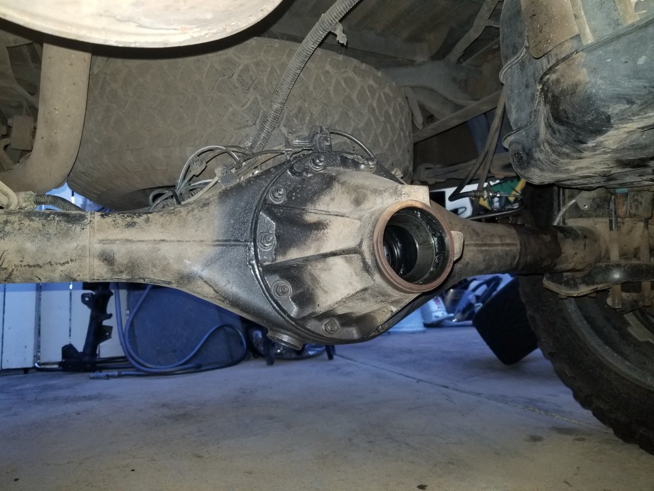

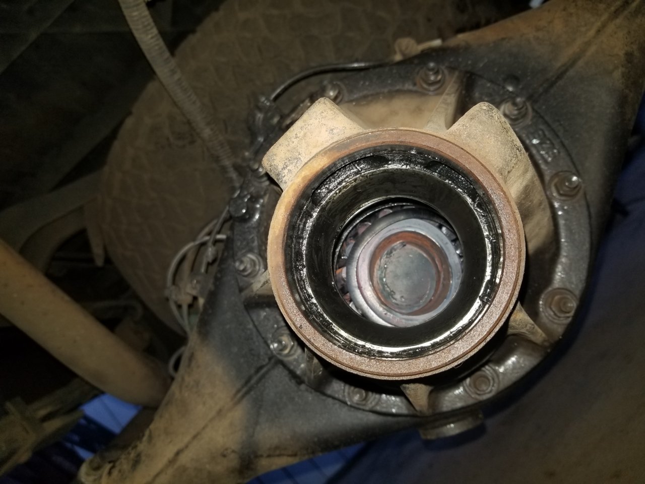

    Id like to swap in a new 3rd member for this axle since the previous jackass damaged the current one and sheared it off lol. Ultimately ill swap the proper axle back in when i can find a good deal. But for now i wanna just get it going for now and make sure nothing else is wrong like transmission and transfer case . Anyone know what i should order. Im still clueless. What year i should get, probably going for ebay used

    Sheared what off? There's only two types of axles for 2nd gen 6 lugs - e lockers and "8.4" open diffs which would include those with the factory lsd. To confirm what I'm talking about, you can check out ECGS's website - many guys on here get complete third member swaps from them so they know our trucks inside and out:
    https://eastcoastgearsupply.com/c-1065072-assembled-3rds-clamshells-05-15-tacoma.html
    I was going to say just look through local sales, but if you're in Hawaii that could be a challenge...

    Thats the current situation with the diff. Lol this is my first time really getting i to this stuff so i really appreciate your guys help and guidance. Im hoping the actual axle shafts are still good. Im gonna check out your link and see if i can get just the third member.

    T100 was the full size truck before the Tundra. Here's a lot of good info:
    http://home.4x4wire.com/erik/diffs/
    While any 8.4 diff will drop into any 8.4 housing, some of the pinion flanges won't bolt up to a drive shaft on various models without redrilling the flange. Call up east coast gear supply to check that info before you buy anything unless you feel comfortable redrilling the flange. Justdifferentials.com has good customer service too. They helped me find out a 2nd gen and first gen taco have different pinion flange bolt patterns.

    Yes that will fit. In the details it it says it came off of a 2006 Tacoma with 3.73 gears and no e locker. It will drop right in. Who said T100?
    edit: Wait a second, the pics in that ad don't show a regular 3rd member. you need something that looks like this
    edit #2: Nevermind. It also says in the ad that it's not an actual picture. I'd ask for a picture, but it should bolt right up

    Just check the pinion flange bolt hole pattern if you want it to be a plugn'play type of thing. 2nd gens are 66mm center to center, 1st gens are 60mm center to center... don't know what T100's and Tundras were. From a bit of research, it seems if you go with an older third from a T100, Tundra, Sequoia, or 1st Gen Taco, they all had the 60x60mm pinion flange bolt pattern. I guess Toyota changed that in 05 to be 66x66. You can redrill the flange like I said. Now that I think about it ECGS doesn't have the best bedside manner - even when I was buying an expensive diff, but they got it done quick, I'll say that. The guy at Justdifferentials.com was pretty friendly and easy to talk to. I'd check on the pinion flange bolt pattern - chances are you'll have to re-drill if you go with a T100 third, but I could be wrong about that.
