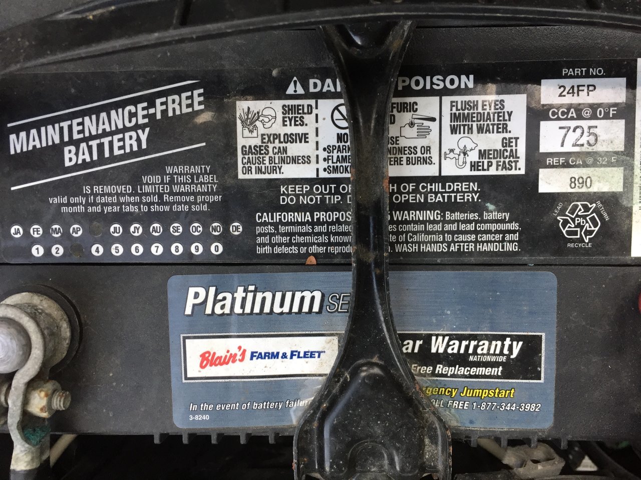

    Yeah well it's just a matter of time before you turn the key and this happens:
    We'll see how much good your 6 year warranty does you then...
