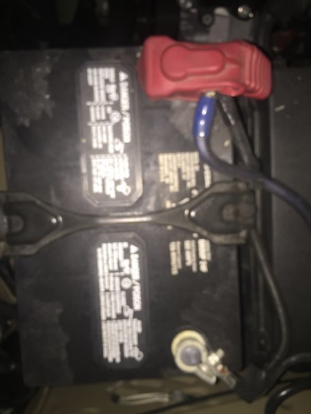

    24F here on my '16 Off-road with tow and 6MT.

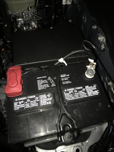

    My 2017 TRD Off-road with tow package has 24F.

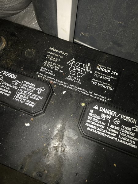

    My 2008 Pre-runner came with a 27F.

    They're all 24F for 3rd gen, and they have a pretty crappy load rating. But them being 24F has nothing to do with that.
    Group size just determines the form factor of the battery for the most part, what you're really concerned with is capacity, and you can (and probably should) get an increased capacity battery if you start adding accessories. Things to pay attention to are CCA at 0* and reserve capacity for the battery.
    For example, a Northstar 24F battery blows most standard 27F batteries out of the water: http://buy.northstarbattery.com/p/nsb-agm-24f-battery

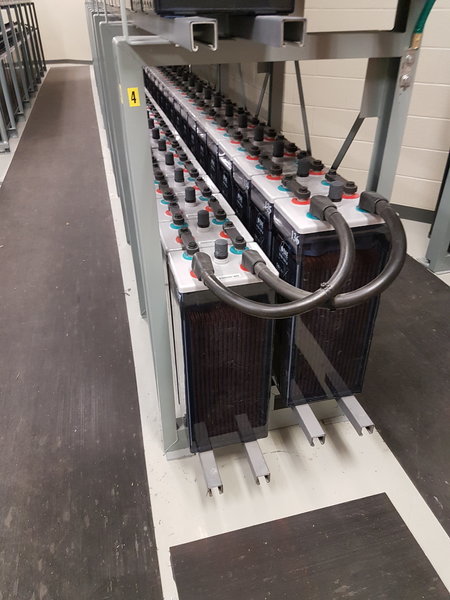

    Was talking to a guy at work today that does battery systems for UPS systems
    talking battery banks like this.
    So figure you know these guys do it daily day in day out, they know more than your average joe about batteries. He was saying the same thing though. When it comes to AGM batteries Optima isn't what it used to be. odyssey are much better

    yall wan't power? gotta run those batteries I posted lmao.
    each battery is good for 1300amp hour. that whole bank is 600V 10 000amp.
