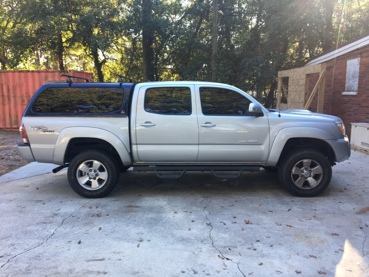

    Just put 1 inch blocks in the back and 5100s with stock sprigs set at 1.75. Lift and level. Not overkill. And got decent numbers for the alignment. Any higher and you might as well get UCAs. Pic with the bike is a before with some stuff in the back.
