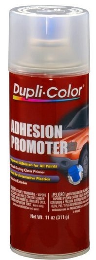

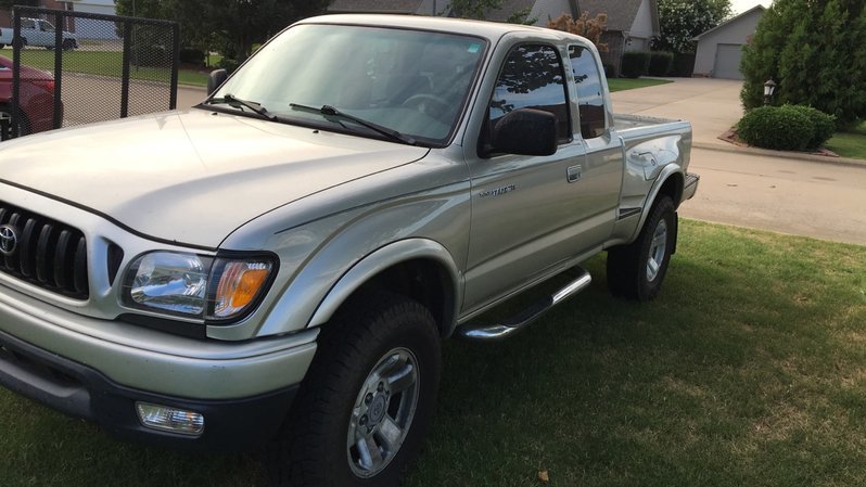

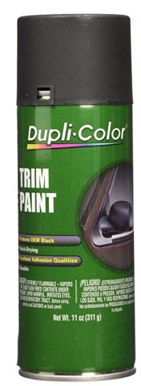

    I used Dupli-Color Trim Paint on the lower black valance and the louver, cowl top (black plastic piece in front of windshield) and it turned out great. It states OEM Black on the can so it's like a satin black.
    I also used the Dupli-Color Adhesion Promoter before applying the trim paint.
    It's been two years and it's held up surprisingly well.
