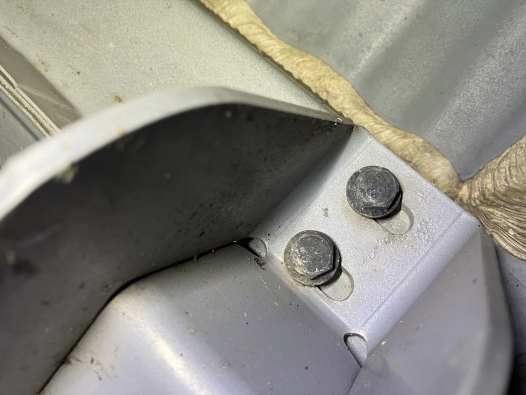

    I bought 3rd gen predator steps for my 2015 Tacoma.
    Now I need to install them. Are they the same size as the 3rd gen bolts? M8 1.25 x 30mm
    Are they stainless or regular steel? Do I need a washer?
    I have asked on FB and Reddit and no one knows.

    That is the size for the factory tube steps on a Gen 2 truck. Sounds good to go. :notsure:
    I used SS when I installed my second hand tube steps.

    The OEM bolts are plain black bolts M8x1.25

    I recently did this and bought SS bolts and washers from Amazon

    Yes, the bolts from the 3rd gen will ft. The bolt sizes are M8x1.25x20mm. Here is a link to the the factory Toyota instructions that confirm the bolts sizes are M8X1.25X20mm (Item #2).
    https://toyotaparts.sparkstoyota.com/install/PT767-35160inst.pdf

    I suggest cleaning the threads and anti-seize after.
