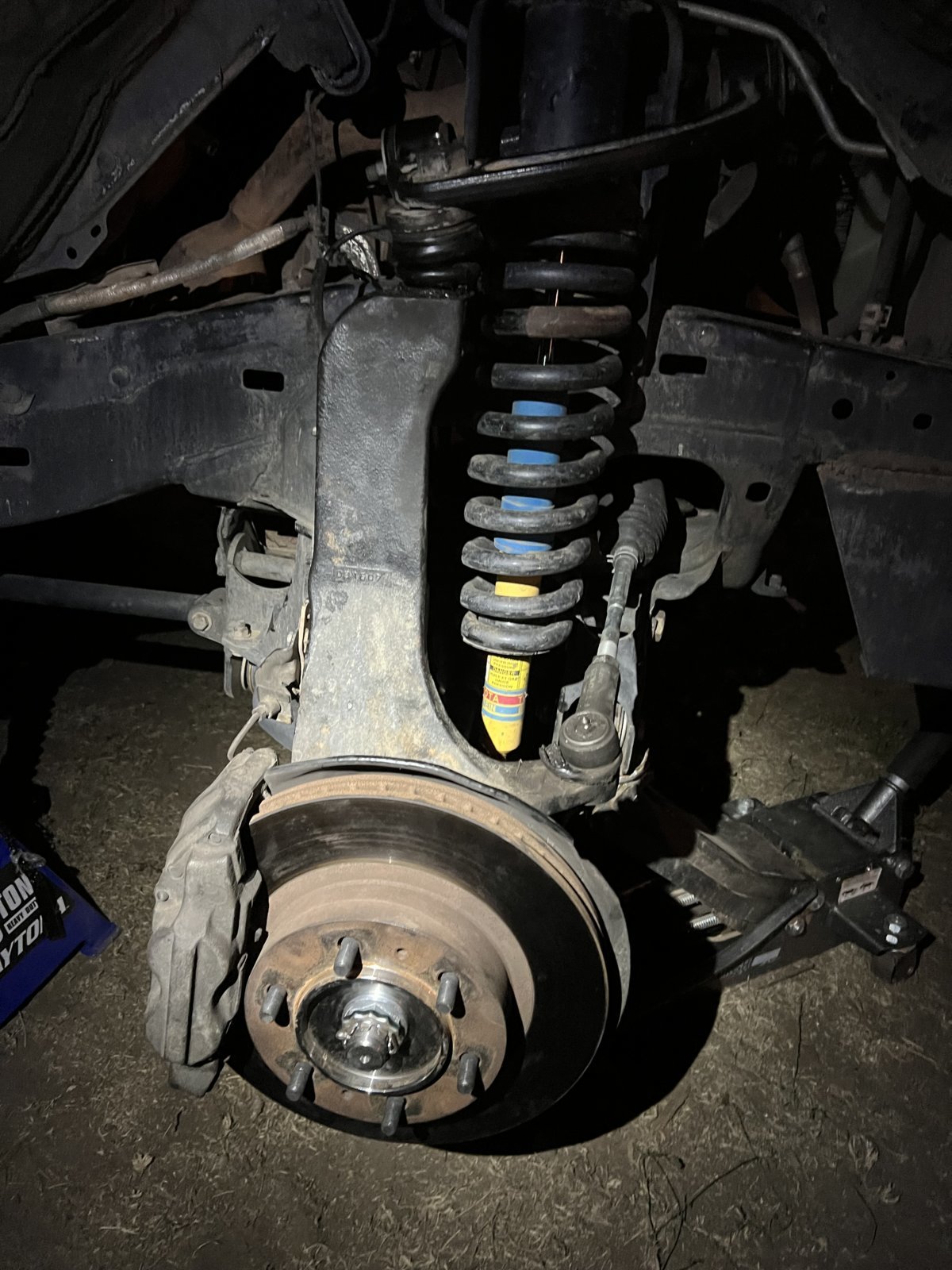

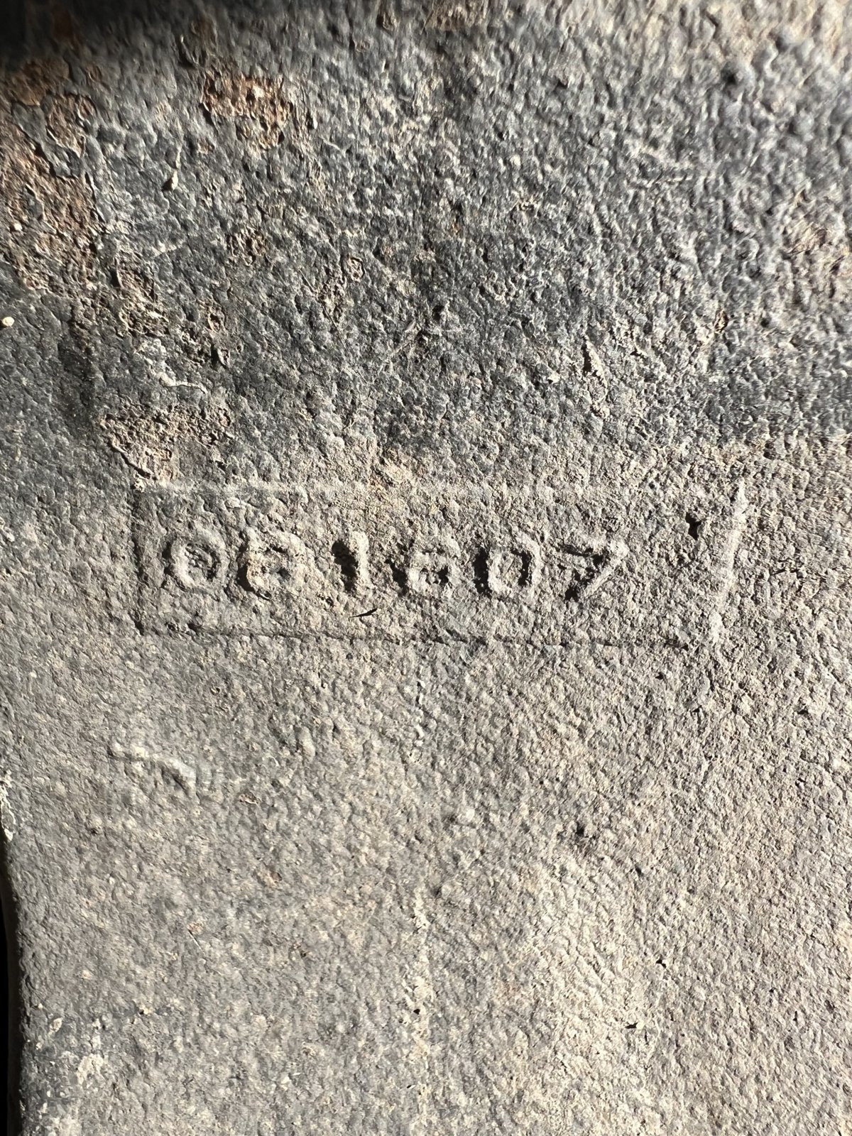

    Hello everybody new member to this forum. Have always found a lot of answers from you guys in here with my previous tacomas. I have just haven’t been a member until now. I have a 2010 Tacoma dbl cab that I just purchased. Got a sweet deal on it and couldn’t pass it up. Previous owner only owned truck for a short time so I’m finding things out about it as I go as he didn’t know much about it. Last night I changed out the passenger side cv axle. The spindle is super beefy and I would like to know the make of it. Does anyone on here recognize it?? I have done some hunting and am not able to figure it out. Any help would be much appreciated. Thanks

    That number wont do anyone any good but props for finding it. Looks like a typical 4-6 inch rough country style spacer lift. I assume it has a drop bracket under the front crossmember as well to keep those Cv axle angles somewhat in check. Those kits come with longer knuckles due to having the drop bracket for the extra lift. These tacomas wont go much above 3.5 inches up front without dropping that crossmember due to the dual wishbone front suspension.
    P.S Replace your outer tie rod, boots junk, And shake down that front end good those SPC upper balljoints are the epitome of garbage.

    Thank you I will get to replacing the tie rod end and check for any other issues.
