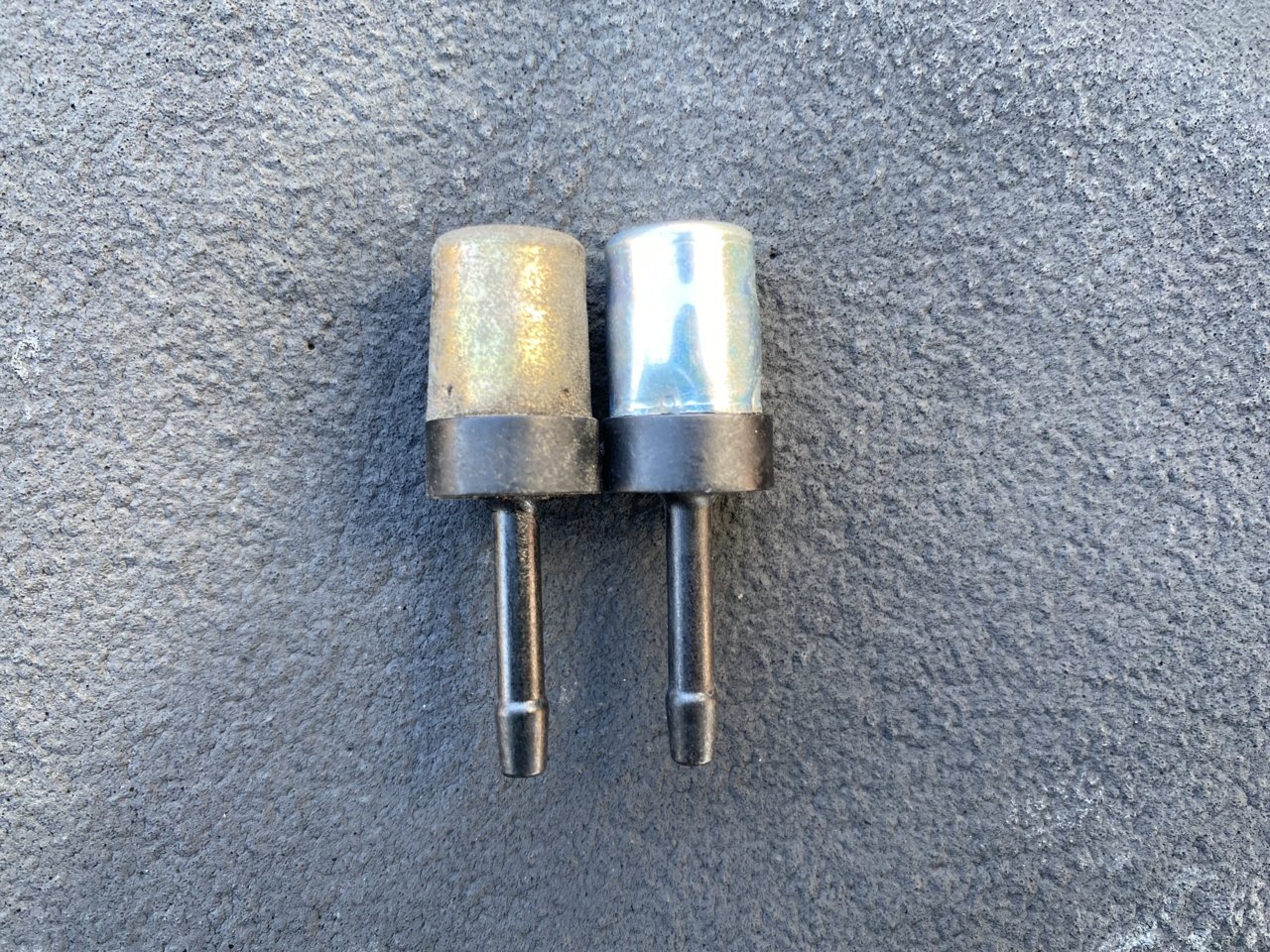

    Ha-ha! Nope.... big circles. No actuator breather by vin either. The diagrams that show the breather have no corresponding # for it.

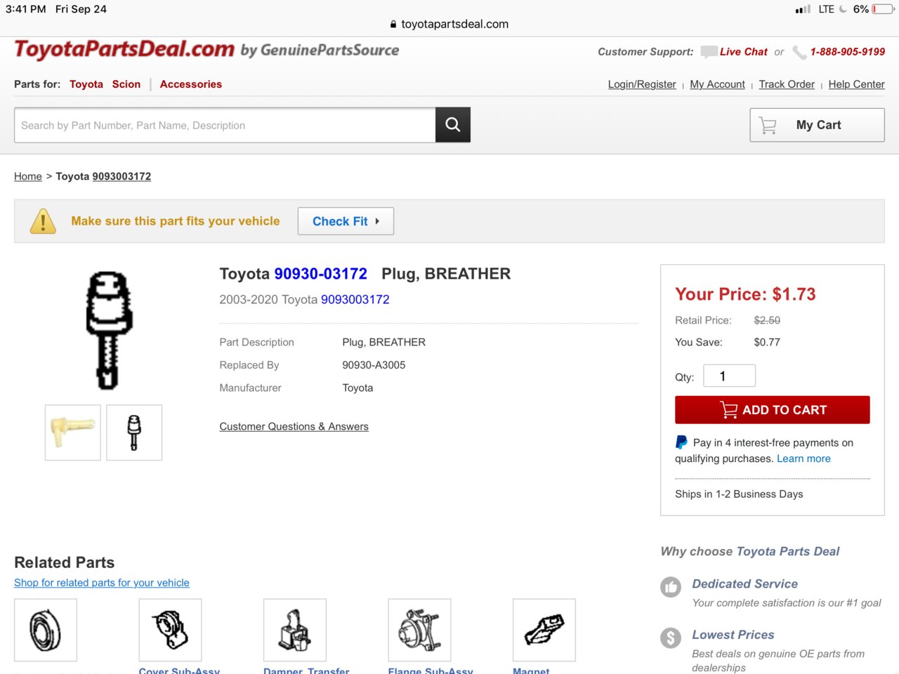

    So it looks like, as @Brahms stated, it would be this part# 90930-03172, which is also the transfer case breather. However for those of us who have this mystery smaller actuator (thank you @Empty_Lord for setting me straight on that :thumbsup:) breather, the transfer case breather should work.

    Course now this means not being able to get it cheap off Amazon.... :(

    I still haven't replaced it. I did the larger one & the rear, which was in serious need. I have read a few horror stories, especially regarding that one.

    I don't believe that would work for the smaller breather. The hose is 3mm -ish

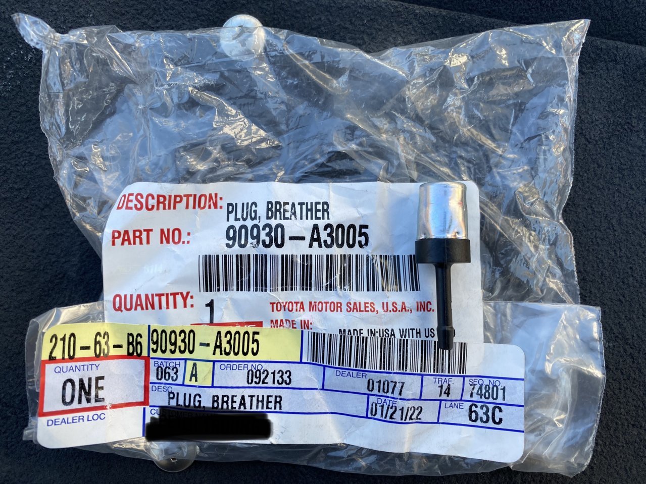

    Confirmation that 90930-A3005 is the correct part.

    Just in time! Just sat down to put together a stock parts order :thumbsup:
