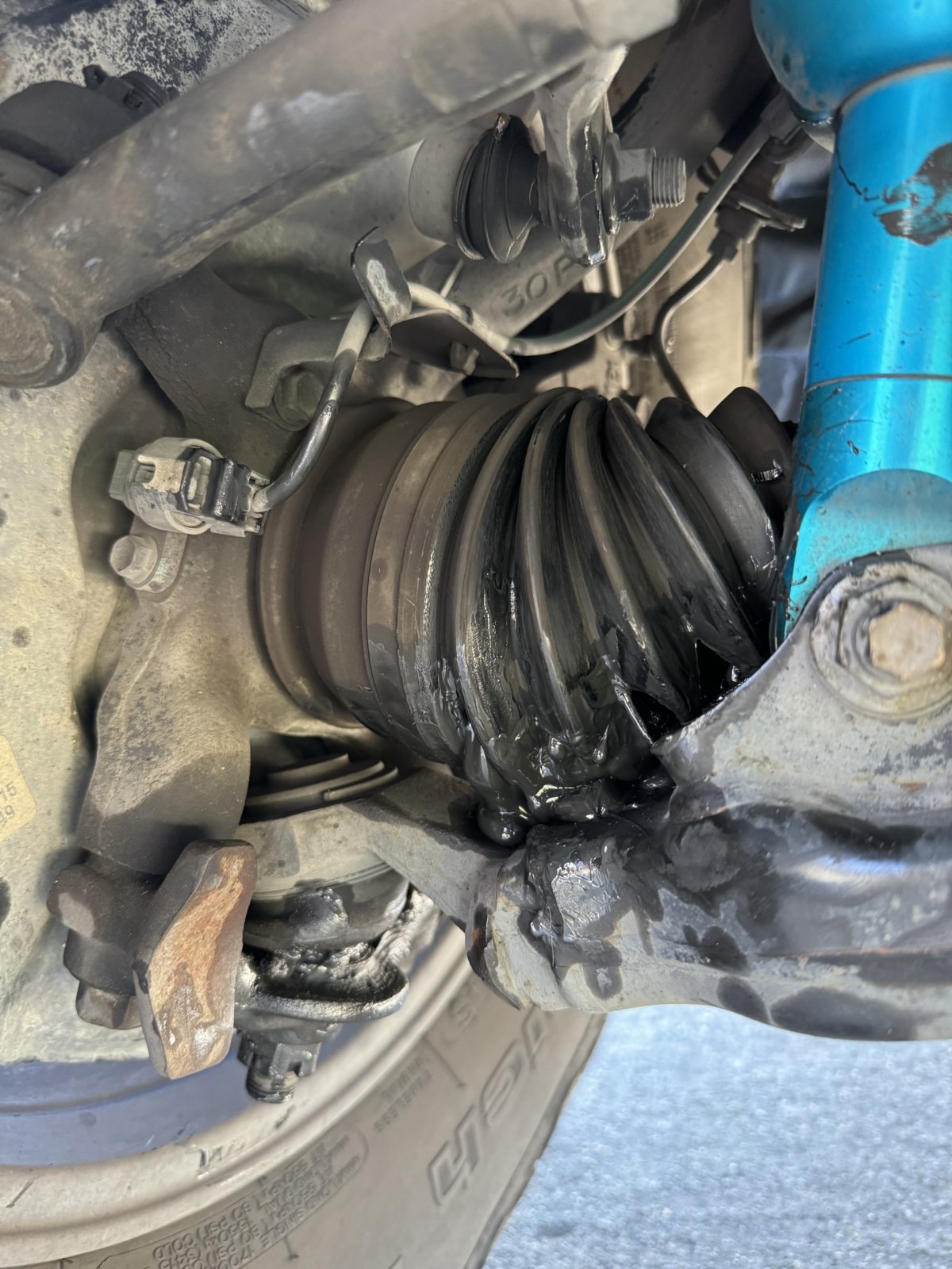

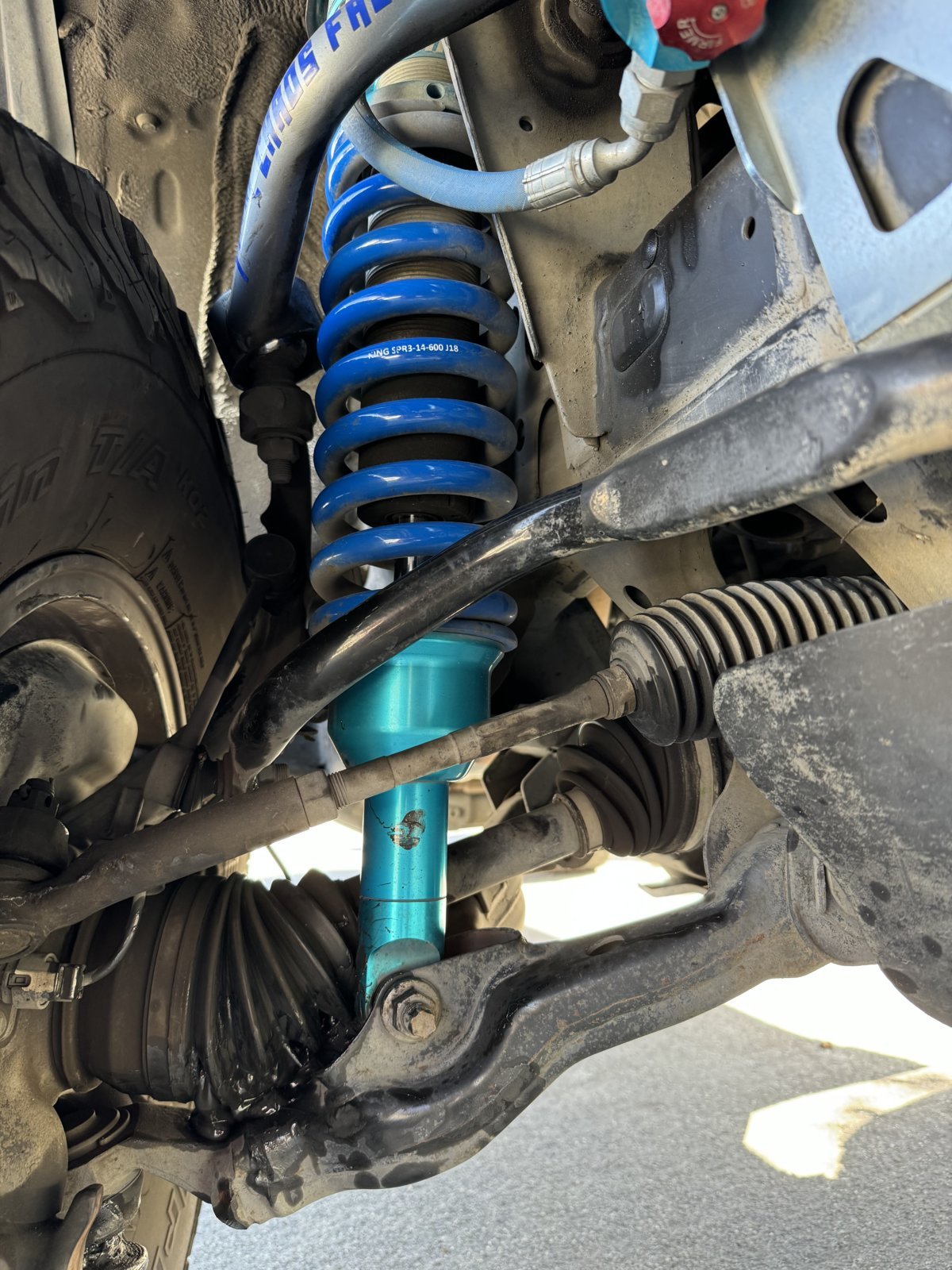

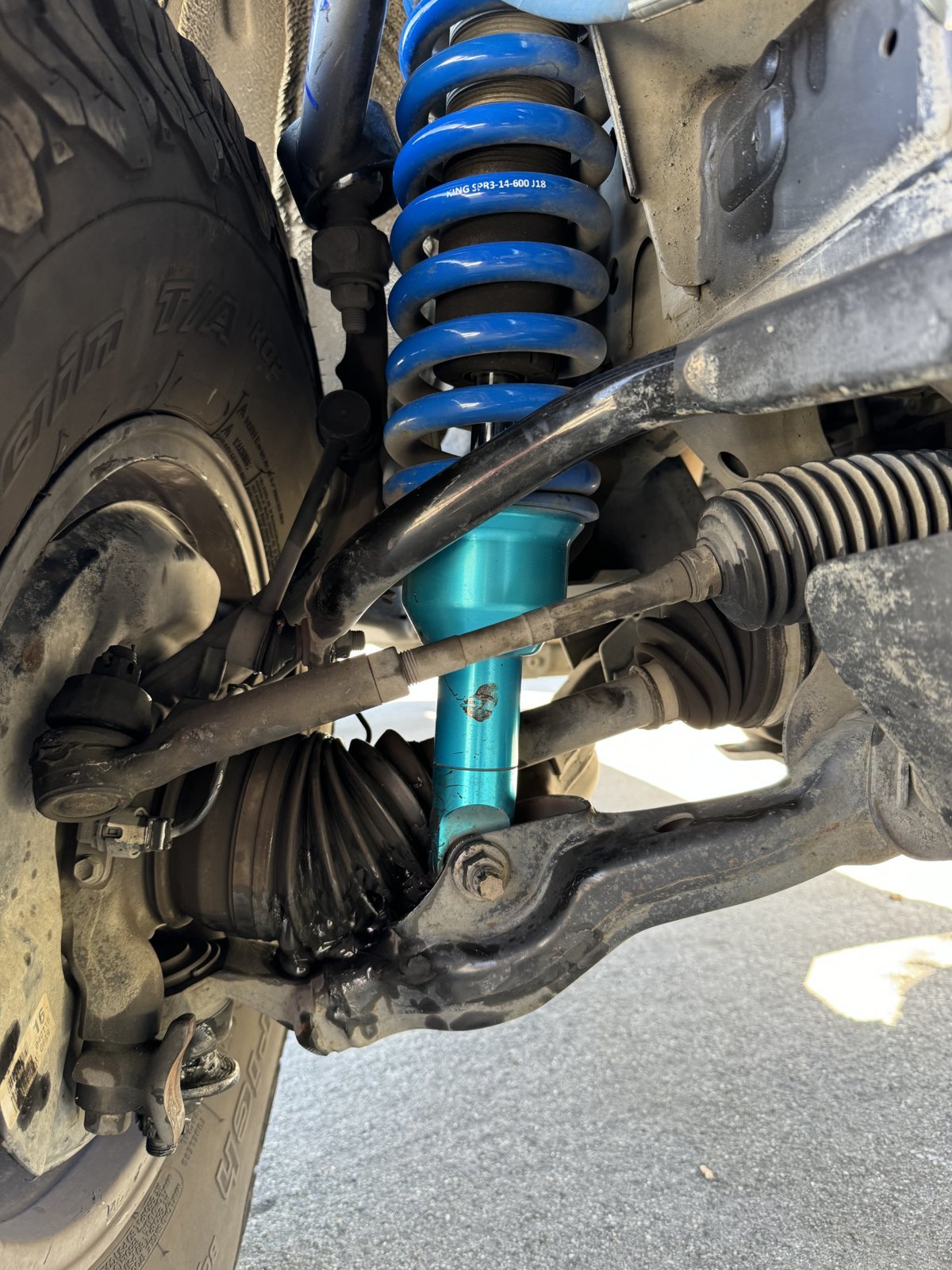

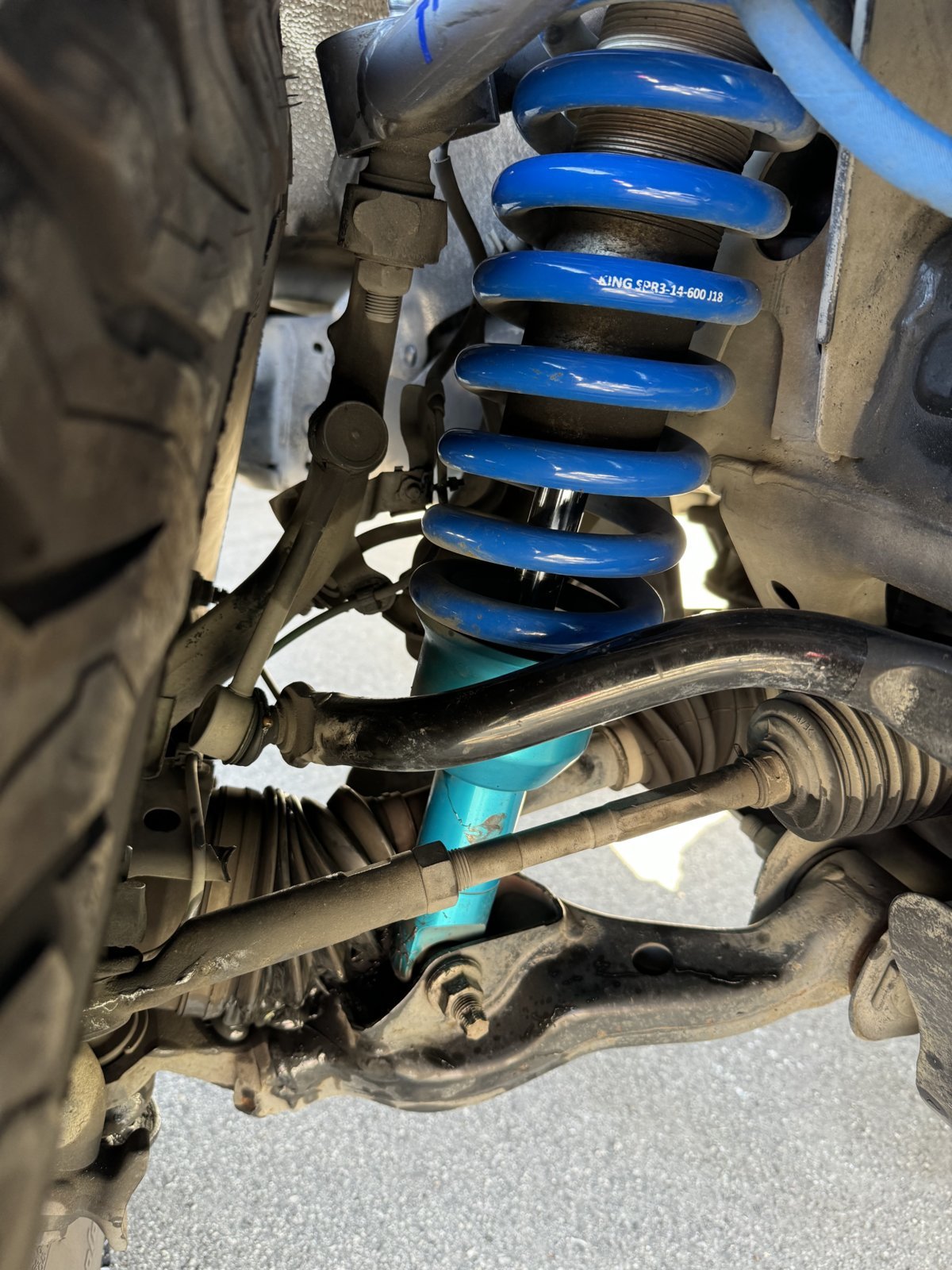

    J'sBeasTRD
    J'sBeasTRD [OP] Well-Known Member
    Jul 20, 2015
    #159922
    331
    Salinas California
    15TACOMATRDOR 4X4DCSB6SPD...

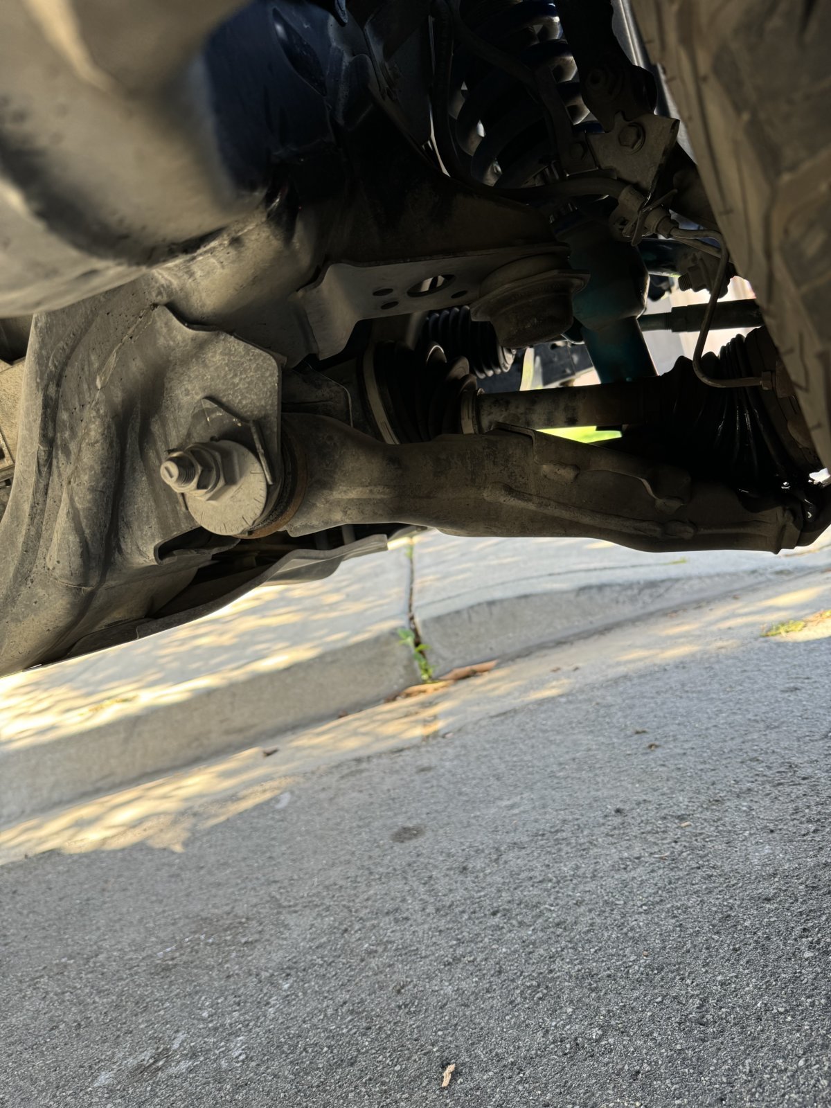

    At this point I’m starting to believe is more than one component that’s damaged IMG_0451.jpg IMG_0449.jpg IMG_0441.jpg IMG_0443.jpg IMG_0450.jpg the boot is leaking grease cause I ripped it open to feel/see if it was broken

    MGMDesertTaco
    MGMDesertTaco Come on, live a little...
    Jan 30, 2021
    #354573
    10,448
    I think the kings and tc uca's are toast. Send them to me and I'll dispose of them.

    kent50
    kent50 Well-Known Member
    May 3, 2017
    #218069
    1,094
    Kent
    Gold River California
    2017 Tacoma Sport DCSB MGM
    3" Lift XD Wheels 33" K02s Predator Steps TRD Oil Cap Backflip Bed Cover Factory All Weather Mats WeatherTech Bed Mat TRD Pro Shift Knob Vinyl Air Bag Decal Covers Vinyl TRD and Tacoma Inserts Factory Mud Flaps Factory Remote Start Factory Door Sill Protectors Console Organizer and Tray Pro Fogs Grill Mounted LED Light Bar TRD Faux Grill DeBadged TRD Sport Door Emblems Factory Bed Lights Pop Lock Tailgate Lock Rear USB Ports DIY Power Panel
    The lower ball joint and the tie rod both look to be way off. If I had to guess, I would say the lower control arm is bent.

    #48
    OldSchlPunk
    OldSchlPunk A legend in my own mind!
    Feb 13, 2022
    #390091
    5,591
    Rich
    East Central Wisco
    '17 OffRoad Silver Sky Metallic
    Small lift, slightly oversized tires, well...
    It would've ripped if it were broken. You just cost yourself more repairs.
    My guess is spindle and upper control arm.

    Ricardo13x
    Ricardo13x YT: @UrbanOpsOffRoad IG: @urban.ops.offroad
    Feb 9, 2020
    #318785
    2,932
    Upland, CA.
    05 OR DCSB ProRunner(4x4 conv.), Chevy 63”s, NWF EcoCrawler, 35”s
    Random stuff. Oh! and converted to non ADD 4x4.
    As I mentioned early on, That spindle it’s fucked. Compare the sway link angle on ps to ds.

    I have seen uniballs fail and many spindles messed up but I have never seen an LCA or UCA bent from trail damage.

  14. Jun 14, 2024 at 6:45 PM
    #54
    clenkeit
    clenkeit Well-Known Member
    Apr 30, 2019
    #291841
    2,492
    Colin
    Lakewood, CA
    2010 White DCLB TRD Sport
    Where is the steering wheel pointed? And what’s the other tie rod look like?
    LBJ is for sure fucked. You can easily see the angle is not right. Tie rod end looks iffy too. I’d suspect there’s more damage as well - spindle, rack, possible UCA…
    Personally, I’d get it up on stands and start taking everything apart to assess the situation. This is doesn’t look like the type of thing where you’ll know the full extent until it’s all taken apart.

    wilcam47
    wilcam47 Keep on keeping on!
    Jan 27, 2016
    #176243
    54,881
    Will
    Bourbon state
    Someting wong
    IMG_0451.jpg is that a reflection? Or hole?

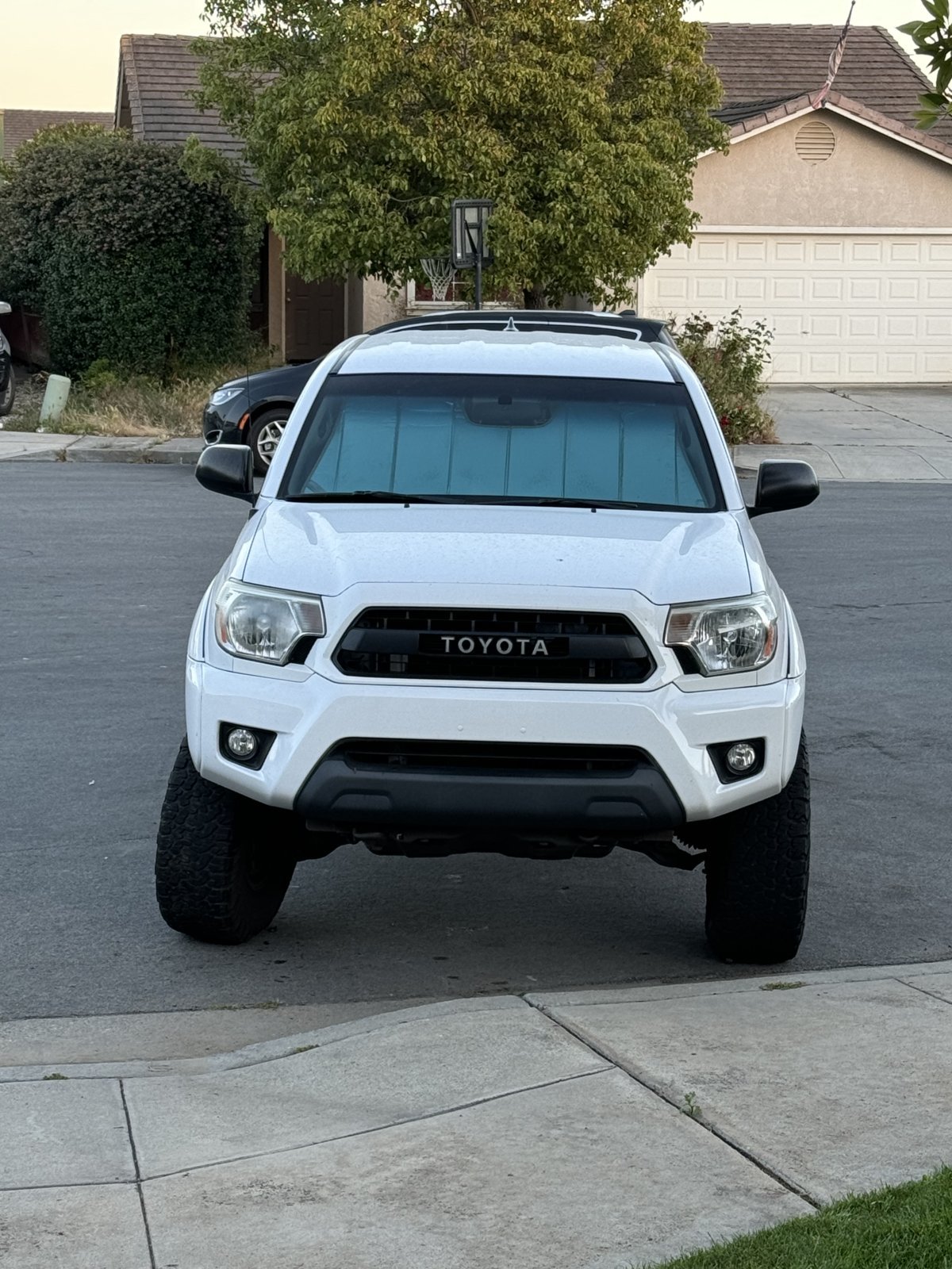

    J'sBeasTRD
    Jul 20, 2015
    #159922
    331
    Salinas California
    The steering sitting perfectly centered here’s a shot from the front of the truck

    J'sBeasTRD
    Jul 20, 2015
    #159922
    331
    Salinas California
    That’s just the shiny uniball on the uca
