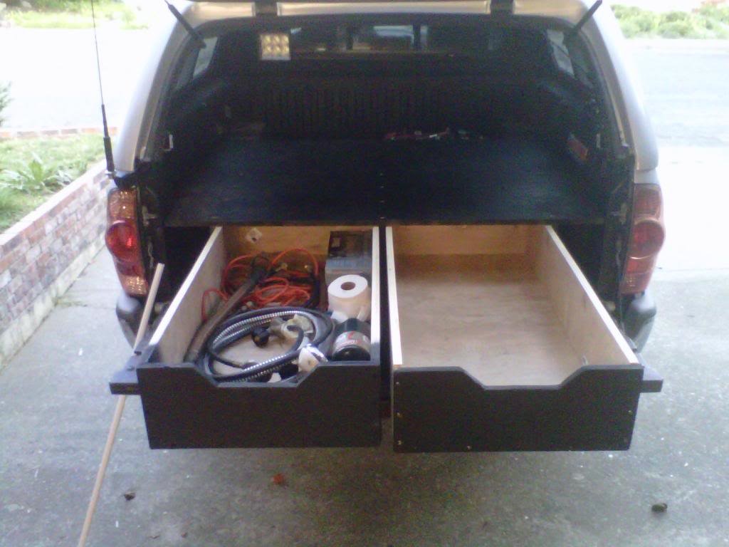

    This is all I have for now...

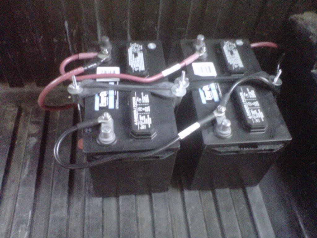

    2 batteries at the front of the bed. They run the fridge and the 2M radio.

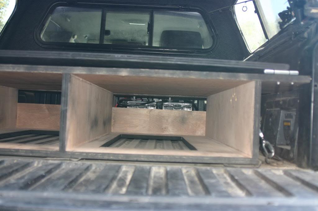

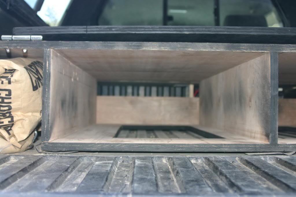

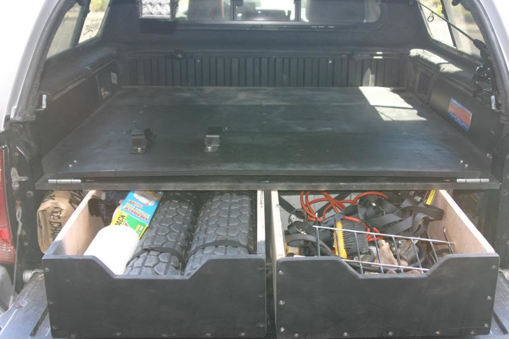

    heres some more pics, hopefully this helps ya.
    You can see the top of the 2 batteries
    Eventually there will be a water tank forward of this drawer

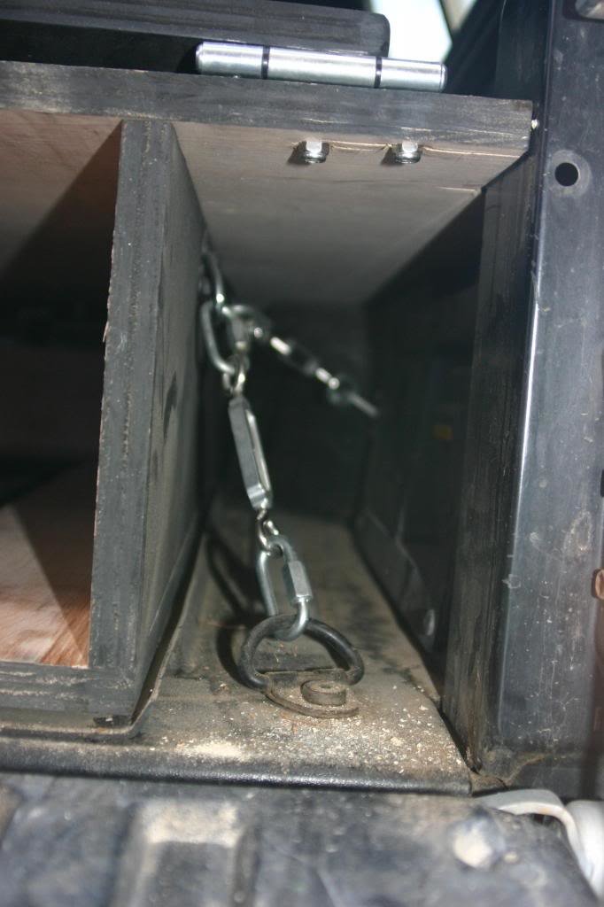

    Turnbuckles to keep the setup locked down
    Everything is made out of 3/4" birch plywood. I did not use sliders for the drawers because, lets face it, I'm not using them every day.

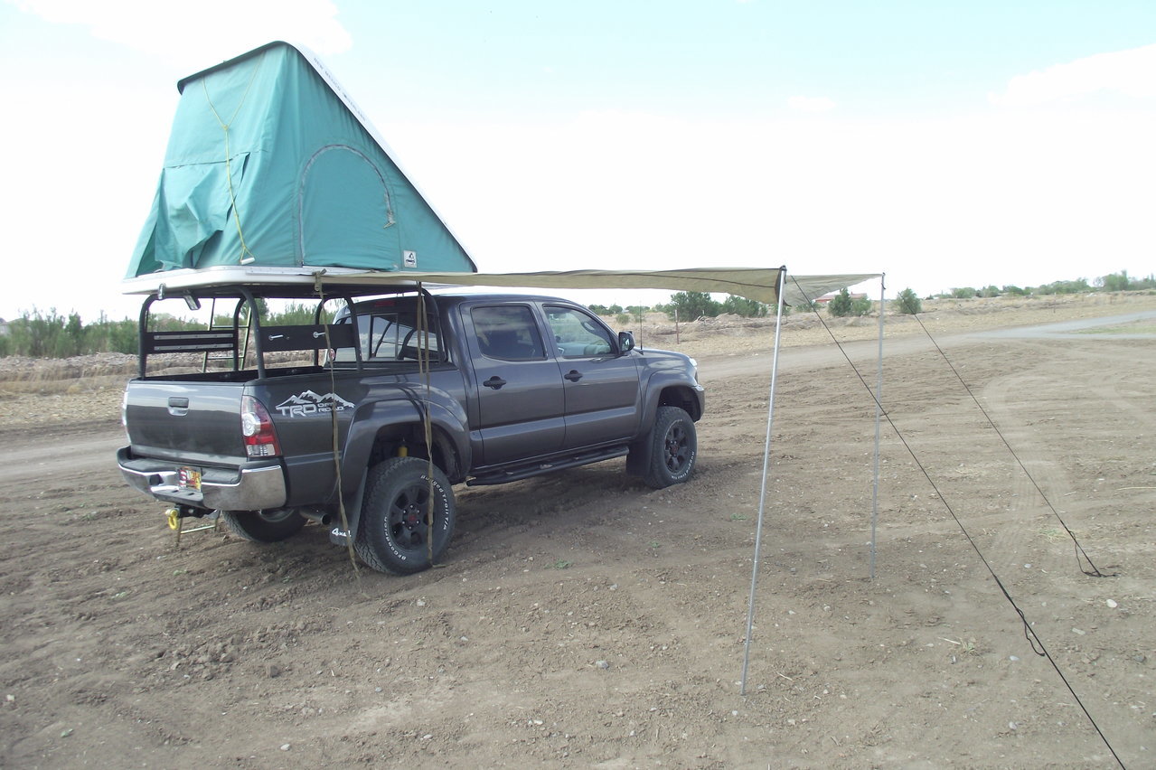

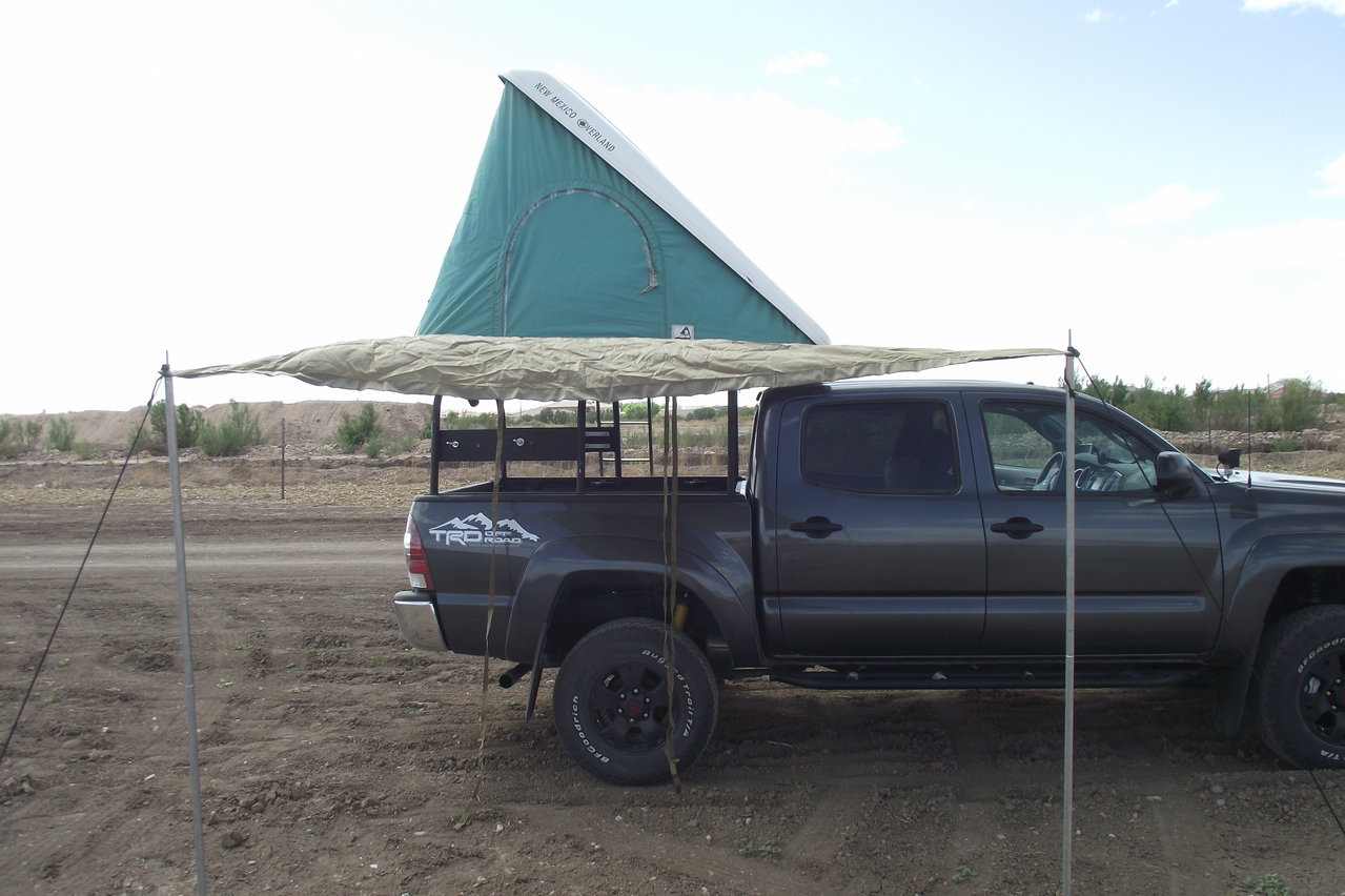

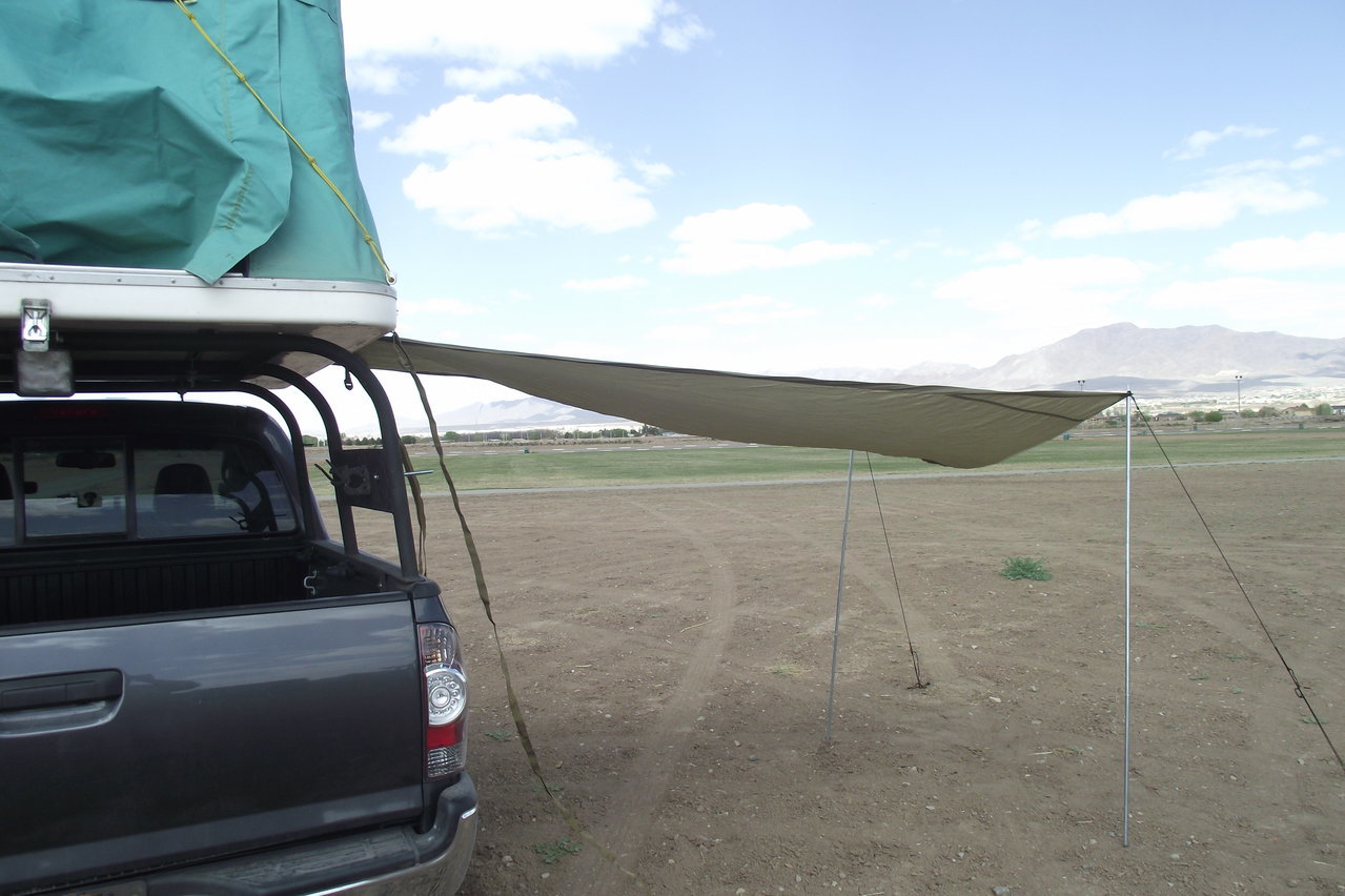

    I finally got the bed rack,RTT & awning set up finished.
    Awning track to hold awning, I have it mounted on three sides of the RTT

    Just curious, why (2) 12v batteries? Was (1) not sufficient for your needs?

    I'm sure 1 battery would have been enough, but I'd rather have 2 and never need the second one. The batteries are rated for 115 amp hours each, but I dont expect that to be a realistic figure, between the 2 I'm guessing 175 amp hours. In the future I plan on adding a water pump and some other stuff that will put more of a load on the batteries, at that point I will be glad I have 2.

    Cool. Watcha using to charge the batteries?
    I've got (1) 96AH deep cycle battery with a CTEK 250S Dual DC-DC charger. It's got an integrated MPPT solar controller. I've got (3) 25 solar panels to throw on the roof rack. I believe this will suite my power needs. Going to get a fridge sometime in the future and hope to have a dual band radio setup soon. :) I'm having a hard time finding time to get it all installed, but hope to soon. :eek:

    For now I have a switched solenoid to the alternator, power to the switch is on ACC so if I forget to disconnect the solenoid it automatically shuts off when I turn the truck off. At some point I will ad solar to the setup, but that wont be until get myself back down to So Cal.
