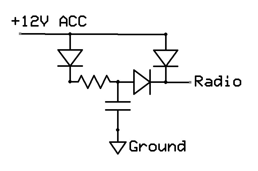

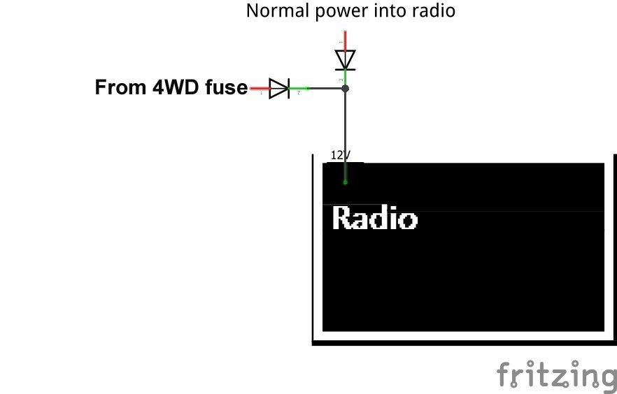

    Here is the problem. I come to the truck, turn on the radio. It takes about 5-7 seconds for the radio to reboot and show the backup camera screen so I plugging the phone and now I ready to roll. I'm starting the engine and guess what - radio is rebooting. Wait few seconds ready to roll back, mess up with clutch and truck is stalling. Cranking it but now backup camera is gone again and screen is not showing the image while the head unit is rebooting for the next 5-7 seconds. Pisses me off.
    This was discussed in thread Radio unit rebooting on cranking
    The solution was per @mechanicjon diagram to power the radio also from IGN circuit and separating both ACC and IGN circuits using diodes.
    So this is what I did (but read it to the end for the outcome).
    Here is the radio unit I am talking about installed in my truck.
    First I disconnected the negative power from the battery. I don't need my 22 years old airbag to explode. Then i removed the radio to have access to all connections.
    A bit history here: The radio I installed came with standard wire harness, which of course did not match Toyota harness. So I bought another harness that on one end plugs into Toyota vehicle harness and on the other end to standard harness. So stupid or not, I had two harnesses connected in series. The good thing was there is a lot of room between the radio and airbag sensor unit just behind the lighter and ash tray, so all wires are in there.
    The other thing that made my life easier. Factory radio has dimming feature, meaning it will dim when you turn on the lights in the truck. My new deck doesn't have dimmer connection so original green-brown wire was not used. When I installed the radio I just cut the wire of the factory harness plug (I used this wire to power something else) so I had a pigtail sticking out of factory plug.
    There was a matching orange wire in universal harness, which I did not connect to anything then.
    Now I can use all that. So first I had to connect some wire to pigtail. I have a rule: I do not do soldering in my cars. In my experience soldering connections are getting rusted and breaking off. So I do only crimping connections. So this is what I did
    Now the green wire will be my alternate power source, and will be connected straight to the 4WD fuse pigtail I left, when I was installing DRL (4WD fuse in my truck poweres only my custom DRL and all 4x4 stuff in my truck is manual). Here is the green wire now installed in the factory radio connector (black heat shrink tube is over the crimped pigtail connector)
    I already had additional loom going from the radio compartment to the left side kick panel with some wired I did to make my truck legal in Poland (rear fog light) so one more wire will not make difference.
    That loom is going along other factory wires under the steering wheel behind the kick panel. You can see the green wire hanging down on the left side - not connected yet. Yes, my truck has few more wires under the dash and I am not finished yet :).
    That green wire will be connected to the red pigtail I left that is powering my DRL which is behind 4WD fuse.
    Now some work on universal wire harness. On the picture below you can see the radio wire harness with two black connectors on the left and universal wire harness on the right. The connection between these two was done with crimped wire connectors (all these red and blue tubes). I have already cut red wire to red wire (the radio ACC power) and the orange wire (my new backup power) is still with crimped on connector. These are the diodes I am using: 10A/1000V (measured voltage drop is 0.55V). The short peek power these diodes can stand is way over 100A - more than fuses can handle. Of course I will use only two diodes, I bought 5 just in case.
    Now in the picture below diodes are connected (crimped). Power comes from the left and it is going to the radio to the right.
    Now exposed wires are wrapped in tape and the new modified harness is ready to be installed in the truck.
    No need to show installation pictures, basically all went back in place. Now the fun part: does it work?
    First I connected the negative battery hoping my truck will not start releasing a blue smoke and airbag will stay inside the steering wheel. OK so far so good.
    Then I tested everything making sure all items I might touch still work as it should, making sure I did not screwed up. OK, so far so good.
    Next power test. I put a key into ACC position and waited for the radio to boot up. After that I turned the key to Start position but because I did not press the clutch the starter did not turn, but radio stayed on. Good, my alternate power works. So far so good.
    Final test: I pressed the clutch and started the engine. The "word" slipped out of my mouth when I watched the radio going dark and started to boot up. Not good. It confirmed what @DrZ wrote:
    It is confirmed, the voltage drop during cranking is below the threshold radio requires to run. So I need better solution. But all it is not wasted. All work I did is good. What I need is just alternate power source instead of using car battery when cranking.
    What I'm thinking is small PiFePO4 battery pack that would power the "green wire". Of course the battery pack would require some charging circuit and allow to discharge only when my 4WD power is on (In my case allow to discharge only when charging at the same time). All that now can be done under the kick panel without removing the radio as I would need only green wire and 4WD power.

    Measure the amperage draw on that wire. I'll figure a capacitor size that might work.
  7. Aug 18, 2017 at 2:17 PM
    #87
    RysiuM
    RysiuM [OP] Well-Known Member
    Oct 18, 2015
    #167004
    2,710
    Rysiu
    Was Golden State, now Poland EU
    1995 4x4 LX Ext Cab, I4 2.7, MT, 335K miles
    DD Deck+backup camera, LED DRL, All LED except H4 Hella
    I did not measure but I would think it is probably around 1 or 2 A. For cranking time maybe 1-2 seconds I would need let's say about 4 joules. In order to have it at reasonable voltage I may need at least 10F or more. It is just only capacitors in that range (and able to deliver few Amps) are for 3V, so I would have to get at least 6 in series. This actually could work with charging circuit way easier than with batteries. Is this what you are thinking about?
    The only thing is that such capacitors are still quite big and bulky (2 to 3 times of the size of the battery). The best solution would be just plug it into dual battery setup.

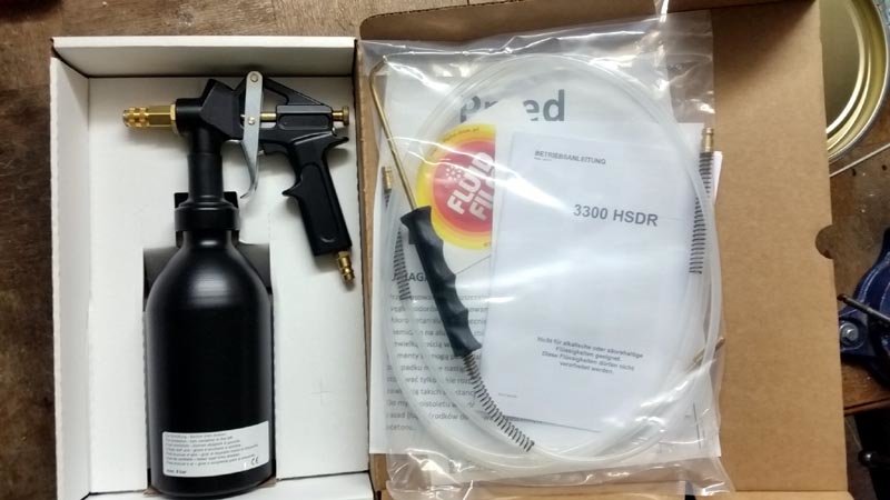

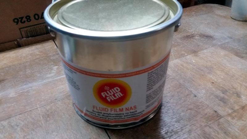

    Today the UPS truck stopped by to drop me a package
    This time I did not get spray cans. I figured out it is too expensive. For the half of that price I got a can of the same liquid in 3-litter can
    to be applied by a spray gun
    The cost of the spray gun returns after two applications so it is much more cost effective. I decided to use spray cans for ad'hoc applications and spray gun for general maintenance. Now I need to get few days of nice weather to coat both trucks before the winter starts for good.

    Frame treatment day two. Applied fluid film (generously :))
    I used my new spray gun and 2/3 of 3 litter can of Fluid Film NAS (the same stuff that is in spray cans just 2 times cheapper). Actually with the wand provided with the gun the spraying is much easier than with the spray can. I just need to fine tune the air pressure and mixture adjuster, so I don't create such heavy blobs.
    Now I need to do the same with my 2012 4Runner (Bismarck), so I bought one more 3-litter can of FF NAS. I still use spray cans for some touch-ups when I find untreated spots, but for general spraying I'm going to use only NAS.

    I hope my Tacoma will not be angry with me for putting non-Toyota parts on it o_O. Following the thread Windshield Sprayer Upgrade during my last trip to USA I bought and now installed Windshield Sprayer Odyssey nozzles. Took 10 minutes including checking all my sprayer lines. This is big difference indeed. I'm not saying that the factory nozzles were crap (they served me well for over 20 years) just Odyssey nozzles are more modern.
    I have also bought a check valve as I had problem with fluid withdrawing, but I have not installed it yet. I don't know if this is coincidence or something got fixed on its own, but now I do not have the fluid withdrawing problem. The spray is right on. Strange.
    While in USA I have also bought polarity switching LED for my marker lights. Now waiting for some connectors from China (ebay) so I can install plug-in relays for white marker / orange blinkers functionality in my corners. If it works as I'm expecting I will put the same setup to my Bismarck (4Runner).
    Finally I have replaced rheostat with electronic dimmer. I had some electronic circuit that was using the rheostat and working with all LED dash lights, but I never liked that solution. Replacing the stock rheostat with original Toyota electronic dimmer is much cleaner solution. All that is written here: https://www.tacomaworld.com/threads/dimming-led-dash-lights.546723/

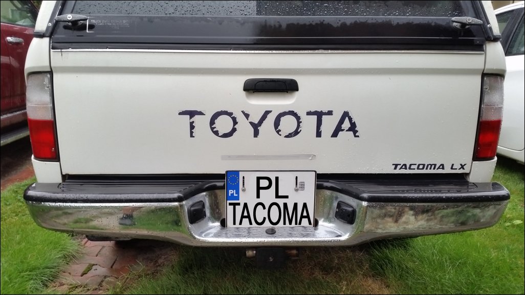

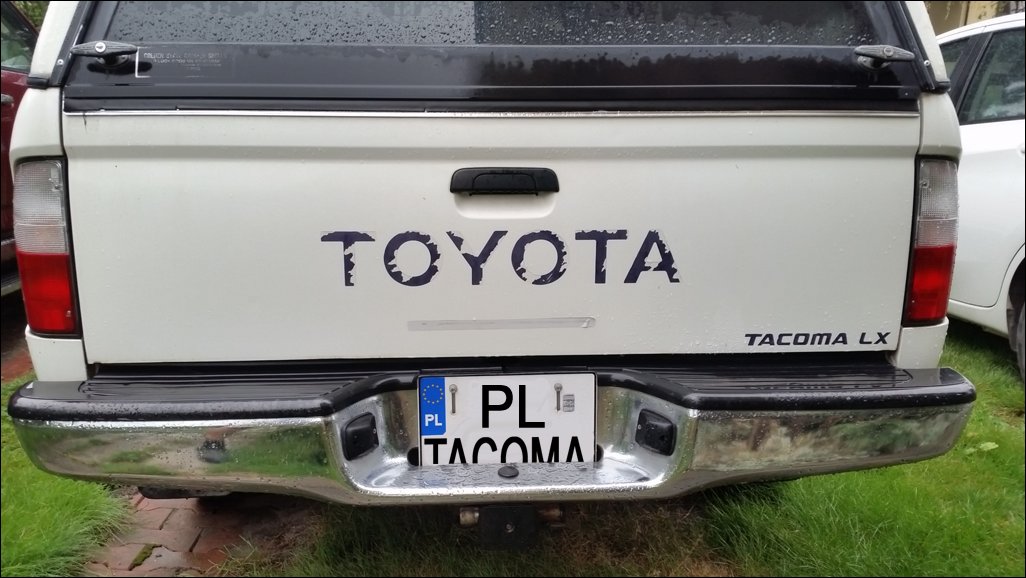

    I wonder if anyone noticed the white tape I have under the "TACOMA" on the tail gate.
    It is not for decoration or masking some rust but it really has a paint protection purpose. You may already noticed a black horizontal line/mark on that tape. It came from my registration plate. This is because Polish plates are quite bigger than USA, so they don't fit well on step-on bumper
    There are two sizes allowed in Poland: either the same height as US plates but about 50% longer or the same width as in USA but about 50% higher. Neither will fit into my stock bumper. So I decided to use "square" plate on the back of my Tacoma. For legal driving all letters must be visible so I'm driving with the plate sticking up like on the picture above. Of course it is way to tall to open the tailgate.
    So how do I open the tailgate, you may ask. Notice that the license plate is mounted with two bolts, but instead of the round hole in the plate, there is a long slot for each bolt allowing the license plate to slide down through the slot behind the bumper.
    In the position shown on the picture above I can safely open the tailgate. I just need to make sure that after closing the tailgate I will push the license plate all the way up before I drive (Yes, I did forget few times, but was lucky to not get pulled over before realizing it and fixing my plate on the next traffic stop).
    And of course sometimes I'm to lazy to push the license plate down before opening the gate, so the gate is pushing the plate down. So here is the tape protecting the paint of the tailgate from being scraped by the top of license plate when it happens. And as you can see from the marks on the tape, it did happen many times already.
    Really the only good solution to license plate problem is either replacing the bumper with something I can bolt the "long" version of license plate to, or wait till authorities will make the USA-size legal in Poland. USA-size is legal in few EU countries already, so maybe they will make it legal in Poland too. I don't want to throw away perfectly good bumper (zero rust, and no dings), so for now I'm keeping my "sliding license plate" solution.
    At some point when my bumper will go bad (either from someone rear-ending me or giving life to rust) I will put an "off-road" plate type bumper to discourage happy drivers from running into my ass, and also to put some backup lights I have in the box (they are a bit to big for the bumper I have now). Some day...
