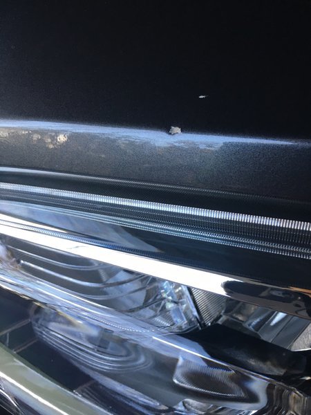

    not two days after I drove 1500 miles to swap my hood for a scooped hood, I apparently get hit by a boulder on the highway. I didn't see/hear it happen. Just saw the aftermath. This is the bend on my hood just above the headlight. It is about the size of a kernel of corn but it is definitely dented, not just a paint chip. I am going to pick up some MGM touch up paint from the dealer but what can be done about the dent?

    PDR should knock it out easily. Then use some toyota MGM touch up to build back up the chipped out area. Normally I would then wetland and buff/polish, but being on the edge is not good!

    Don't panic.
    You'll get more. It's called road rash.

    What is PDR?

    Paintless dent removal.
    Success depends on the techs skill and access to the location from behind.
    Worth an estimate, but it will still need touch up.
    You could hide it behind a bug deflector if you like those.
