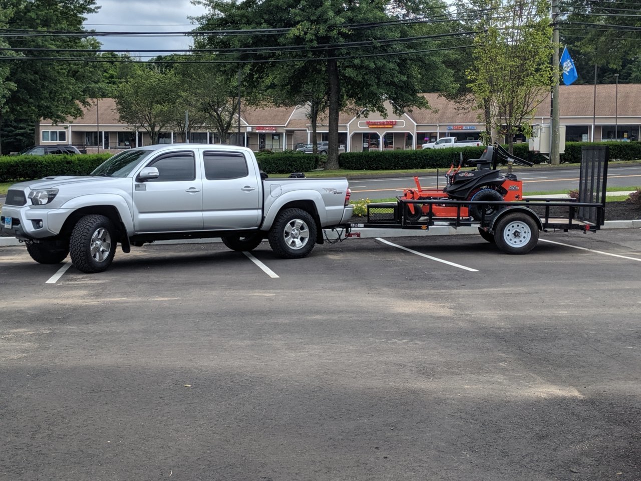

    I have a 2012 dcsb sport. Already have the timbren offorad bump stops installed. Rear squats and ride of course is rough. Basically riding on timbrens.
    The truck is my commuting MV. So need a good ride when not hooked up still. Trailering is mostly local doing some lawns.
    Other than buying a tundra what are some ways I can fix this issue. Thanks in advance

    Get some firestone helper air bags probably the most economical without going to a different leaf pack and getting some lift out of it.

    I have them and they are awesome. 900 pound quad in the bed and a 1500 pound Yamaha on the trailer and no squat whatsoever.

    What do you have in the back of your truck? That doesn't look like near enough trailer/load to make your truck squat.
    Either way, moving the mower back a foot or two to center it over the trailer axle will help.

    I would move the mower back the whole thing is almost in front of the axle. That's alot of tounge weight.

    I was thinking same. Just got the e-track trailer tie downs. So can move it further back with a set of straps to hold it to the floor. Will move it back a foot next time.
    Part of me is thinking the 130k mile rear suspension is showing its age. Unless the trd sport shocks were softer than others.

    Has the TSB on the rear springs been done?
    Or did that even apply to sports?
    At 130 I'd say a new set of rear springs may be in order. Maybe new shocks too.

    Alcan spring has worked flawless for me in the past. Might be a worth while to give them a call.
    Other options:
    Load distribution hitch.
    Air bags are such a PITA over the long run.

    The simplest solution is usually the best, just make sure you still have a bit of tongue weight for stability.
