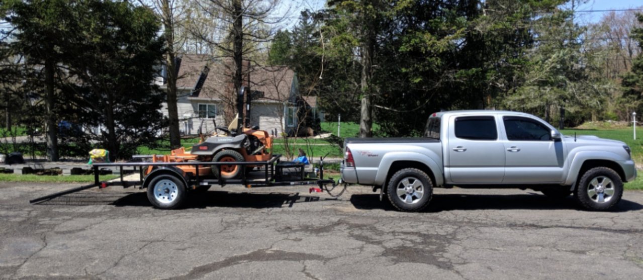

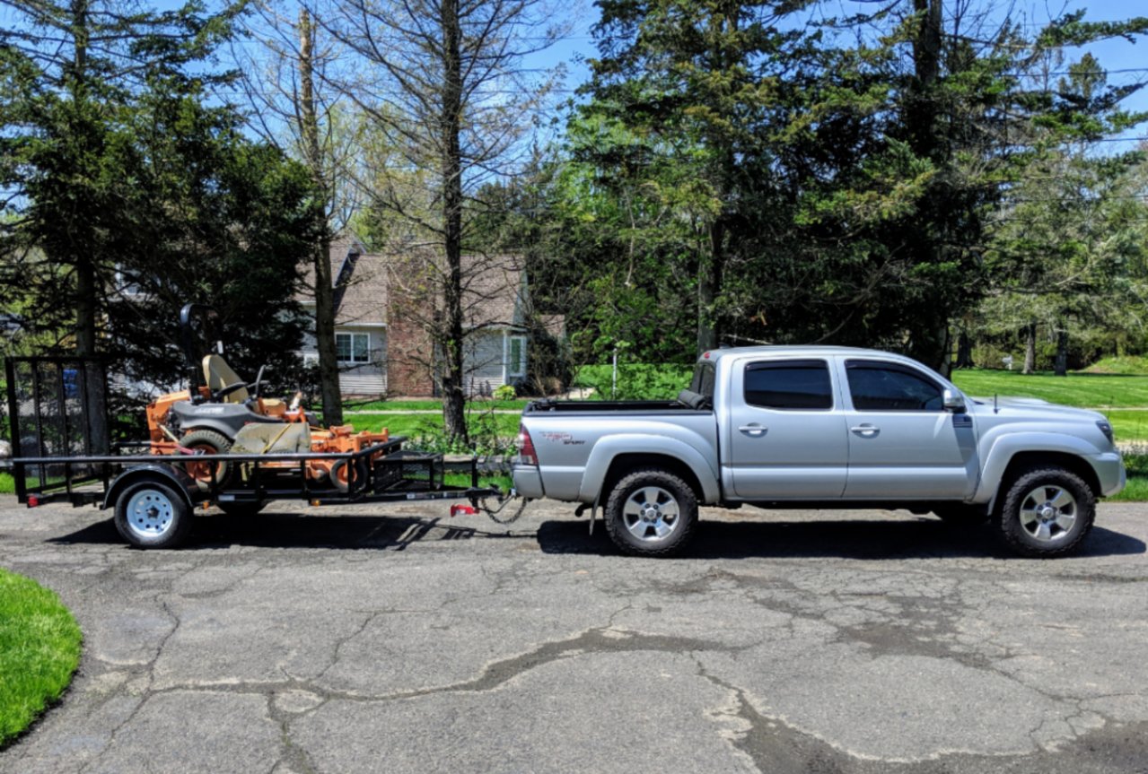

    Here are two more loaded. Different machine. However one has tailgate down. Will get a empty shot when I get out of work
    In these pics the driveway is bumpy so parts can be deceiving a bit

    I dont think it looks bad. I'd just shift that mower back 18 inches and I think you'll be in great shape.
    EDIT: Moved back 18 inches from how you have it on the bottom picture.

    Airbags are just a bandaid to the bigger issue. You have crappy stock leaf springs and that load is not properly distributed. My truck barely squat in the rear with stock springs when I had my trailer hitched up and the weight distribution hitch set and the tongue weight in my trailer is 600lbs.
    I'm running Dakars with the 3rd leaf removed now (same as the newer regular duty Dakar). The truck sits nice and level even when loaded up.
    First pic is with the WD hitch set and second pic is without the WD set....this is with a 5,500lb trailer and 600lb tongue weight.

    Center the mower over the axle. Less weight on the truck

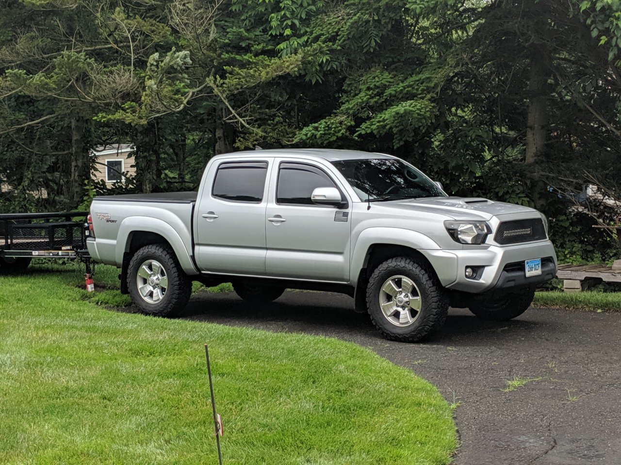

    Here it is unloaded and not hooked up

    Your trailer's load looks to be way too far forward.
    Before I load my mower onto my trailer, I hang something off the bumper or tailgate, like a rope or ratchet strap, to where it is a couple inches off the ground. Make sure you can see it from the mower when you're driving it onto the trailer. Pull the mower forward until the rope/strap touches the ground then stop and strap the mower down in place. This will ensure an adequate amount of tongue weight without over loading your rear suspension.
