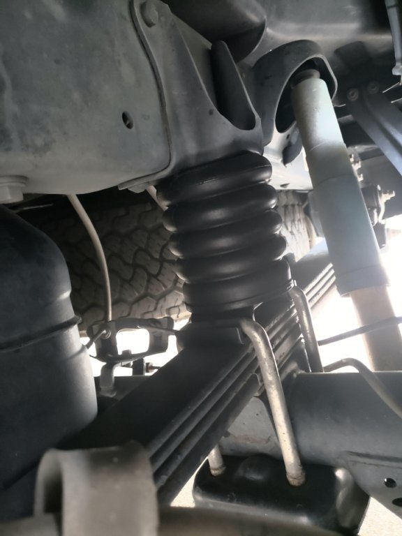

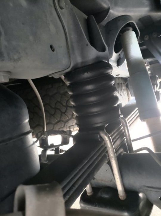

    I have Sumo Springs on mine, and they do well. Easy to install.

    Couldn't get pic to load on my previous post, but:
    SquireMachine85[OP] likes this.
