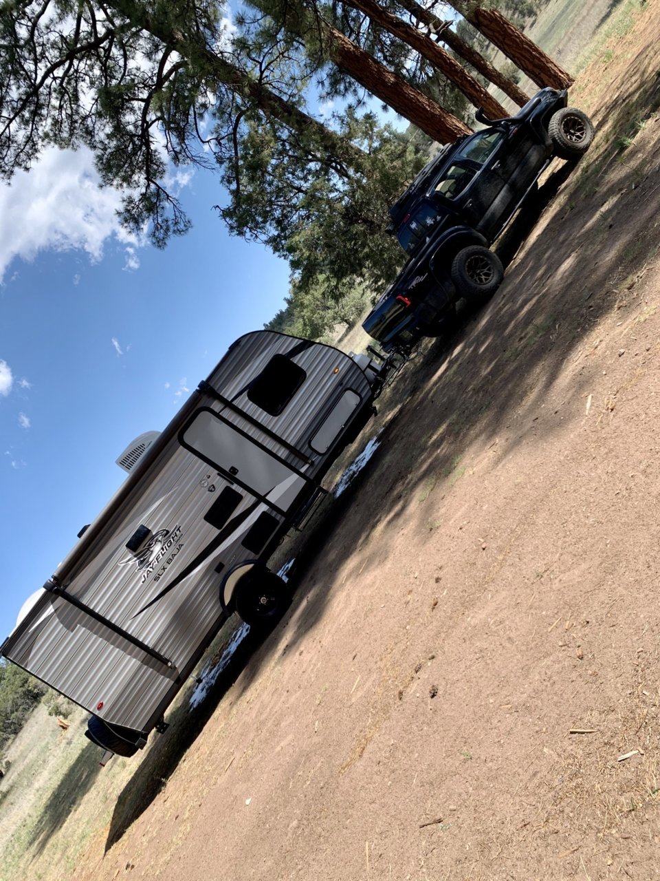

    I just picked up a jayco jay flight 174bh 2900 dry and it pulled great just got back from our first camping trip with it! I do use a weight distribution hitch and a brake controller. Trailer doesn’t even squat the truck at all only a 290 pound hitch weight.
