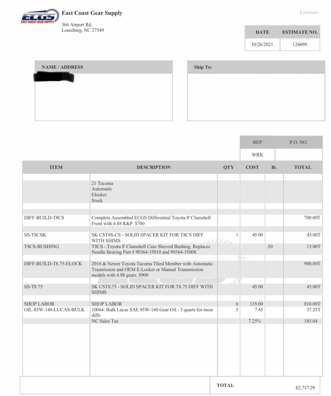

    EGGS quoted me right around 2800 with them doing the work.

    With all their parts? Hell, ill drive there for that work.

    Just over 2700.00
