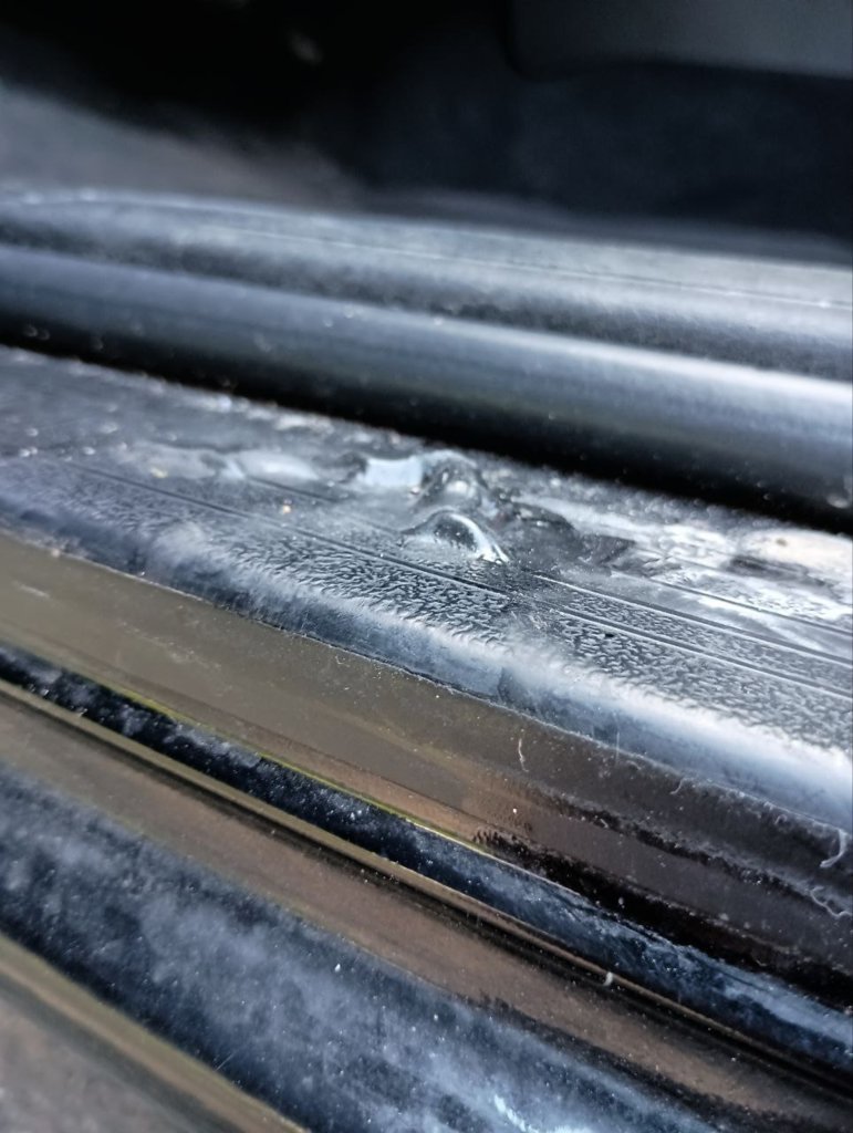

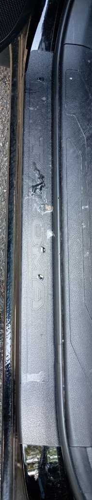

    What could have caused this? is it possible salt caused this?
    I saw this little marks almost looked like glue drips but never took attention last year. Now its like bubbles on rubber. Its definitely not heat because this is the only door, besides the little marks were there last year, i just never took attention thinking it was drip of glue or something
    I pushed it down, it burst a bit and is now pressed down but rubber is torn in some places.

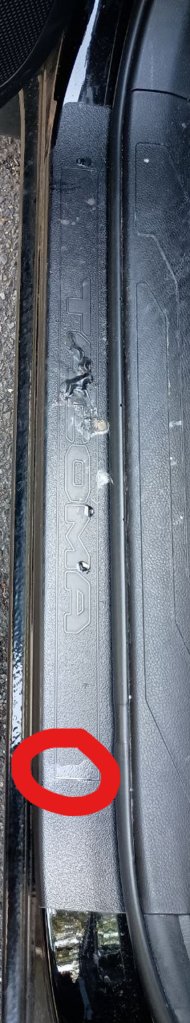

    The red marker is what it looked like last year in other locations , I assume it will bubble there too now

    Use of a cleaner that may be a bit too strong … caustic even?

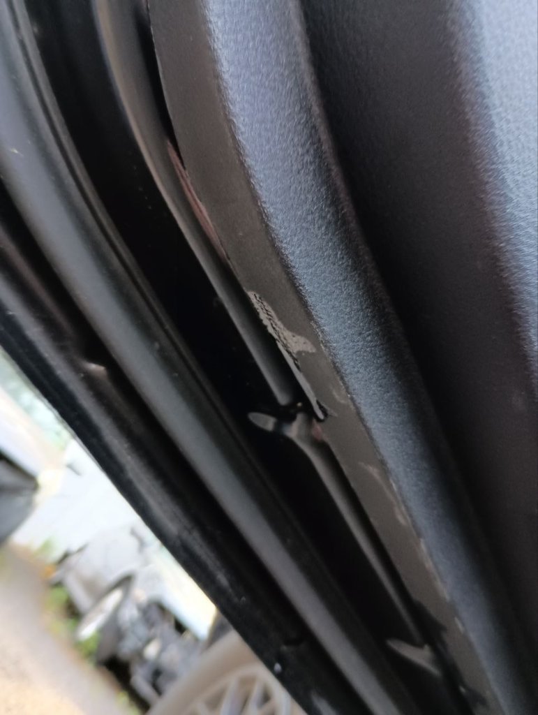

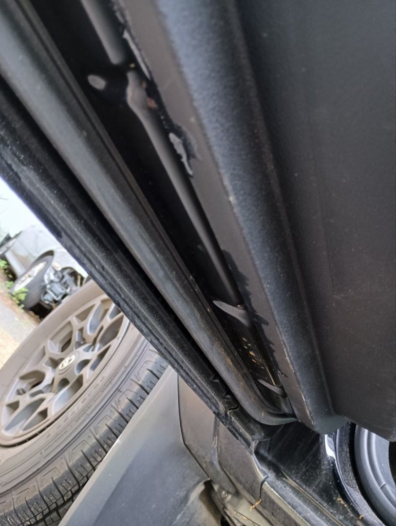

    Its leaking from here, I have no idea wtf this is. Its not water, its almost like melted battery acid or something , smells like plastic and is oily. Its not fluid film, I applied that inside the door panel on steel on all 4x doors and this is the only door with this.

    you fluid filmed inside your doors?
    that appears to be the butyl door sealant. used to attach the plastic film to the door panel to prevent water ingress to the interior.
    more than likely, the fluid film is reacting with it, and breaking it down. not all that different than applying dawn dish soap to an oil spill.

    That's what it is... I had one in the driver side door storage and it seems to have leaked thru that down on the rubber during the heat wave... Too late to mourn now, ill just try to cover it somehow because there is steel beneath it and i dont want rust there
    I checked and even the smell is same, this is the cause
