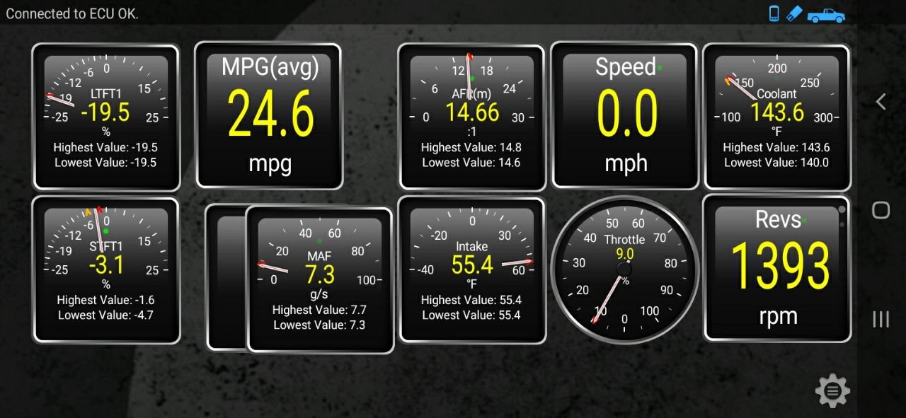

    Just finished replacing the 3 injectors on the driver side this past weekend and my fuel trims are -20%. replaced the 3 injectors on the passenger side 2 weekends ago but the trims were +10% at idle only because I had the throttle body gasket on backwards...... im sure it was fine if i had done it right to begin with...... anywho. what all can cause the fuel trims to be -20%?
    not a leaky fuel injector, i already inspected them connected and disconnected. consistent on all injectors.
    other thoughts are mass airflow is reading more air than what's passing through.
    oxy sensor might be bad but I didn't touch it and it was working just fine before
    it's possible the fuel pressure regulator somehow got a little more clogged after doing the drivers side causing too high of pressure to the injectors. or maybe i shouldn't have used brake cleaner to clean the inside of the fuel rail.......
    the computer/EFI system doesn't go through a learning process after being disconnected for so long, does it?
    any other thoughts?
    I replaced the fuel filter too. The trim gets closer to 0 as the RPMs go up.

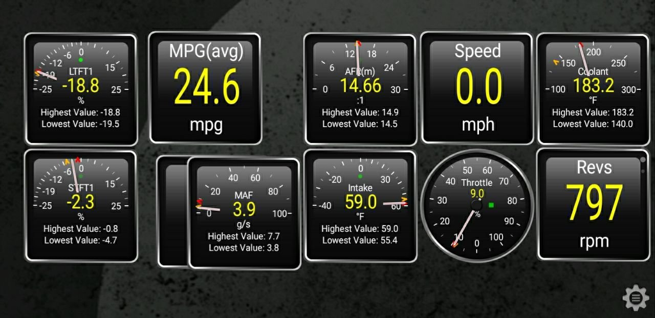

    check for vacuum at the FPR vacuum line at idle. next your observation regarding the MAF might be correct. You can verify this by reading the g/sec of air flow at idle. It should be close to engine displacement in liters so your 3.4 should read 3.4 ish g/sec of air… if it shows much more, say 8 g/sec you need to investigate. If the FPR diaphragm leaks now, it is just a coincidence.

    Looks good to me. it may be a bit high but 797 rpm X 3.4 L / 60 seconds = 45.16g/s. what Idle are you assuming? 600rpm?

    the MAF's g/sec look fine, what I do see is a 40 degree drop in coolant temp just by raising the RPM's? I am assuming that these readings are one right after the other.

    Correct. this is just the warm up process
