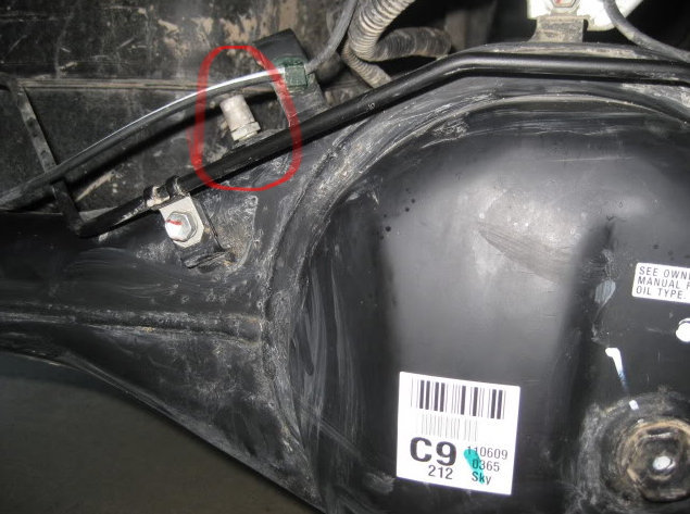

    I have not had this issue but filing this thought away for the future. What does the vent look like and where is it located? Do you have a picture?

    You need to crawl under to see it. Drivers side.
