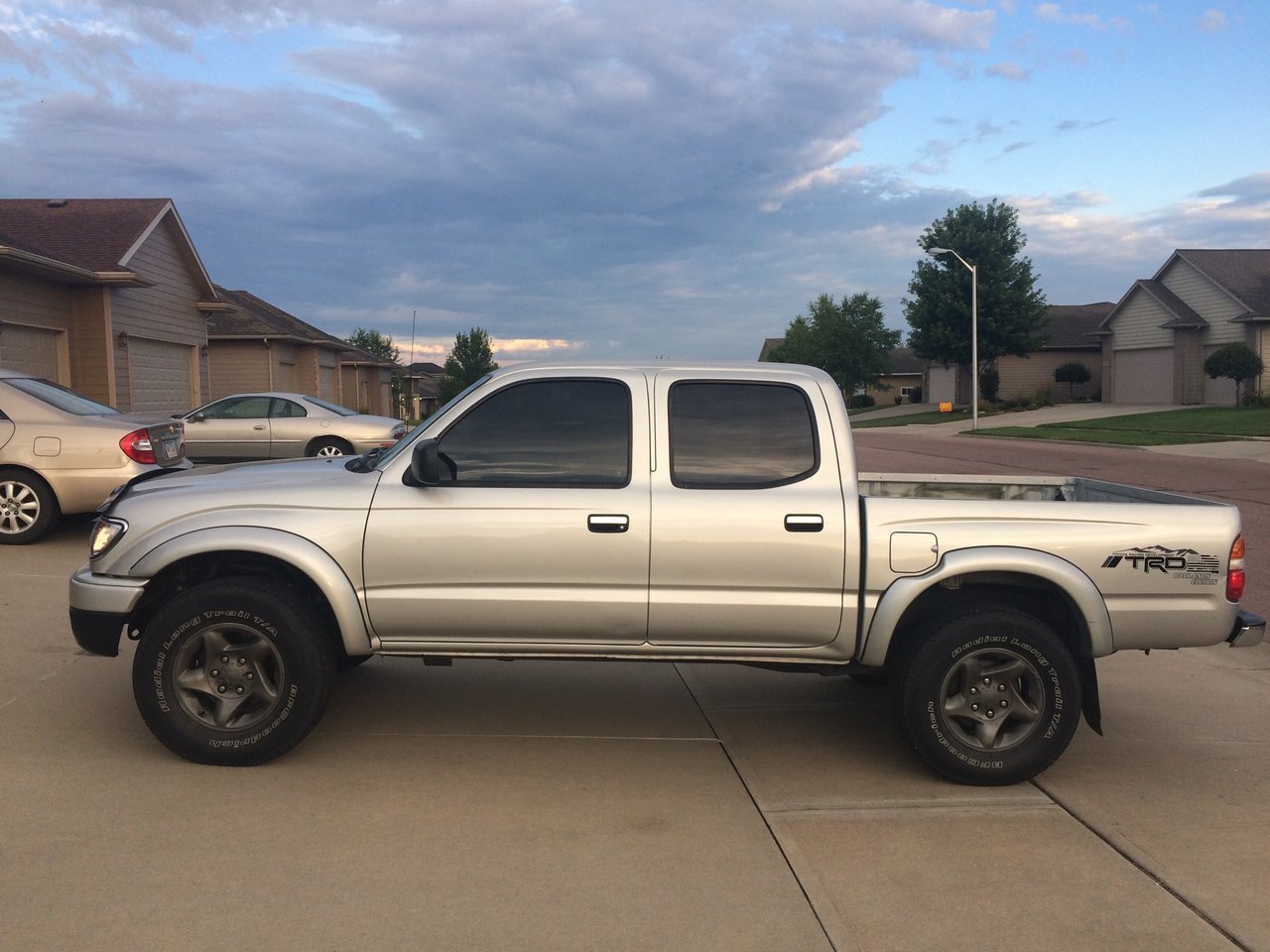

    tacoma alloy wheels. they were a little beat up and I plan on putting different wheels on in the near future but for now I cleaned them up, sanded them a little to give the etch primer something to grab, then etch primer followed by engine enamel. Father in law has body shop so he is going to throw them under lamps to harden them even more but that has not occurred just yet.

    nice looking truck sir.
