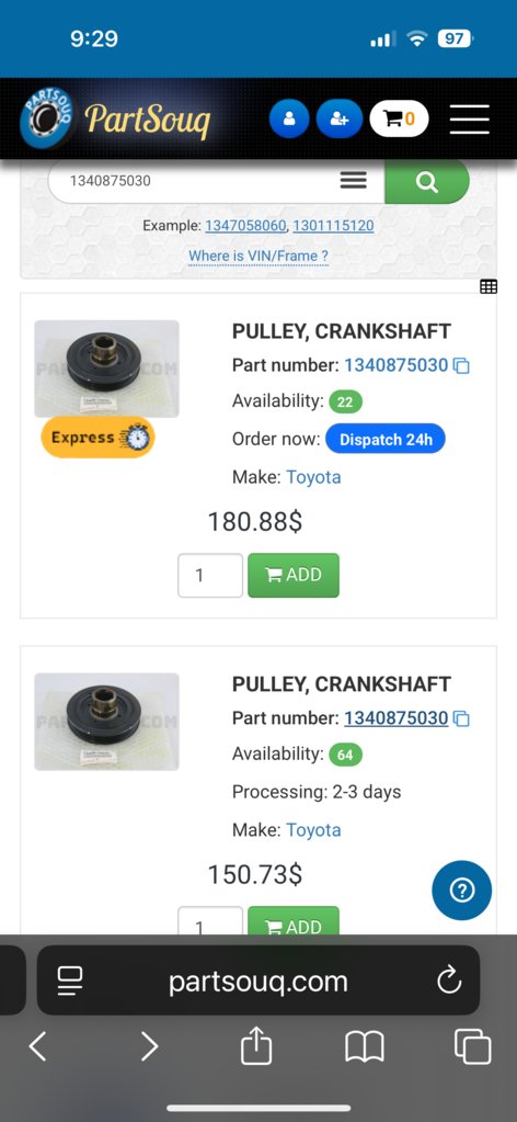

    3rz here…is the HB on 5vz interchangeable? Is it the same part? Every search I’ve done only has the entire assembly that includes all three together as the 5vz part.

    Looks very different in these pics
    https://www.rockauto.com/en/catalog/toyota,2003,tacoma,2.7l+l4,1418442,engine,harmonic+balancer,5512
    I’d put your vin in PartSouq.com and see what you get. OEM for $250 on the 5VZ is like $400 less than domestic online dealer prices.
