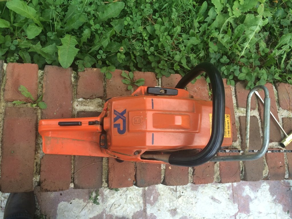

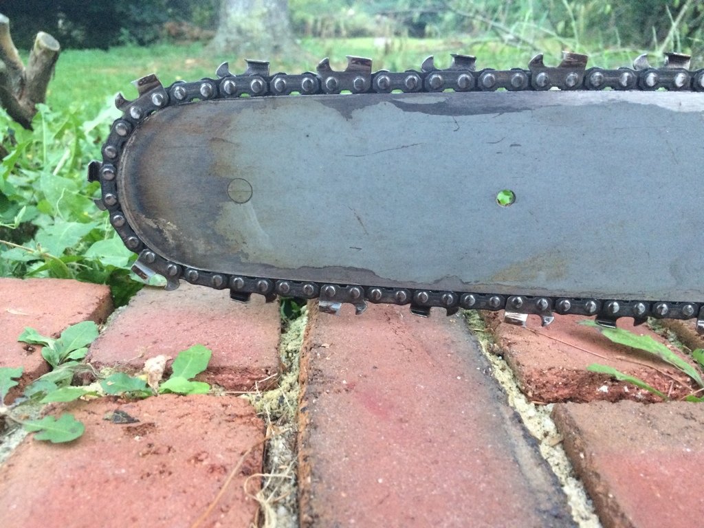

    Been running my saw for the first time (for more than one or two cuts) today and the blade started smoking. Now I know before it got sent to my house mom let someone use it while they were doing some work at our house and they burnt the tip of the bar a bit, but it would still cut fine for me.
    I've got bar oil in it, I do not know when the last time the bar was replaced but the blade was replaced before I got it.
    Anyone know how I can get it to quit smoking?
    This is also the first time I've actually ran this saw or any larger saw for any length of time, I've been running a smaller husqvarna with about a 16 inch bar so this saw was a bit more than I was used to but worked great for me lol

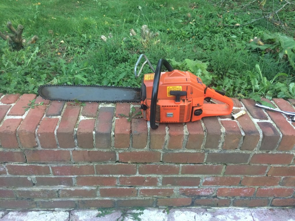

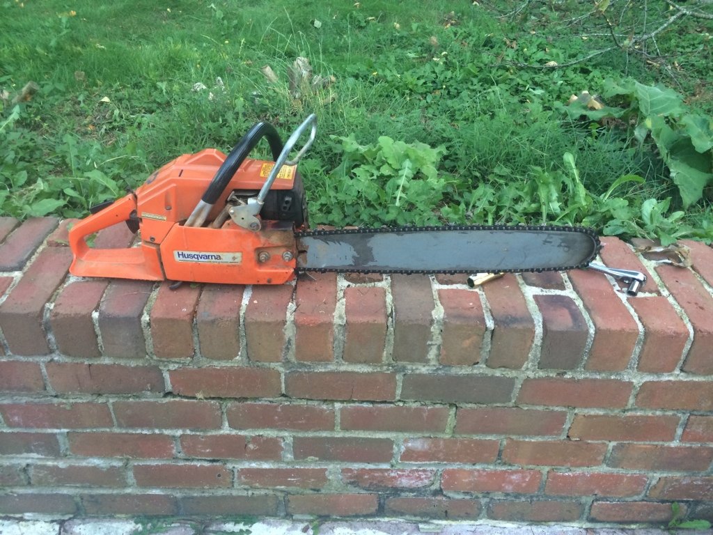

    Oh, the saw is a Husqvarna 266xp with I think a 20 inch bar. I got it from mom when I got my own house, it was dads before he passed. All I really know about it is that it is a horse of a sawit on what I could tell using it
    And pictures of said saw

    Is the roller tip lubricated

    Not a clue, is the bar oil used for the roller tip or do I need to use grease or something
    I know there is bar oil but that is it, for all I know something is clogged. I know how my weed eater runs and can usually diagnose problems, the chainsaw is something I know very little to nothing about

    The tip looks burnt like the roller has overheated

    I'm pretty sure it has been burnt, (by some idiot who used it on our property when working on something for us). It was out of bar oil I think. Do I need a new bar? I can do that if need be

    Can you rotate the chain freely by hand ?

    With it tensioned how I believe it is supposed to be (watching videos and what not to try and learn), I can not rotate it, I might be able to with gloves on but even then it wouldn't be easy. It was rather loose before I tightened it (teeth out of the groove in bar when sitting on ground without pulling ) I could move it.
    How hard is it to replace the bar?
