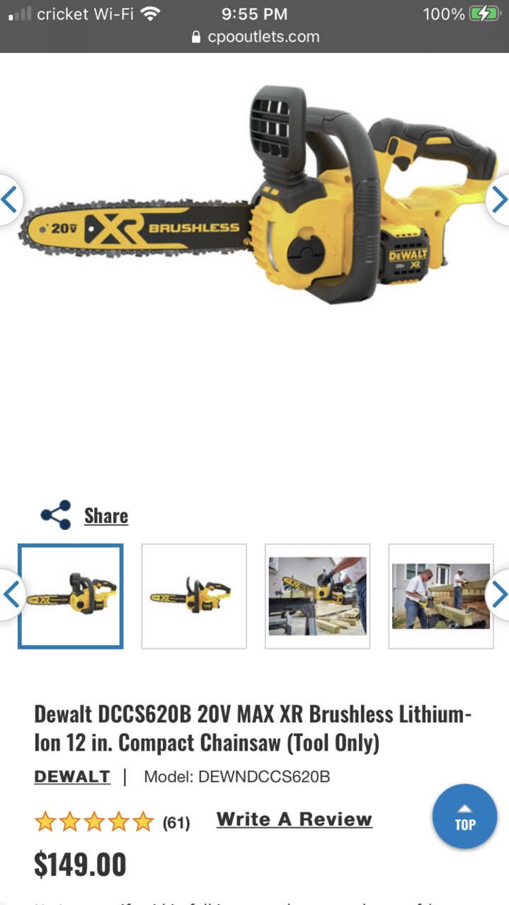

    Ordered. I will put it to use, and report back, I recently bought some property in South Texas, lots of Huisache, Mesquite and Hackberry

    Sweet! I remember it being 99.00 Black Friday :-/

    yup,
    I got 4 of the 5.0ah batteries on BF, it is what it is though.
