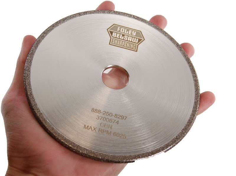

    I use a CBN wheel on the Oregon 511AX, best wheel I've ever used; not cheap but worth every penny

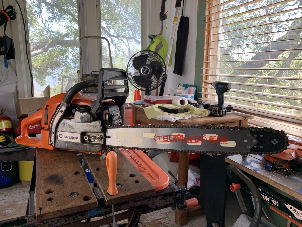

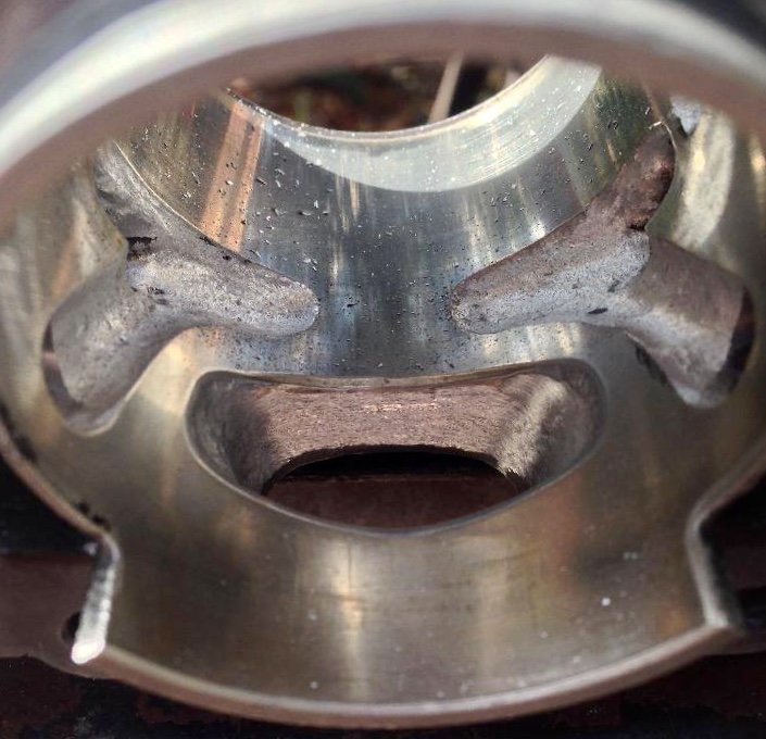

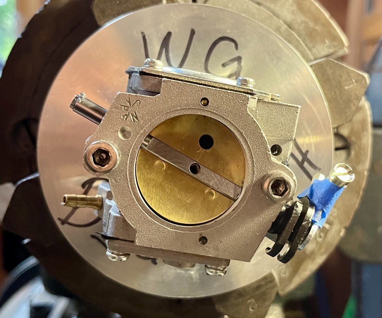

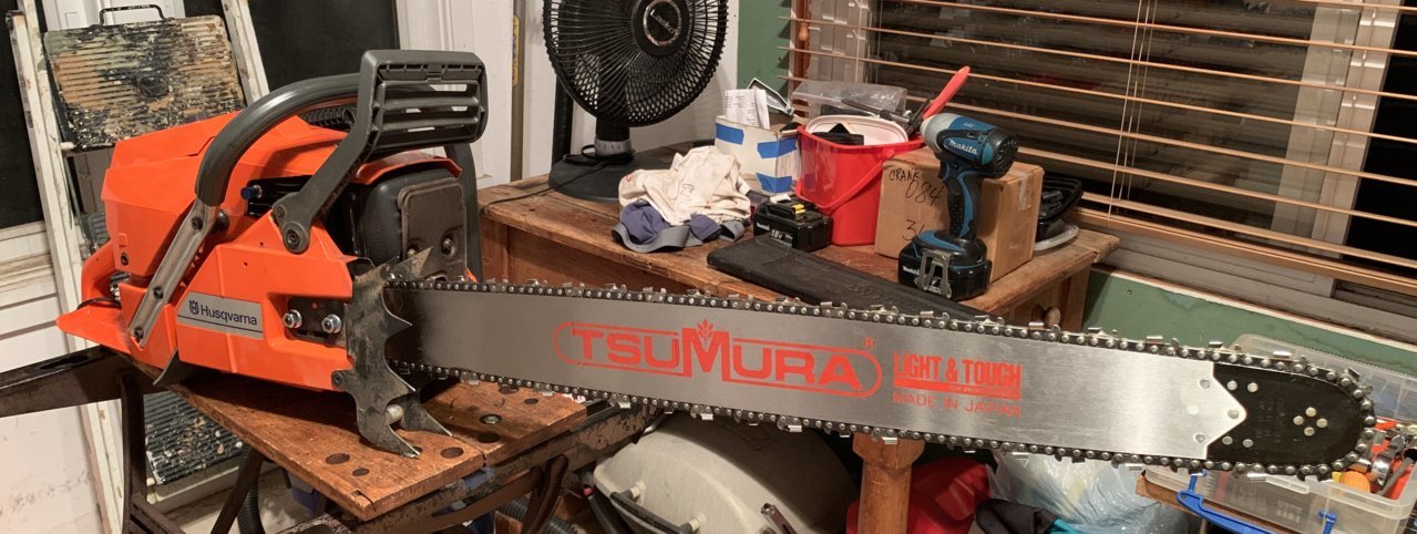

    I forgot I was a part of this thread!!! More chainsaw porn.

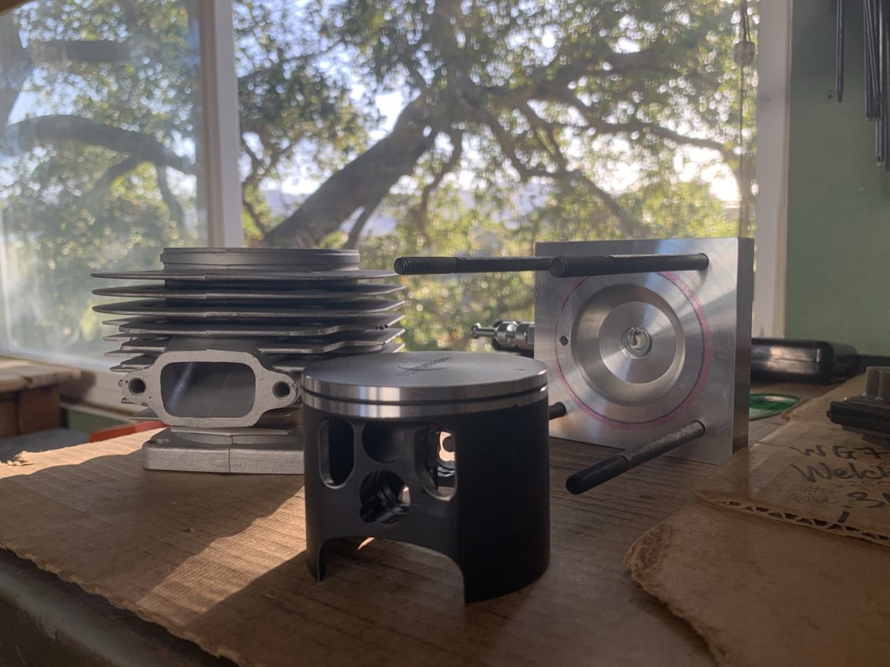

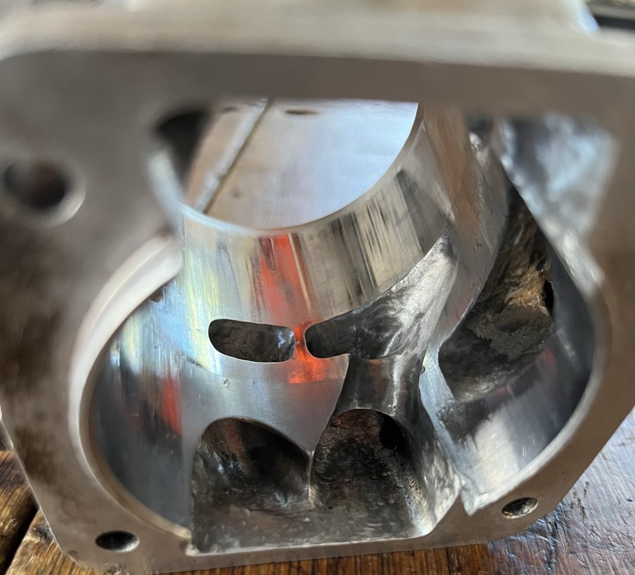

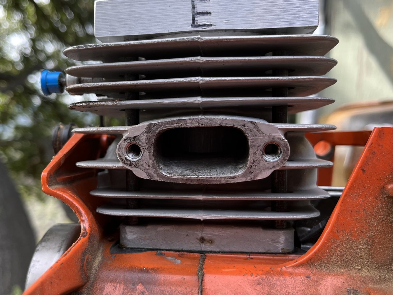

    Bottom photo is a 090 cylinder coupled with a 45mm stroke 154cc motor.

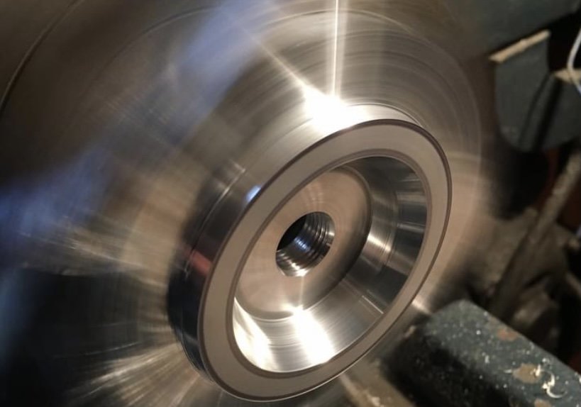

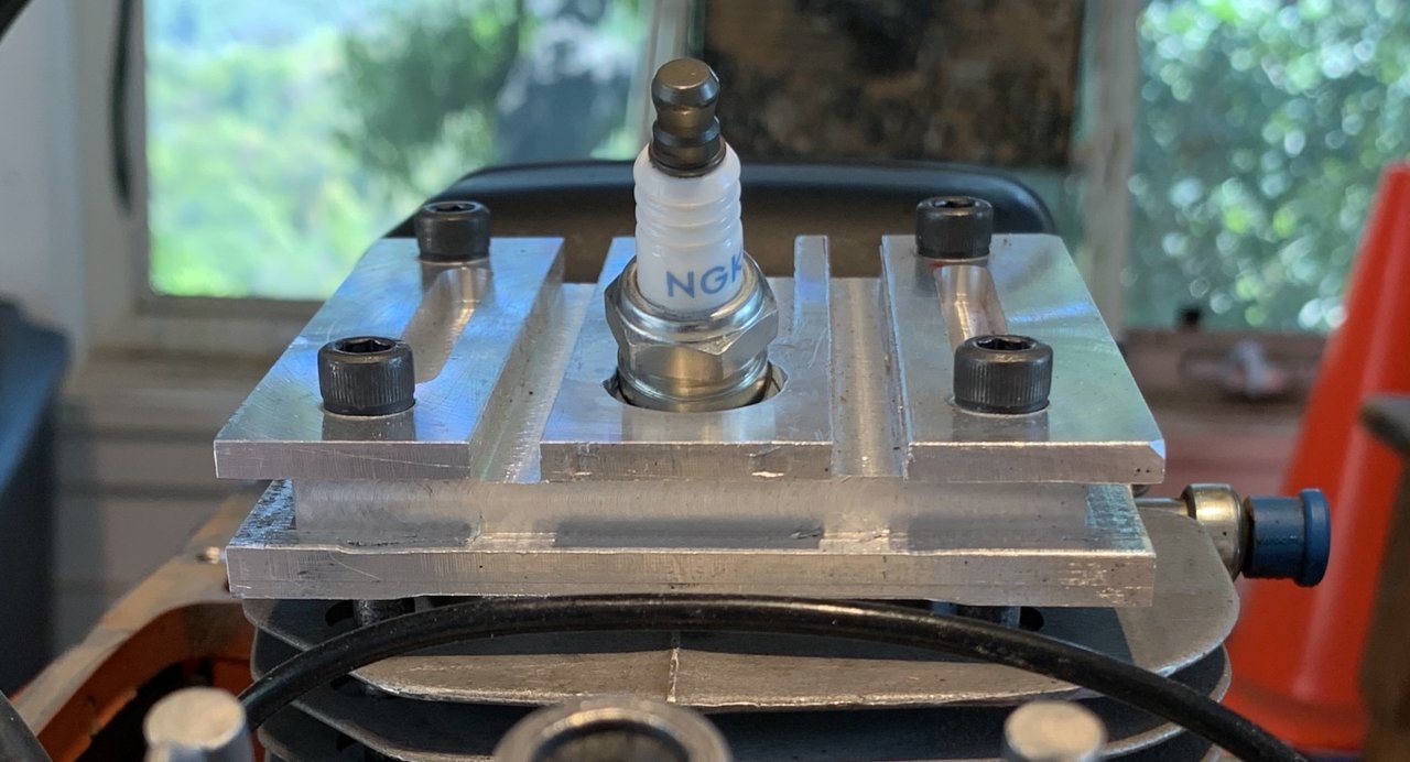

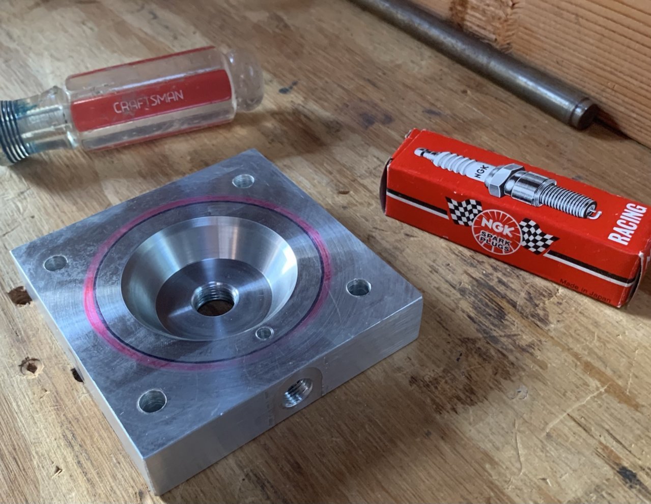

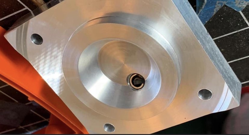

    2 piece heads allow you more flexibility with compression and port numbers.

    My 3120FP worksaw has a two piece head. No o’ring on the cylinder head.

    that is some creative cylinder machining. :thumbsup:

    Thank you. Self taught.
    I’m also proud of those Finger Ports. I introduced that style years ago and am blown away how many times I see it nowadays from other porters.
